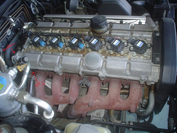

I have a 1994 VOLVO 960 with 122,000 miles on it. It has not been driven too much lately. It is a 6 cylinder engine, type designation “B 6304 S”

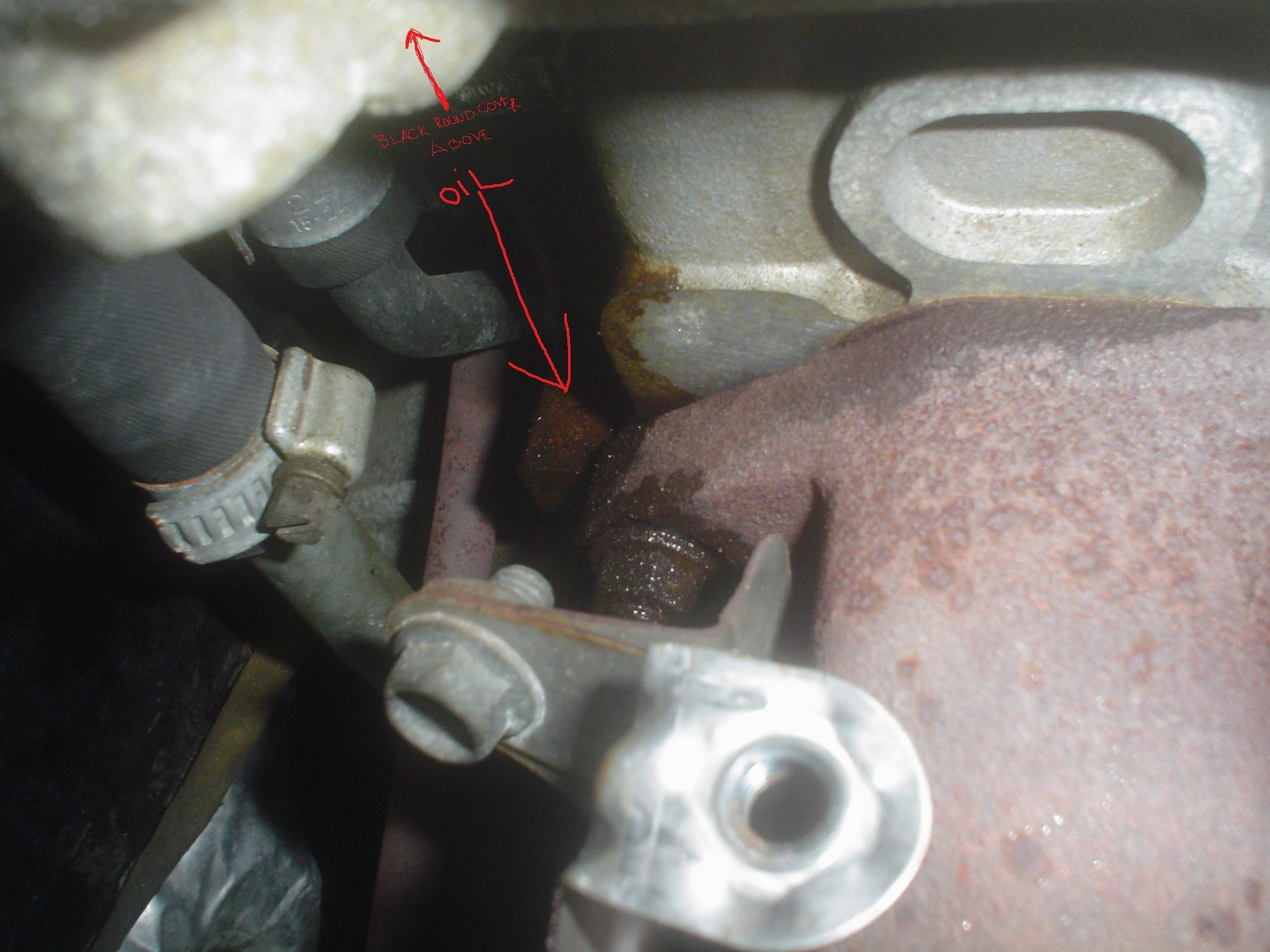

After been parked in the garage, I decided to star driving it again (I was overseas for 3 months). I drove it without any problems the first few days, when I discovered oil in the garage floor. I started looking for oil leaks from the obvious places in the car. No oil from the pan underneath, neither from the oil filter area.
After a more detailed inspection, I found oil in the back of the engine, under a round black plastic piece, and running down to the floor.
“SEE ATTACHED PICTURES

At first, and after doing a search on the web, I thought the leak was coming from the back of the engine from a leaky valve cover gasket, but, I understand that these cars do not use gasket, but instead are sealed with a very special type of sealant.
I was unaware of that, I started dismantling the top of the engine, in order to lift the valve cover, and replace the “alleged gasket”

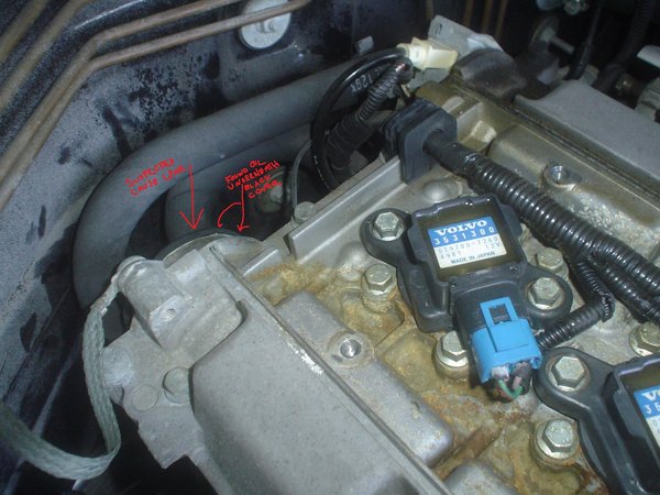

“SEE PICTURE AFTER REMOVAL OF ITEMS”
ancillary items, I could not budge the valve cover, coming to the conclusion, that most likely this car do not have a cover gasket, but instead could have been sealed with a particular type o sealer.
Therefore after my first attempt with the valve cover gasket, I decided to continue searching for other places where the oil leak could come from.

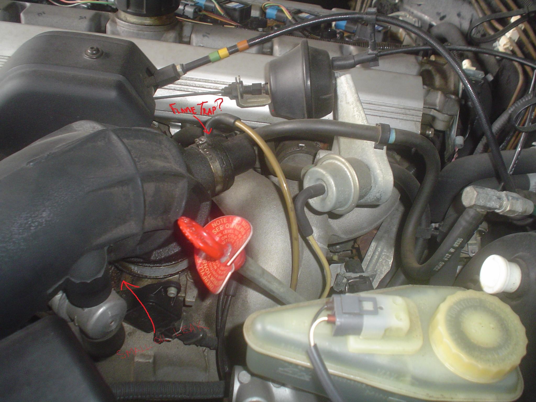

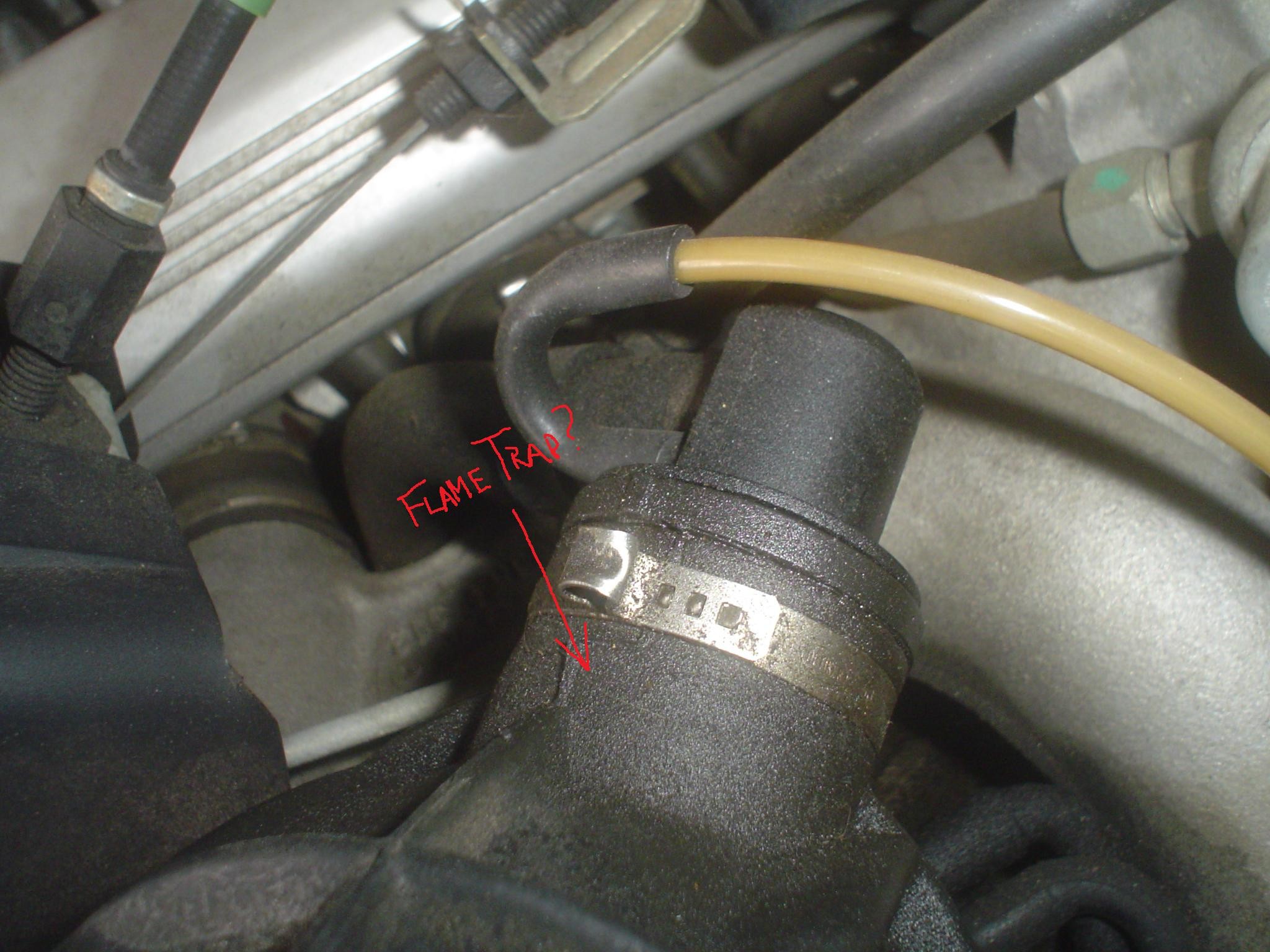

I read some posting from people with similar type of problems like mine, and they talk about another possible leak problem caused by a plugged up PCV valve, that in these type of cars are known as “Flame trap” arrestors.
I took a closer look at my car, and I found, what I think it is the Flame trap arrestor located at one end of the air intake. I found a small amount of oil, at the bottom of the hose.
(SEE PICTURES ATTACHED)
Therefore, I would like to know what you guys think about this semi-challenging mystery, and tell me how to proceed next.

The item on back of head is the cam position sensor. THe cover carries the sensor and below it is a shutter wheel piece that works with the sensor and is bolted with one bolt to camshaft end.
The seal is behind the shutter wheel.

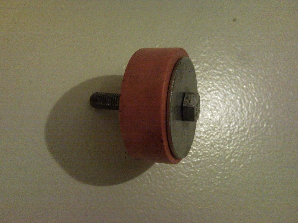

The seal can be removed with a screwdriver but the installation of the seal with the firewall in the way will require an installation tool. The tool will use a bolt and a big washer and a correctly sized sleeve to push the seal into place evenly.
You have Identified the flame trap and you might try cleaning it, the fitting it inserts in to, and all vacuum hose nipples and the vacuum line itself. Also replace the connector pieces of hose but not all hose will work.Some grades of rubber hose that size are comaptible with washer fluid but not oil and fuel vapors. Often the hose kept on the shelf at auto stores that will work is a braided layered hose that is labelled "fuel". Do the flame trap service first as pressure in the crankcase may be making the seal leak and it might (cross fingers, knock on simulated automotive woodgrain) stop the seal leak.

If the flame trap fix fails to cure the leak, you can then assume the rear cam seal(s) are leaking.

In my opinion I wouldn't tackle the rear cam seals (there are two of them) without a cam seal fitting tool. It is almost impossible to refit them without one of these as below. Also it is VERY difficult to remove them without splitting the top of the engine. Count on two days to get the work done. You may want to look at the front seals as when the cam cover lifts off you might as well do these also.

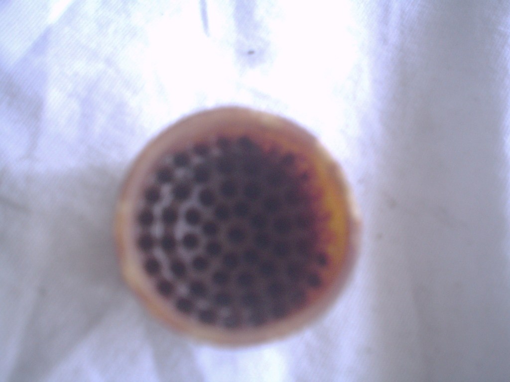

Trap with Filter
Trap with Filter
Trap with Filter.JPG (324.6 KiB) Viewed 5452 times
Filter or Strainer
Filter or Strainer
Filter or Strainer.JPG (87.65 KiB) Viewed 5452 times
I found that the trap,and a small plastic filter or strainer ( photo attached) was full of gunk,and all the little holes on the plastic filter were clogged up with oil gunk. I took everything apart,and cleaned every single hole on the filter,and other parts.

From your initial pic, it also looks as though your oil filler cap gasket might be leaking, a $5.00 part, they do get hard with age and start to leak.
