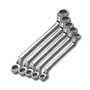

I purchased
(not these exast ones) but offset around 75 degree wrenches. With my leg as additional torque I was able to loosen the old bolts, and take control arm out. The bolts do not have enough room to come out so you leave them in the car. When tightening you are not able to get a torque wrench in there so again I used my trusty leg which I'm sure got over 100Ib'ft of torque to those bolts.I just didn't want to remove the tranny pan and have to re-seal it, since its nice and dry now and fluid inside is clean. I also have a press so I popped in new bushings myself (watch the order they go out, because control arm is tapered)
