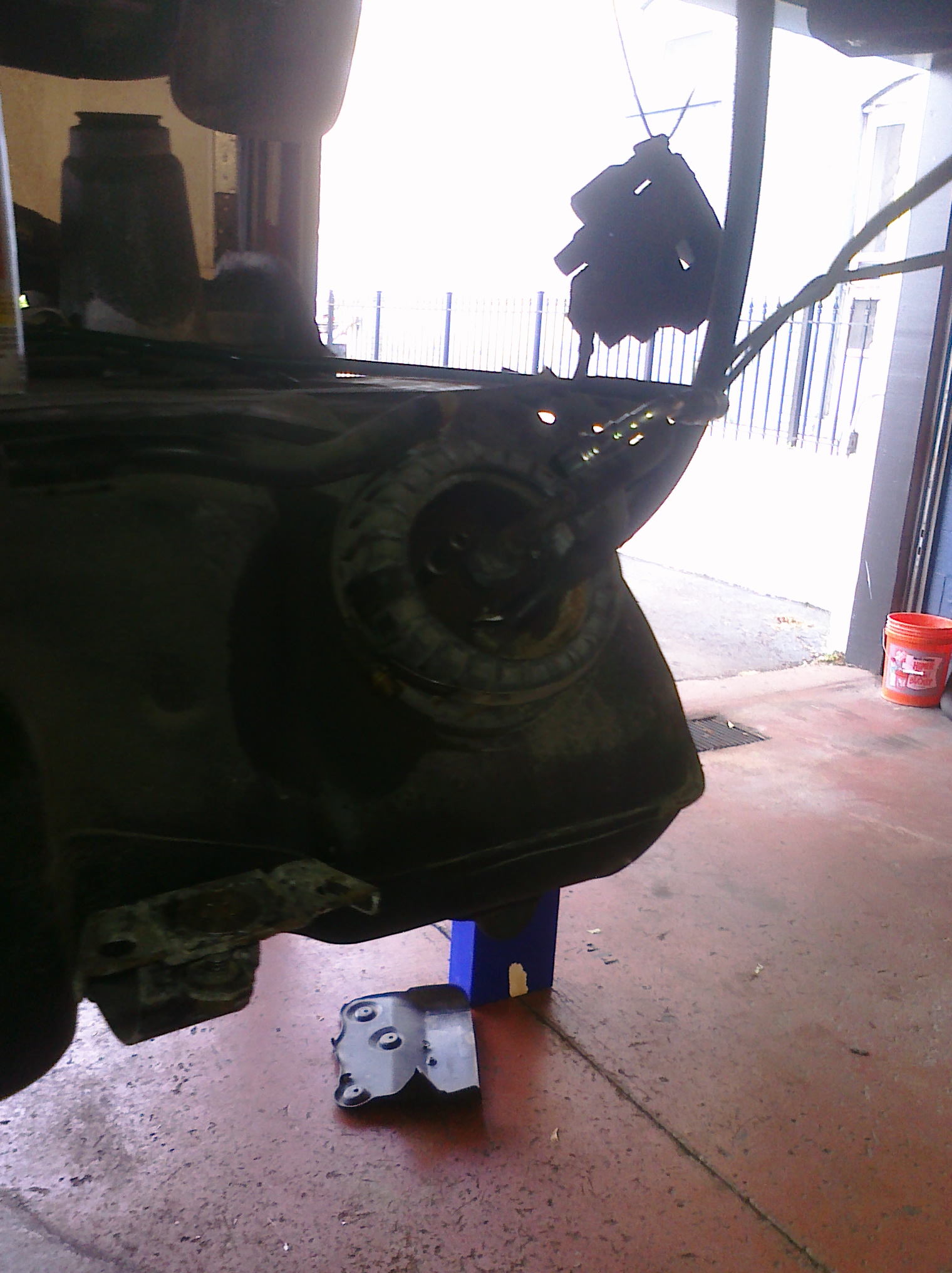

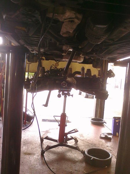

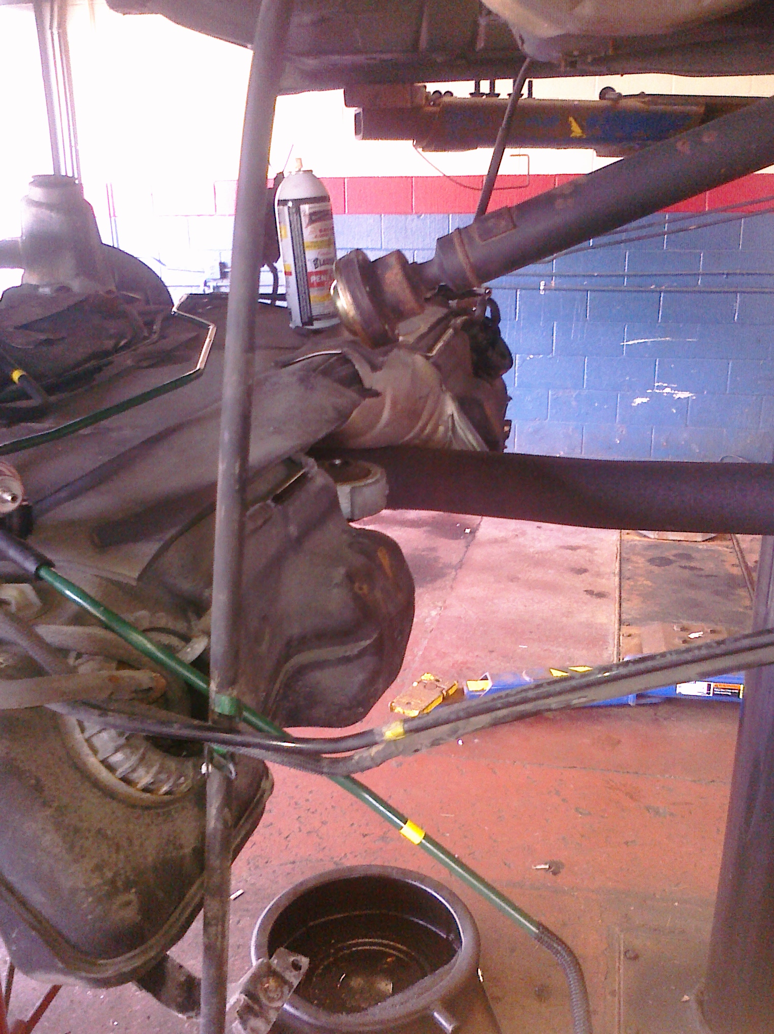

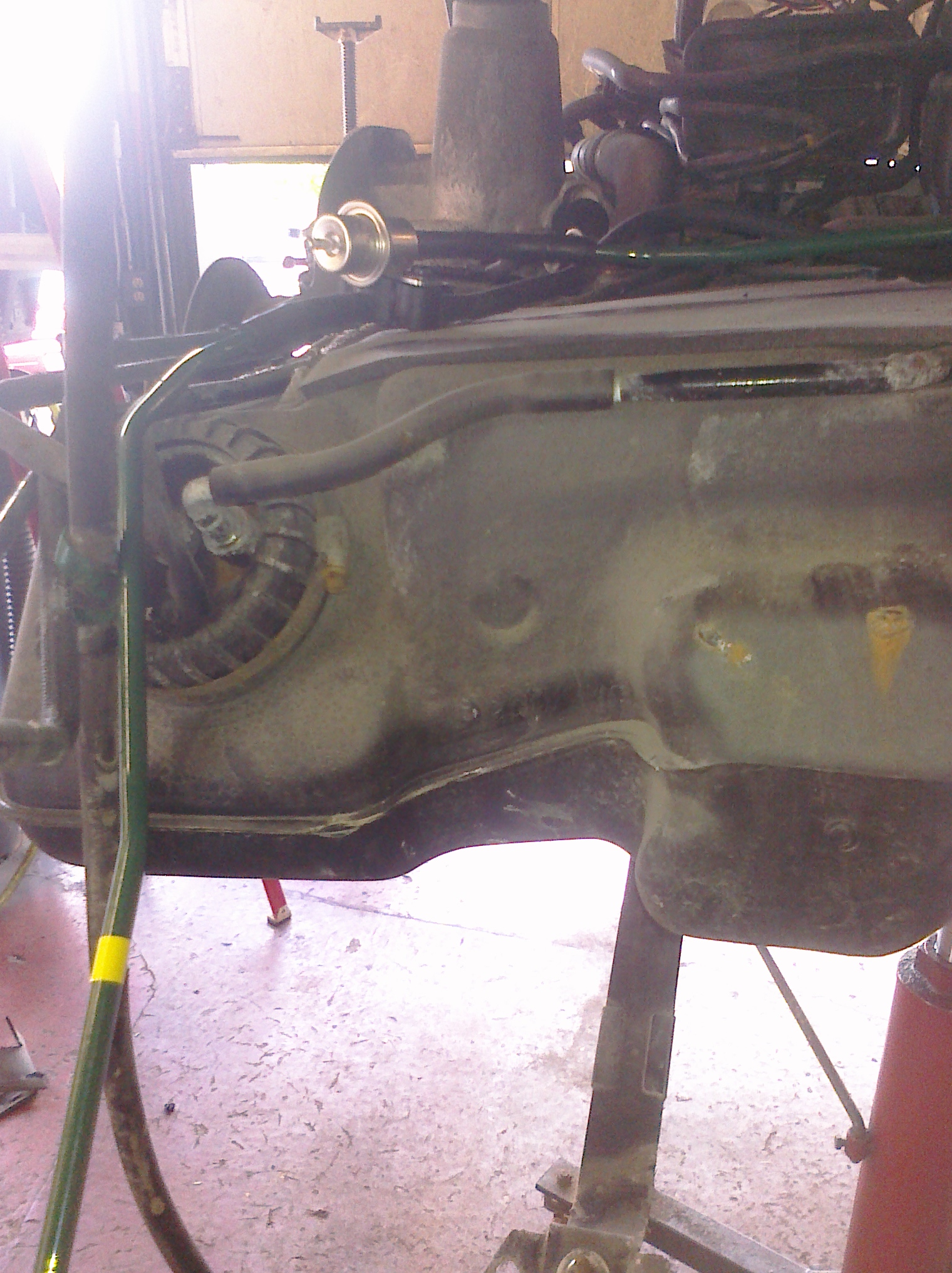

I took my 2000 XC 70 in to my mechanic to get the fuel pump fuel pressure regulator replaced. I had the car diagnosed at a Volvo dealership and I bought the parts there, but I just don't want to give them $2200 to actually do the job so I am having my local mechanic do the work. Anyway, my mechanic asked me if I knew that I had 2 fuel pumps. I had no clue. I guess if the dealership where I bought the parts knew that, they would be happy to sell me another pump so...why 2 pumps?
Is it a primary/secondary thing?
Here are some pictures I took while it was on the lift.
Why do I have 2 fuel pumps? 2000 XC 70

And two pump/sending units? Well, the tank saddles the rear drive shaft...
This leaves you with two low compartments in the tank, hence, dual fuel
pumps and sending units. Looks like this:

I took some time to look at your cars diagrams in VADIS. My answer before was a bit too generic. In the case of a 2000 V70XC you only have one pump. It is separate from the sender unit on the other side of the tank. The sender unit also has a hose that allows the pump to draw fuel from that side of the tank as well. I will post the parts diagram/parts list and the removal procedure.
