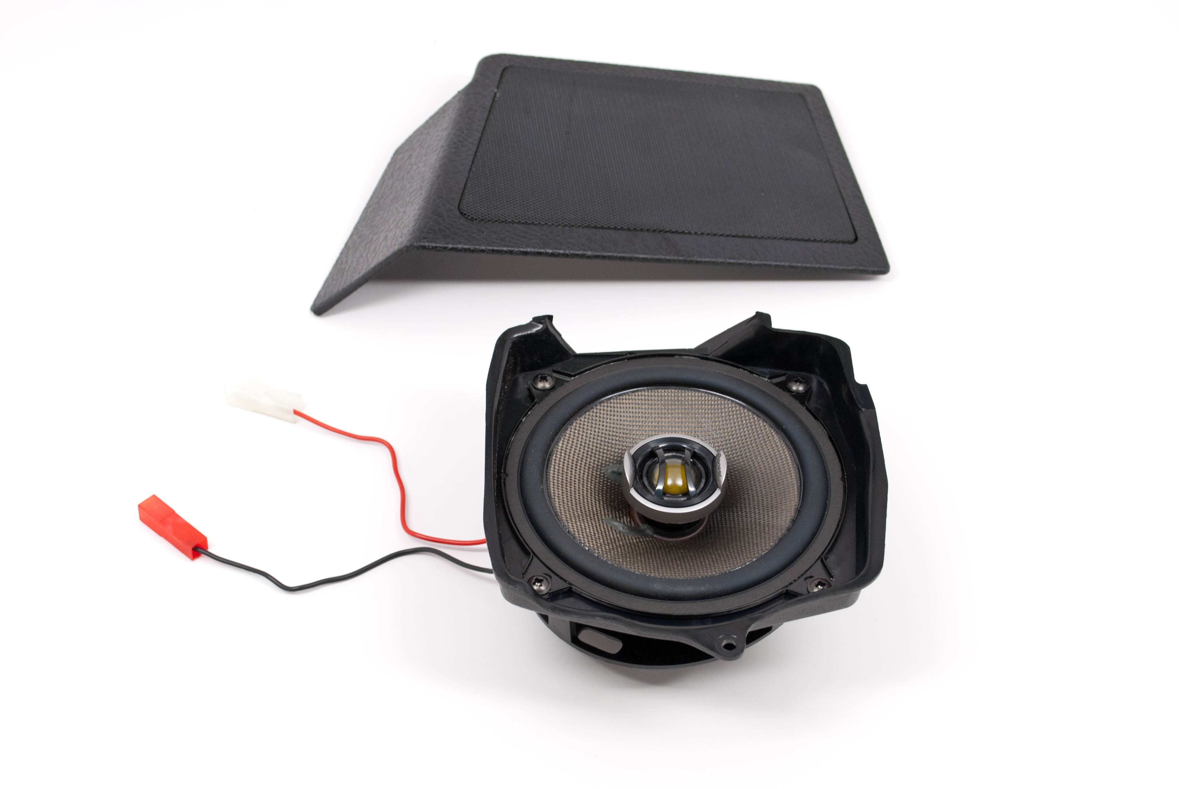

Finally got first pictures, though we took them out of the car. Thanks to FCP Groton for the photography.
Attempting 850 speaker replacement.
Attempting 850 Speaker Replacement

The rear adapter bracket is a separate product, SAK-3205. It's a simple ring that replaces that factory "bucket".
Note about removing the OE front speakers:
* The forward-lower speaker screw needs to be removed as well as the two outer screws.
* The bucket comes out by gently prying the upper rearward corner, tilting inward, and then lifting upward - the bottom edge is a groove that the door foam fits into, so you don't want to just yank it.
Note about installing the new ones:
* Secure the speaker using all four screws that came with the bracket. Tighten firmly but don't let them strip. Don't use those little tab clip things, they'll cause an air gap and a rattle, just let the plastic bracket bear screw directly. Speakers need a good air seal just like a manifold gasket does, and for similar reasons.
* It has no grooves or tabs on the outer edge, it just pressure-fits before screwing it down. You'll be tempted to use those outer screws to "pull" the bracket into the door. Don't, it'll rattle.
The new one press-fits using the same movement pattern as the OE, just there aren't any tabs or grooves to hold it there, which you'll realize is a benefit. Settle the lower-forward corner first, firmly, then press the upper-rear corner into place. It won't quite be fully bottomed at the screw points. Use the two OE outer screws.

Here's a link to the SAK-3205 rear adapter plate:
Note it probably isn't thick enough to just screw into the plastic. It will be necessary to mate the speakers to the bracket outside the car, by holding those tab-clips entirely behind the ring - don't slip it onto the ring, unless you're also going to put a rubber gasket between it and the speaker.
