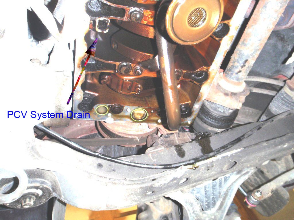

The lower one takes a turn straight down into the oil pan. I just scraped at it a bit with a knife - there wasn't a whole lot of crud in mine; carb cleaner might work for ya.
oil pan.JPG (490.99 KiB) Viewed 2333 times

jblackburn wrote:
Ok so I am trying to ensure the PVC drain is actually clear. I can barely get a thin wire though the hole. How can I be sure it is clear. What size hole should there be? Does anyone have a view of the hole from the front of the engine?

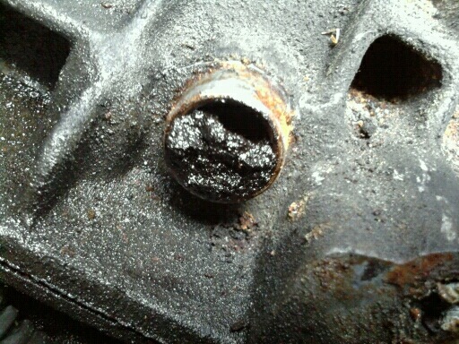

This is what it should not look like. I scraped the chunks out with a small screwdriver.

Mine is clean as far as I can reach my finger in (nothing like that picture) I am just wondering how big a hole it is between that hole an the other pic that jblackburn posted?
What have people been using to ensure that passage is clean? How big of a passage is it?

Very small. It goes straight back to the engine block and takes an immediate right-angle turn. The passage is probably not much thicker than your car key.
I used a pocketknife to scrape it all out. And a bendy fish tank cleaner brush thing (for canister filter tubes) for the other ports.

that is probably whats causing the smoke in the picture! nasty!!! does it smell like crank case at idle?
