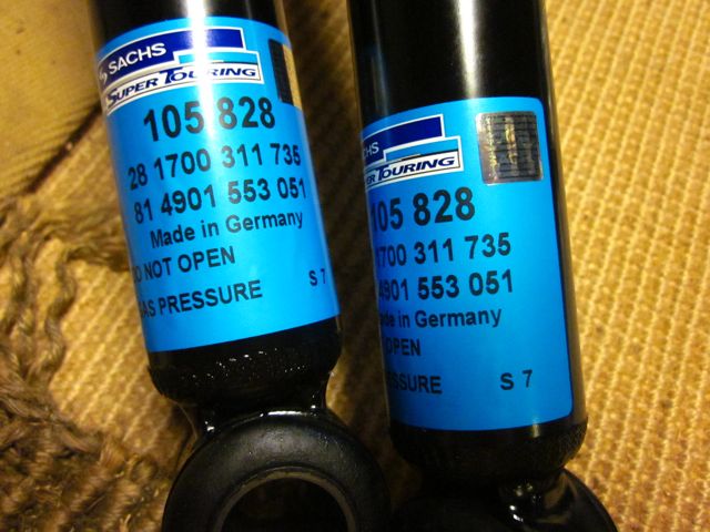

Parts used: I used Sachs shocks and Hutchinson mounts (the OEM manufacturers for these parts). The shocks also came with new top nut and washer, and new bottom nut (but not a new bottom washer -- you can clean this up and re-use it). The shocks were made in Germany (Sachs part number 105 828). The mounts were made in Poland (Hutchinson part number 538124, Volvo part number 9461524).

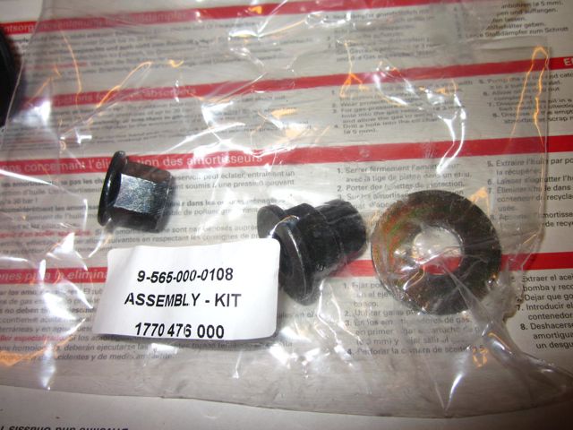

*Picture of shock assembly kit

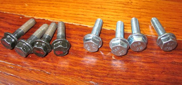

Due to the rust you will likely find on the upper mounting bolt threads, I would also recommend buying four new upper mount bolts in advance. I did not buy these in advance but should have. These bolts are flanged M8 x 1.25 (coarse thread) x 30mm long. The tensile strength grade was 8.8 on the original nuts with a black oxide finish. I replaced the original bolts with M8 x 1.25 x 30mm grade 10.9 flanged stainless steel bolts, which were the closest I could find. Several car parts stores nearby (NAPA, Carquest) did not have anything close in stock, but I located the grade 10.9's at the nearby Ace Hardware, which was pretty well stocked. The bolts cost $1.20/each. Both the new and old bolts have an 8mm diameter thread, but the original bolts had a 12mm hexhead and the new bolts had a 13mm hexhead.
*Picture of original (left) and new (right) bolts

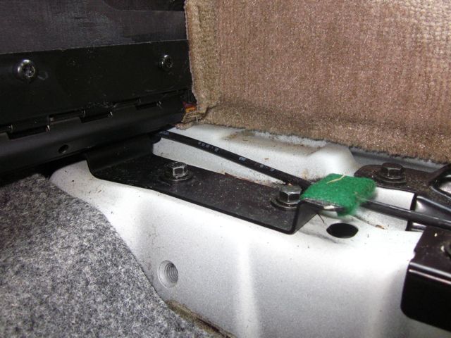

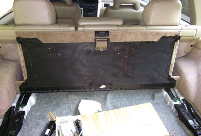

The first step in the job is to remove the back decking in the wagon. The front deck lifts up and out, and the side decks snap out of their holding clips, revealing four bolts that can be removed with a 10mm socket and ratchet. Once these are out, lift up and remove the back deck while turning slightly to avoid hitting the trim around the wagon gate.
*Picture of rear deck
*Picture of rear deck bolts

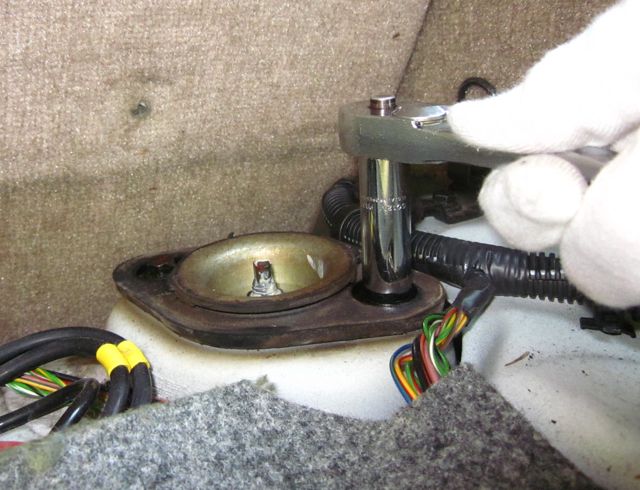

With the deck out of the way you can see the shock mounts. There are three bolts visible on each mount. The center bolt is attached to the shock rod, and if you are replacing the mounts as well as the shocks, you will never need to touch these. The two bolts at the corners of the mounts need to be removed, and they are tricky because the threaded bottom of these bolts are exposed in the wheel well and get very rusty over the years.
*Picture of wrench on rear mount bolt

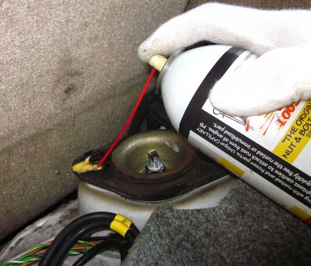

The method that cn90 described worked well for me: use repeated blasts of penetrating oil while turning slowly and occasionally tightening back up a turn and applying more penetrating oil when I felt building resistance. I am grateful to cn90 -- he helped me avoid shearing any bolts!
*Picture of squirting penetrating oil

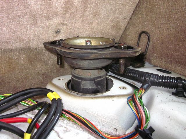

The bolt removal takes a while due to the rust and because the bolts are 30mm long, so there is a lot of thread to unwind. After you loosen the bolts, the shock mount will rise up off of the attachment point on the car body.
*Picture of mount lifted off of body, rusty bolts visible

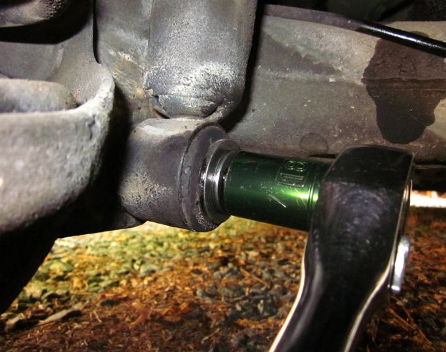

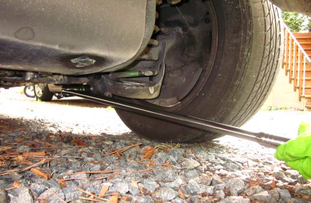

Now, you are ready to loosen the bottom mounting nuts. I applied penetrating oil to these nuts too, and then loosened them with an 18mm socket attached to a long breaker bar.
*Picture of breaker bar cracking off the torque on the bottom shock nut

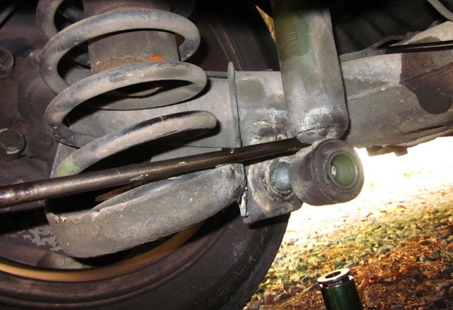

With the nuts off, I used a long screwdriver to pry the shock off of the stud.
*Picture of screwdriver being used as a prybar popping off the shock

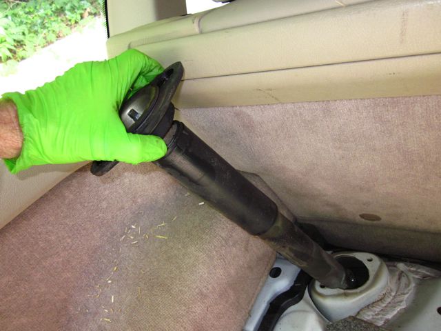

Then, you go back inside the wagon and lift the shock and mount up and out of the car.
Old shock and mount being lifted out of car.

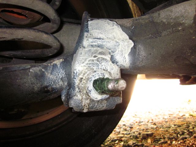

The next step is to clean up the mounting stud. I used a wire brush to remove residual paint flakes, dirt and corrosion from the stud.
Mounting stud (pre cleaning)
Then I applied a thin layer of white lithium grease to the trailing arm that the stud is attached to, and some wheel bearing grease to the stud itself.
Stud after cleaning and greasing
The stud is now ready to receive the new shock absorber.

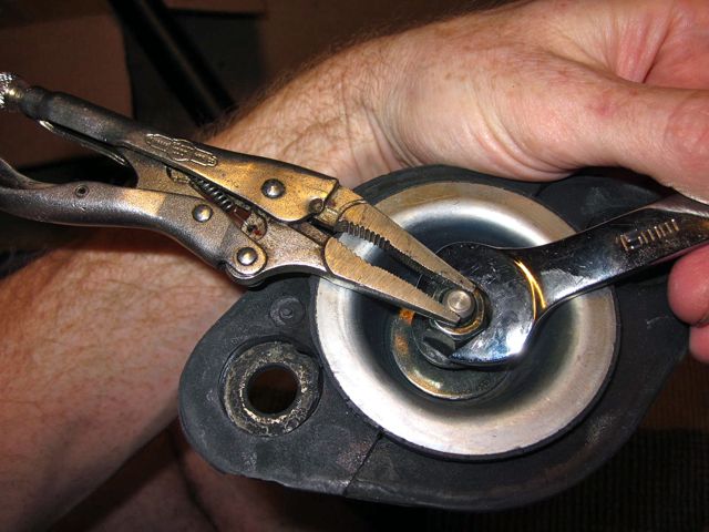

To get the new shock absorbers ready for installation, you need to attach the shock rod to the mount. It's easiest to do this ahead of time and doesn't need to be done on the car. To attach the shock rod to the mount, put on the washer and then the nut and tighten the nut by hand at first.
New mount with washer, nut and rod just starting to be engaged by the nut

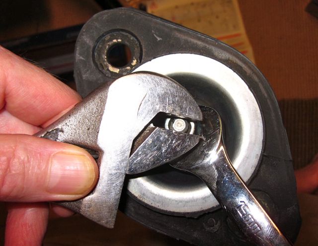

When the nut becomes a little tight, you will be able to hold the flats on the piston rod with needle nose vise grip pliers or something similar so you can continue to tighten.
Vise grip locking pliers holding piston rod while tightening the nut
With further tightening, more of the flat will be exposed and you can replace the vise grips with a large adjustable wrench. The torque specification for this fastener is 29 ft-lbs. I tightened it up until it felt "really tight" because I don't have a torque wrench that fits.
Adjustable wrench and 15mm open end wrench applying tightening torque to shock nut and piston rod
This job would be easier with an offset 15mm wrench to tighten the top nut, but it can also be done with a more common open end 15mm wrench (which is what I had in house). When you're done, the mount and center nut on the shock piston rod should look similar to this:

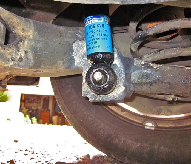

Now the new mounts and shocks can be installed in the car. Insert the shock and mount in the hole from inside the wagon. Then, go underneath the car and lift the shock slightly and slide it onto the stud.
New shock on stud
New shock on stud

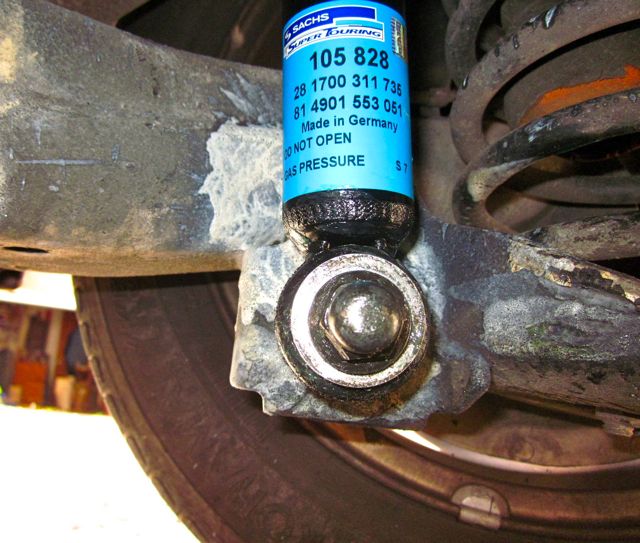

Attach the washer and the new nut on the stud. Leave it a little loose and don't tighten it to final torque for now.
Nut on stud (loosely tightened only)

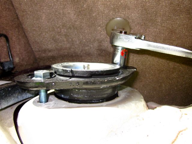

Insert the new mounting bolts in the mount, compress the shock downwards by applying and holding a little force to the top of the mount. Start the mounting bolts until they catch in the threads. Then you can tighten down the bolts with a ratchet.
Mount being attached to car with new mounting bolts.

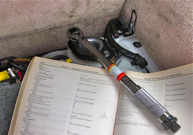

Use a torque wrench to tighten up the mounting bolts to 18 ft-lbs. I did this in stages because I found that the rubber on the mounts compressed a little each time I tightened up a bolt.
Torquing the upper mounting nuts to 18 ft-lbs.

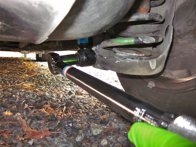

Then, underneath the car you use a torque wrench to tighten the 18mm bottom nut to 59 ft-lbs.
Torquing the lower nut to 59 ft-lbs.
Torquing the lower nut was somewhat difficult because of the force required and the amount of clearance under the car is limited. It's very helpful to have a long ratcheting torque wrench for this step.

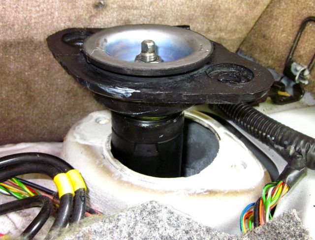

At the end, the upper mount should look like the picture below. It might be a good idea to bounce the car a couple of times and then recheck the torque on the mounting bolts.
Completed upper mount

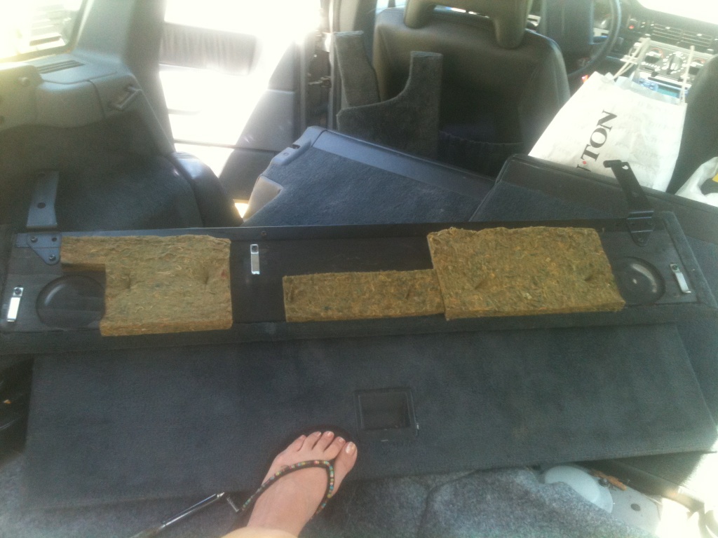

Thanks for the write up and many helpful pics you added! And yes, even with yours and cn90's warnings, I sheared a top bolt. And then when I was hammering the bolt retractor in the pilot hole, the nut fell off the car! I fortunately did not have a rust issue on my 149K, 16 year old 850 GTL Wagon thanks to it's first 134K being in New Hampshire where they do not use salt on the roads like we do here in the Buffalo, New York area! It was almost a sin how easily I removed the lower bolts! I messed up by not evenly removing the bolts, which is the reason for this posting. My suggestion to the next repairer is not only to alternate between the two 12mm bolts on each mount, but to alternate between all 4 bolts (both the left & the right shock mount) evenly. Even with my small 120lb frame inside the car, it was still enough uneven stress to bend both bolts on the other side, ultimately shearing one. But if you do find yourself in the same sheared-bolt situation, put the other sides 2 bolts back on in an even position (first cleaning and spraying them with white lithium grease). This helped me get the fourth, un-sheared bolt off easily, even though it was bent.
I also included a picture of the rear, forward decking; I struggled a bit due to not knowing there were 3 retention brackets(pictured). After you remove the four bolts fastening it to the cars frame, slide the decking towards the rear of the wagon til all three brackets are released. Hope it eliminates the frustration like I had for 5 minutes wondering what the heck was going on?!
Picture of 3 retention brackets on rear decking; 3 shiny items in picture
Volvo rear decking.jpg (201.52 KiB) Viewed 11334 times
Thanks also for the tip of not jacking up the car, I also found no need to do this. Everyone follow jreeds suggestion and read cn90's posting as well, both were of great help. His link is found in the beginning of jreeds (this one).

People already noticed that with my DIY, I placed the Rear of the Volvo on jackstands with Rear wheels removed. In retrospect, this was not necessary at all. So hats off to "jreed" for this time-saving tip (i.e., no need to remove rear wheels).
However, I'd add a few little tips:
1. The lower nut 18-mm, some people broke the stud because over time, the nut maybe rusted and frozen in place.
So in the process of undoing the nut, people break the stud!
To prevent breaking the stud, use PB Blaster and some heat (propane torch) on the nut before removing it.
Once the nut is heated, it takes much less force to undo it.

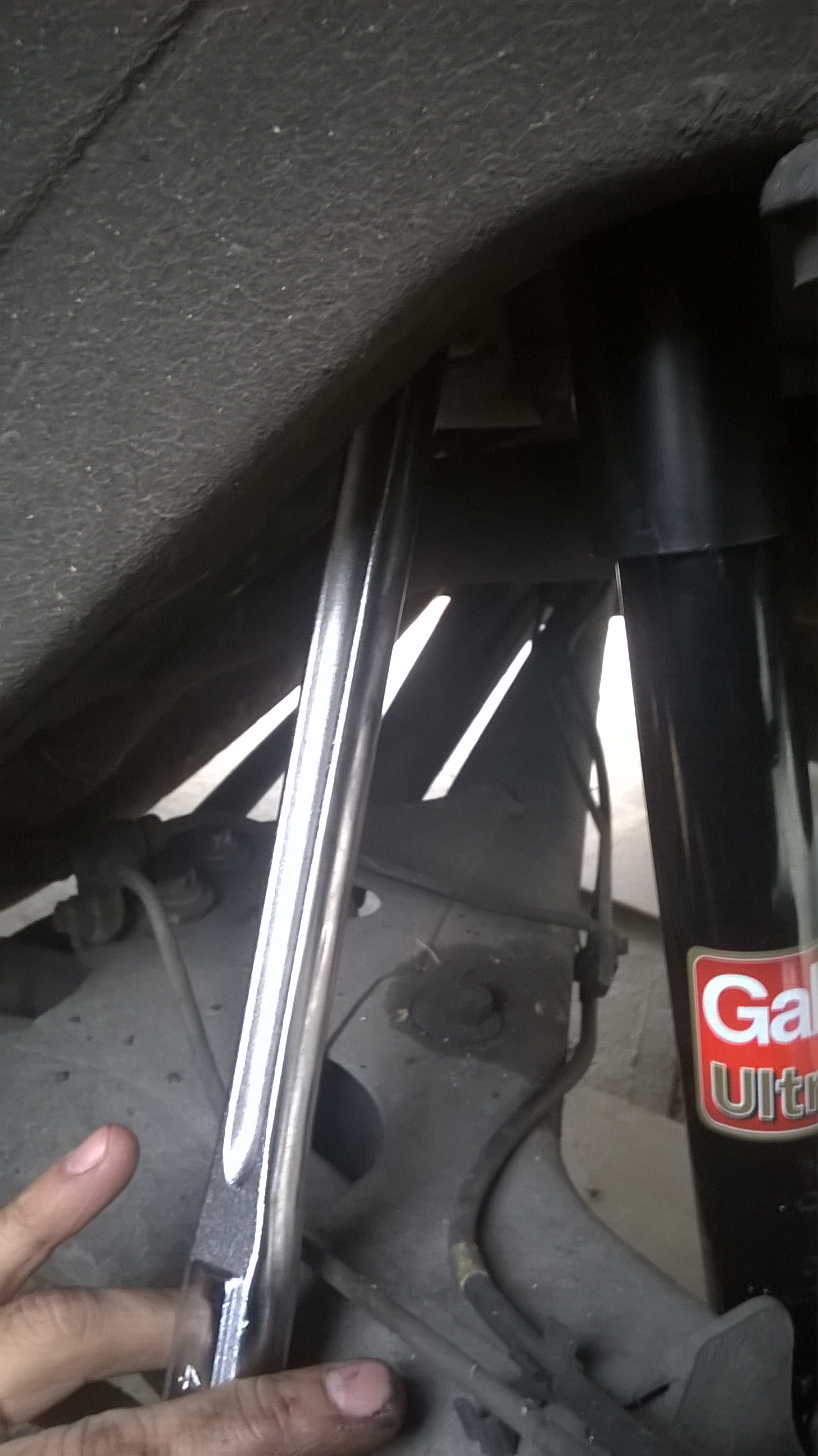

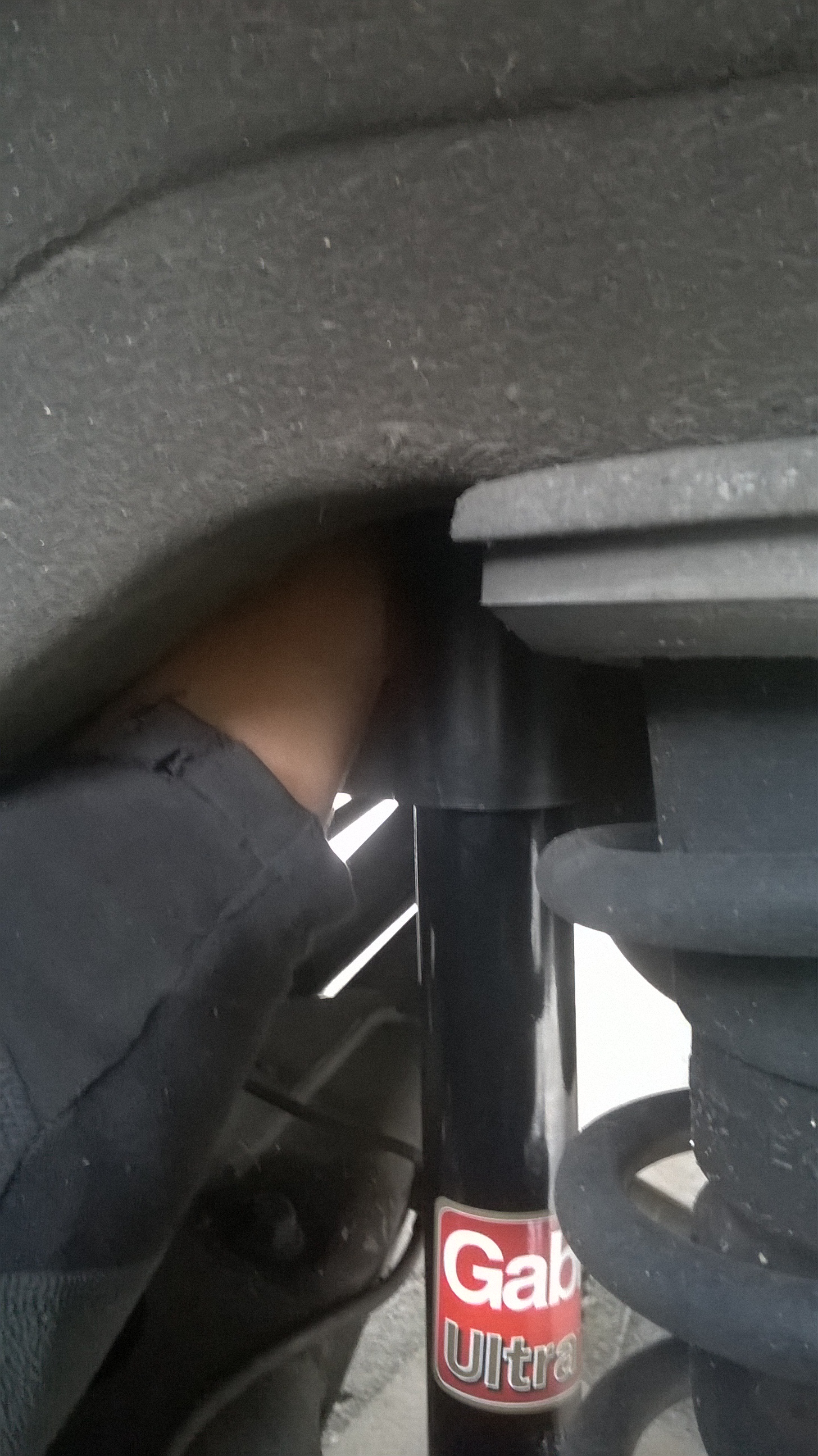

Thanks for this post. It really helped me out this past weekend! I managed to only shear off one bolt! But I knew how to tackle it.
In case anyone is looking for steps to follow:
- Take wheel off.
- Stick your hand in there with a nut in hand, fish around for the bolt and thread it on.
- Then take a long flex-head ratchet and deep socket to it and tighten, while someone from the top holds it in place.
- Hold nut in place while someone torques the bolt from on top.

Those rear mounts are weird, I had one that looked good, I couldn't wiggle it but it was making a noise- great write up though- I feel like sending it to the 'Volvo Specialist Shop' that did my car before I bought it- they broke the bottom stud off and welded a nut in its place- new subframe time !@@#
