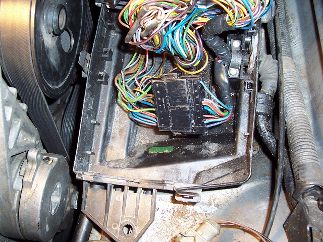

Well, I wasted my money and time purchasing and installing a replacement VSS for my 1996. Since I could not find any continuity between the wires coming from the VSS and the bundle of wires under the airbag I again removed the TCM and ECM and housing. I found that the yellow/brown wire goes to pin 5 of the multipin connector that was under the TCM and ECM main connectors but is not connected to anything on the other side of the connector.
The green/yellow wire goes to pin 6 of the connector and also never comes out.
There's a note on the 1995 wiring diagrams that for 1996 the Yel/Brn goes to TCM Pin A11 and the Grn/Yel goes to TCM Pin A12 so that's why the wires are routed there. Apparantly my vehicle was built before the full implementation. I assume that my vehicle speed signal comes from the ABS and goes to the instrument cluster. Since the speedometer and odometer work that signal and path must be functional. According to the 1995 diagrams a vehicle speed output signal is generated by the microprocessor in the instrument cluster and routed to the speed warning relay, the cruise control module and the ECM. There should also be a signal routed to the radio but my wiring diagrams don't include the radio. There are probably similar paths for the 1996 but I still have to determine them from the wiring diagrams. Then I will attempt to verify the paths on the vehicle. I suspect the VSS fault is due to either a bad speed signal from the instrument cluster or it is not reaching one of the intended destinations.
When I discovered that the VSS output is not used I was aggravated at myself for buying one before actually determining it was bad. But then I was thankful that the fault was not due to a broken trigger tooth inside the transaxle. I believe VADIS identifies the same part number for the VSS and the rpm sensor so now I have a spare.
