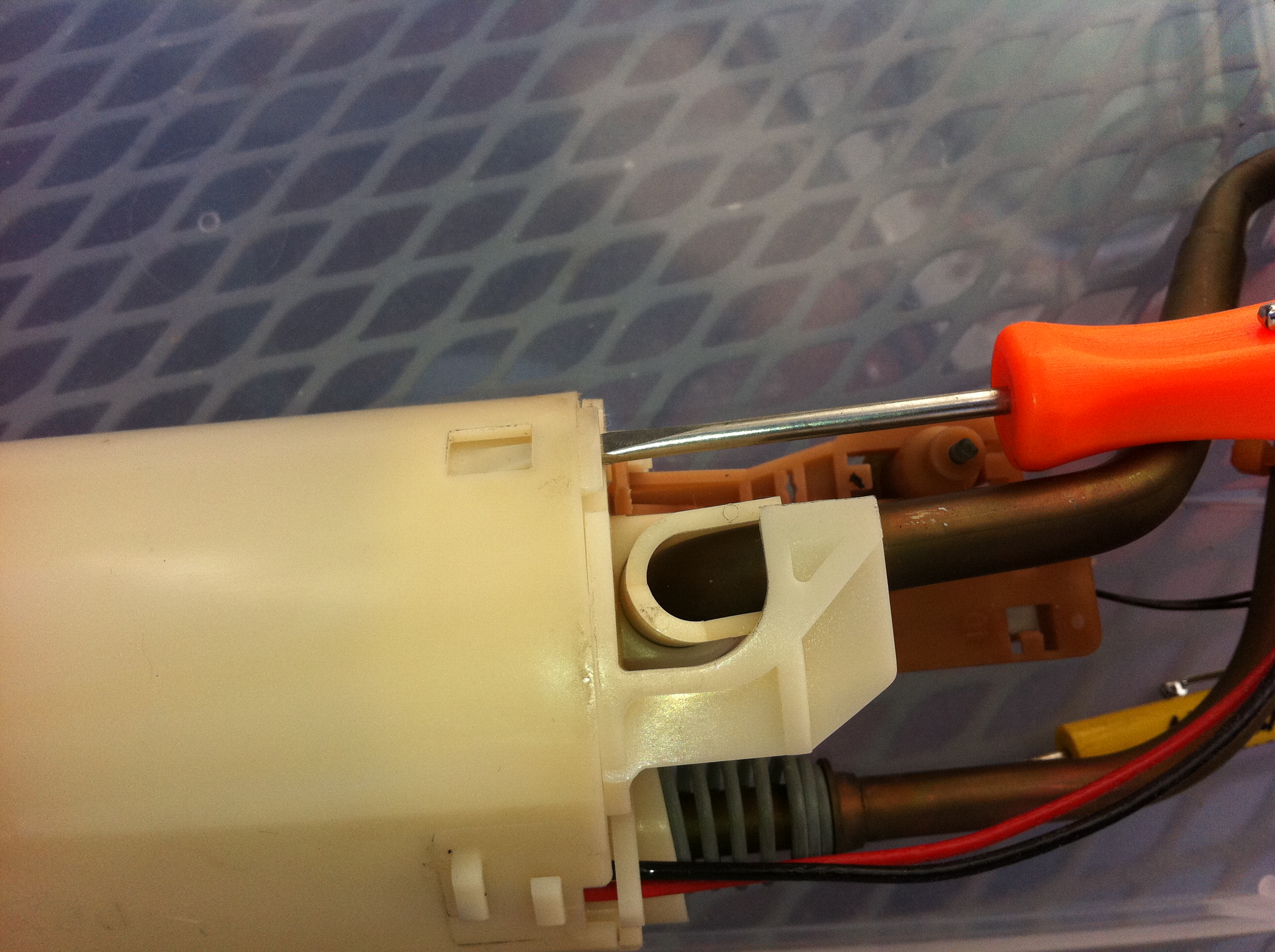

Here's some additional photos of the fuel pump unit dis-assembly once out of the vehicle. Please note that care should be taken when releasing the three tab fasteners on the fuel pump housing. it is very easy to crack and break the plastic housing. I found out the hard way. However I was able to use a 1/4" course tread screw and carefully drilling a 1/16th pilot hole through both plastic pieces of the housing to re-attache and secure it.
Once open, I removed the green connector clip to release the black electrical connector.
Next, I removed the tapered cone fitting directly attached on the outlet of the pump.
Take note of the o-ring and the plastic split ring under the o-ring seal.
Although it is hard to see in the photo, take note of the small rubber grommet which firmly holds the pump in the correct position. I would like to point out that this grommet is not included with the new pump from Highflow.
