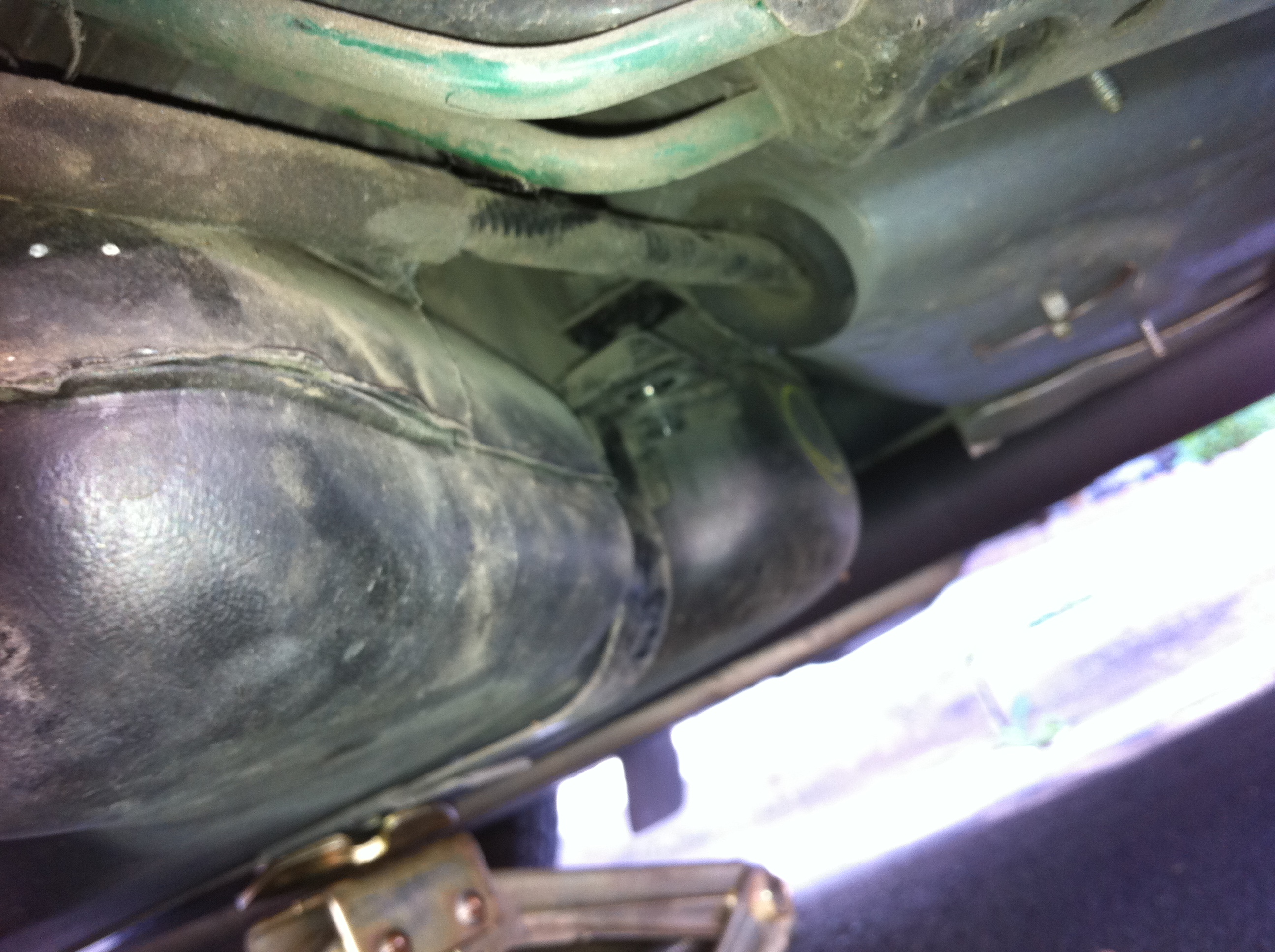

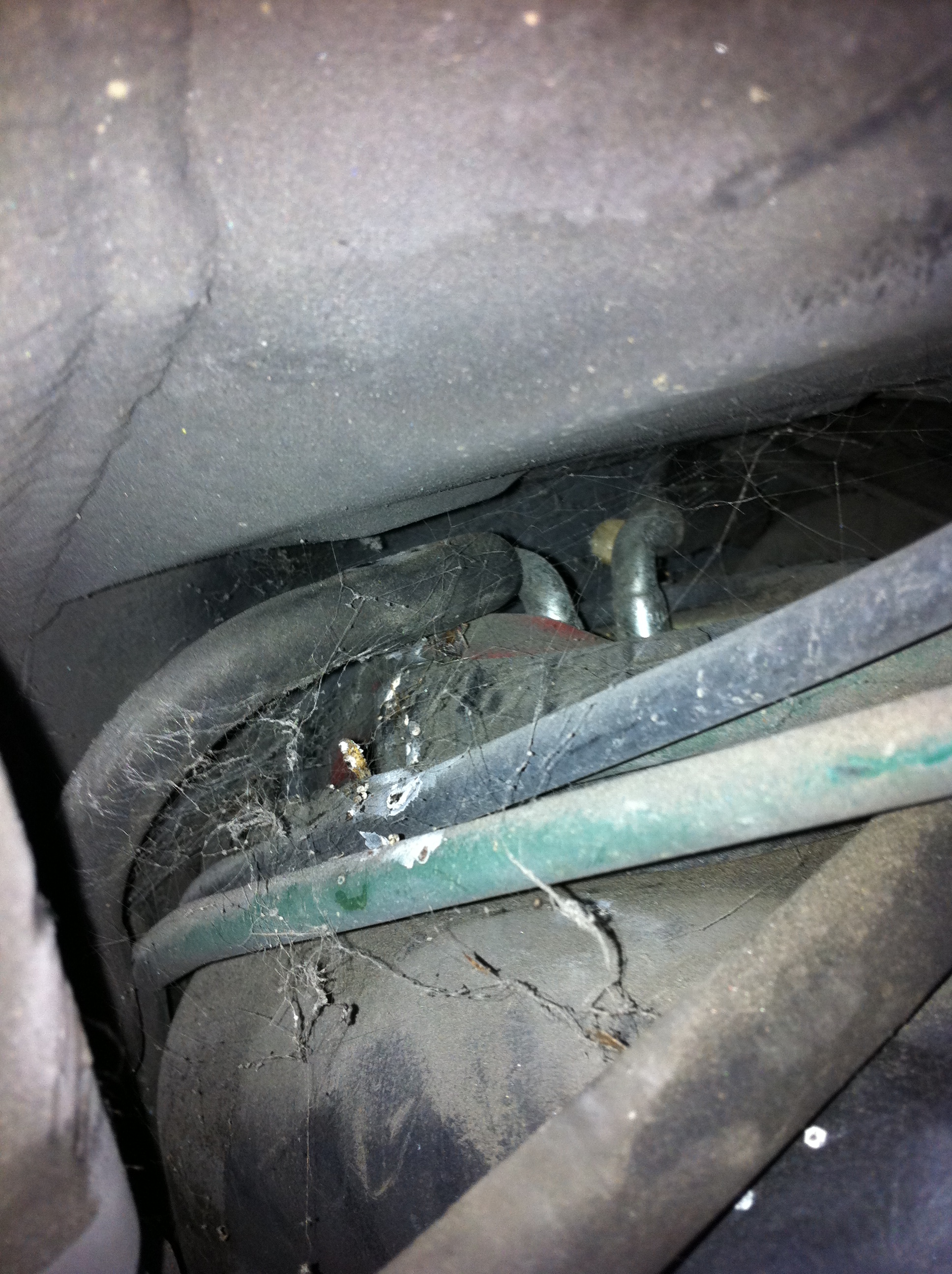

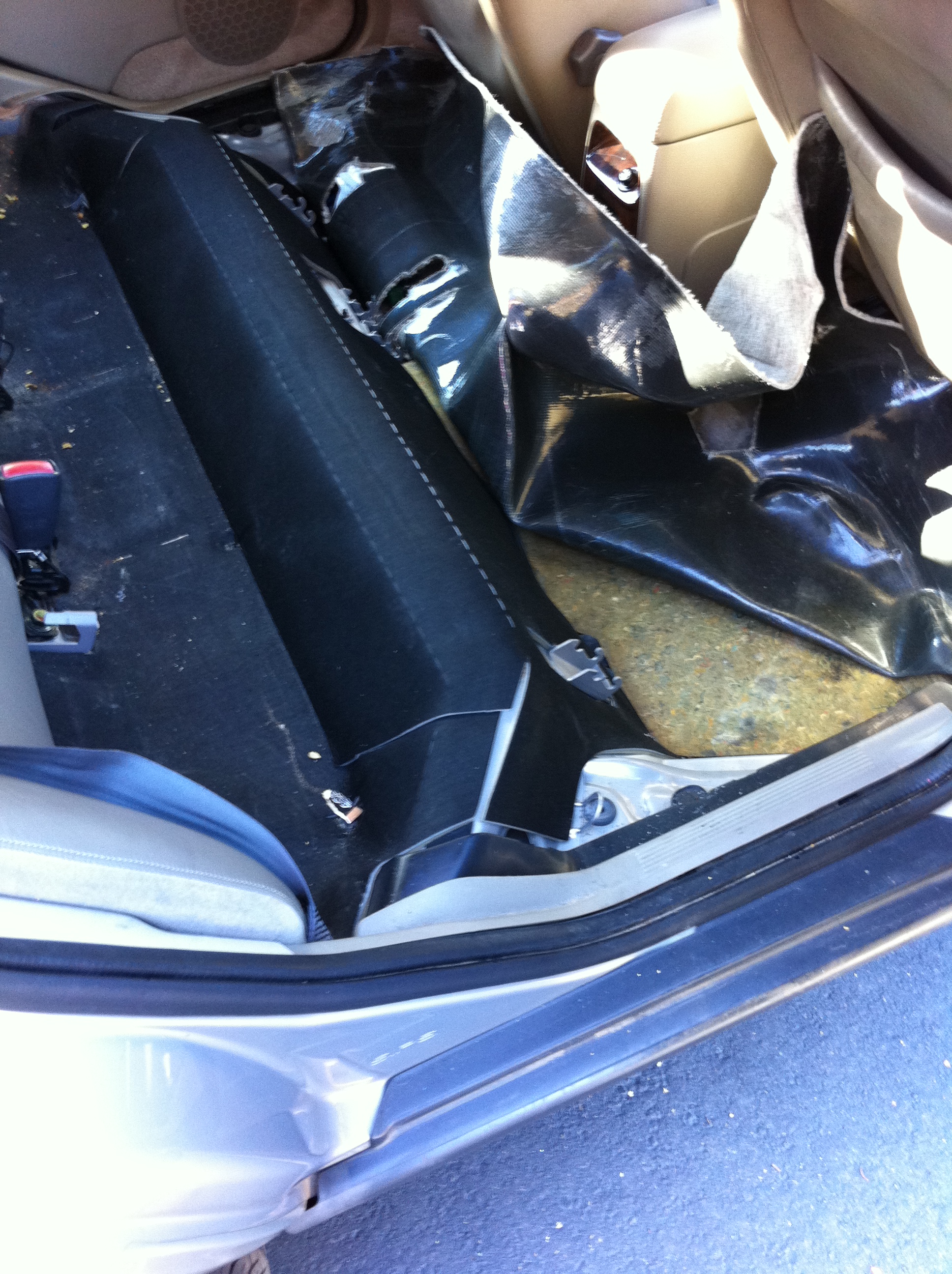

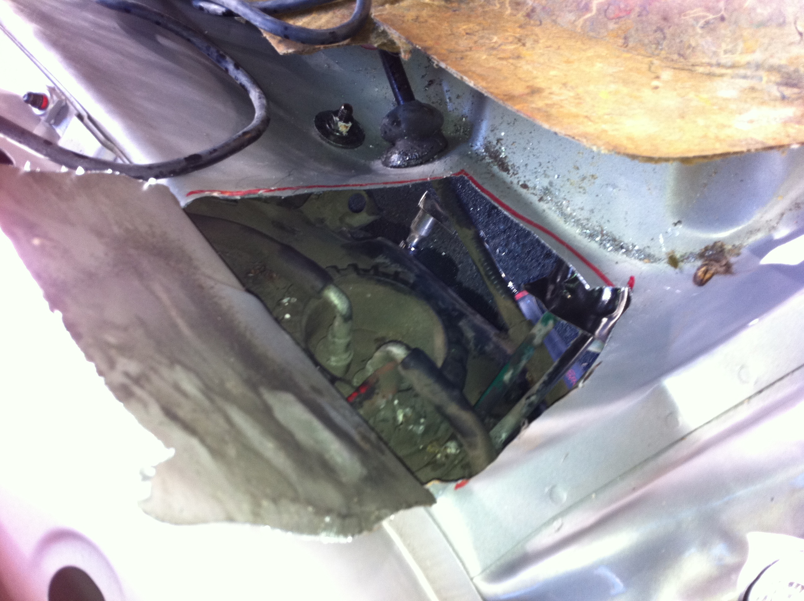

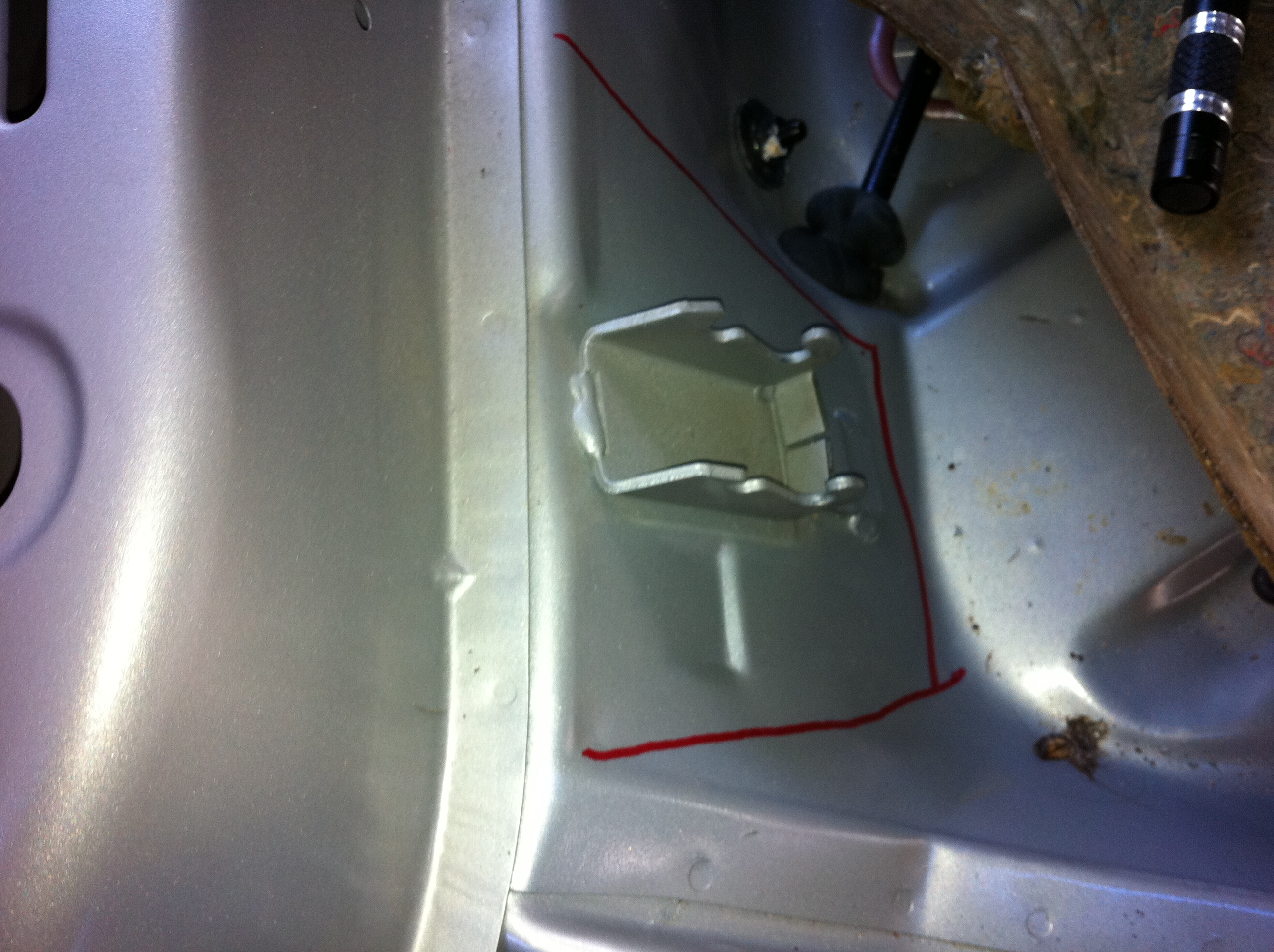

Remove the seat and pull back the carpet and insulation pad.Pull back the carpet and paddingMark the location where you plan to cut the access panel. (look under the car and note the location on the fuel lines and electrical wires.Mark the location of where you plan to cut.Before cutting, remove the 12mm fuel tank strap bolt. This will allow the tank to drop down 2 inches and allow more clearance between the fuel line and floor board.Remove 12mm bolt to allow tank to drop down. I used a scissor jack, however it is not needed.Note the added clearance with the tank strap removed. I used an old license plate and wedged it between the fuel lines and floor board before cutting.Even with the small added clearance the lines are only 1/2 -3/4 of an inch from the floor board. Be careful when cutting.I used a 1/8 drill bit to create a pilot hole and hand cut only 3 sides of the floor board using a mini hacksaw blade. Took longer, however I frequently checked to see where I was cutting using caution around the fuel lines.
Metal blade pulled the panel open and used duct tape on the sharp edges before performing surgery.Pump access panel now open leaving the top portion connected.I had to cut the electrical wires at the pump and marked the white fuel sending unit wires to ensure proper reconnection.
