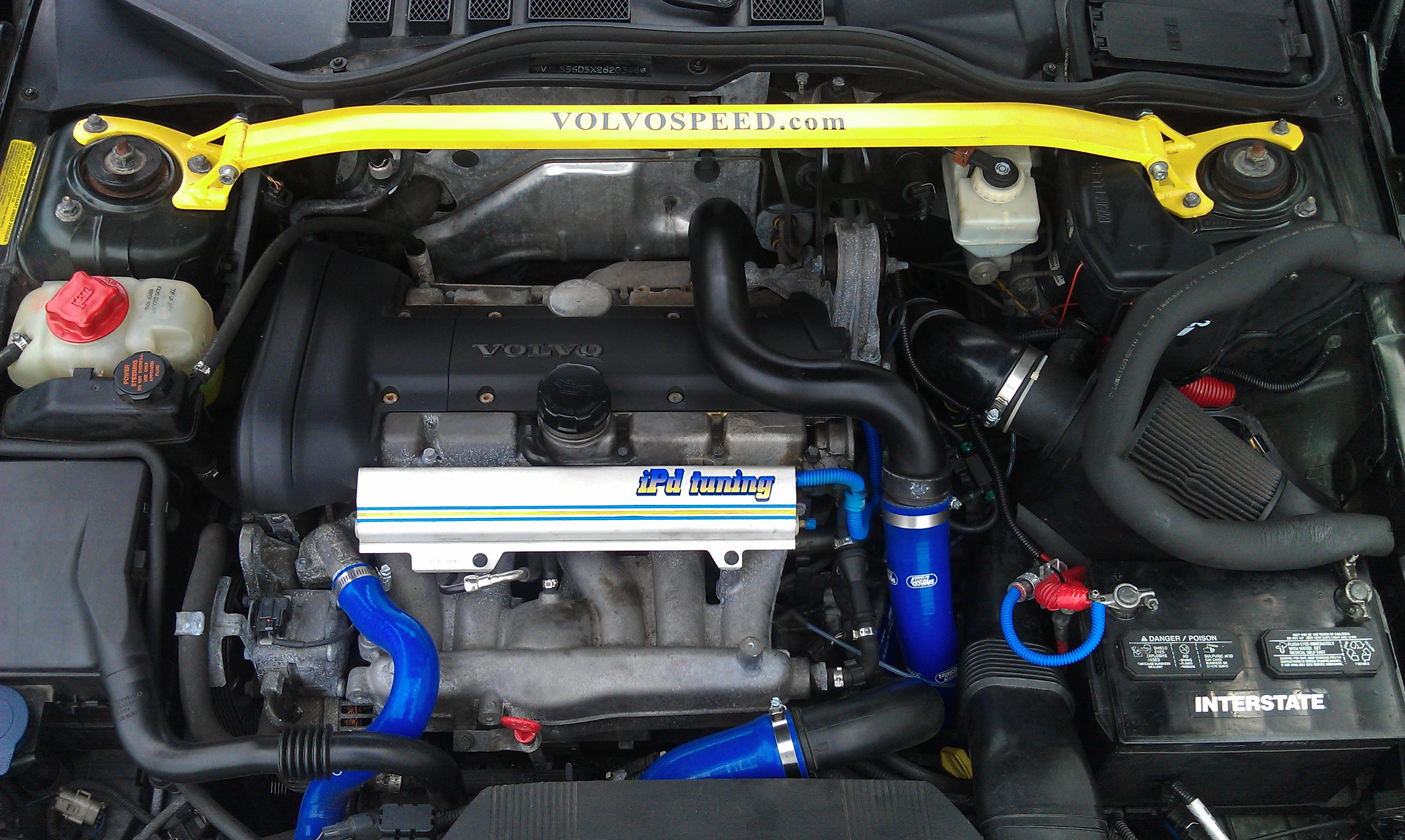

Changing the subject a bit, I re-routed my $25 CAI/SRI to make it shorter and straighter.
Before:
After:
