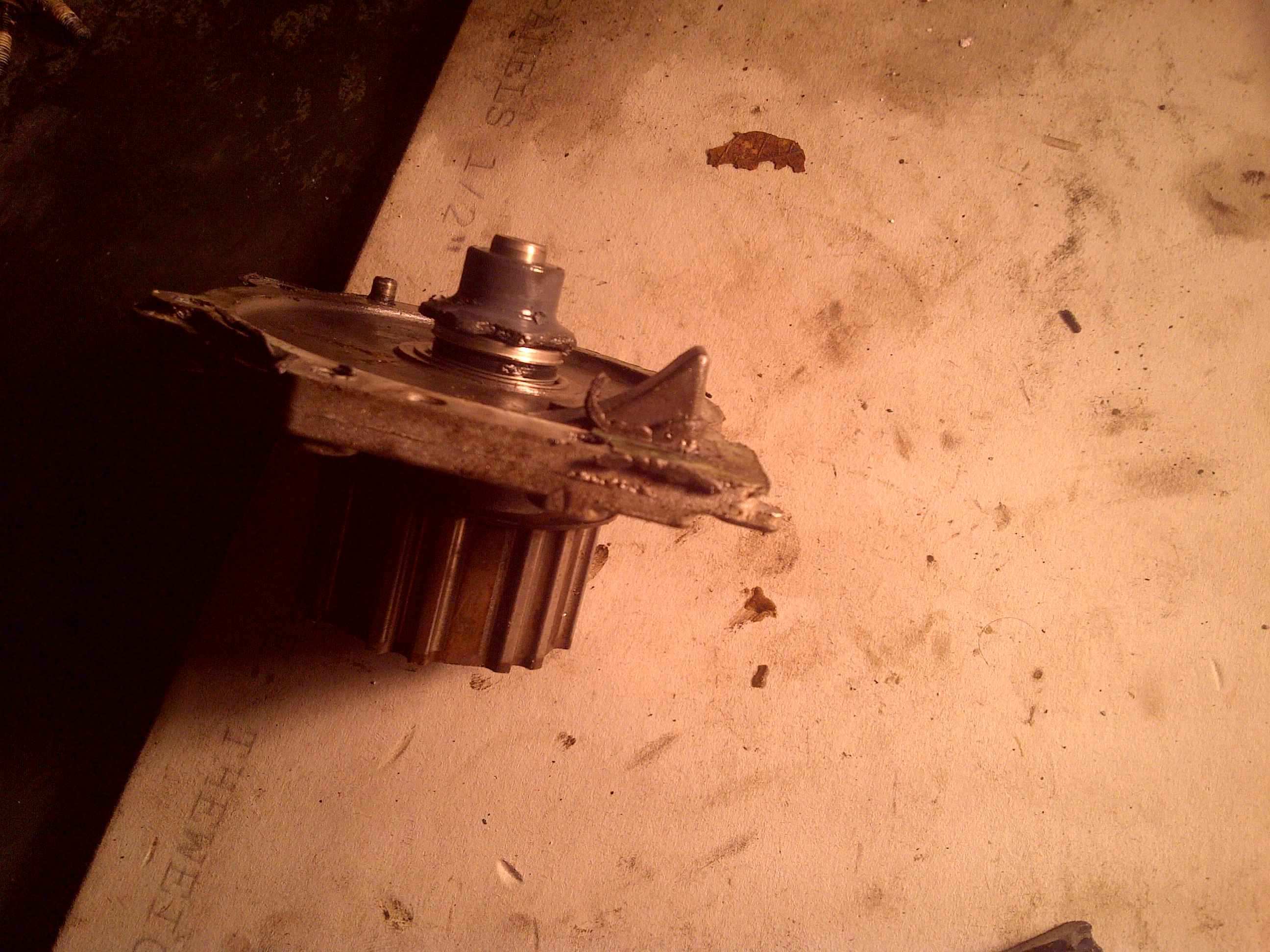

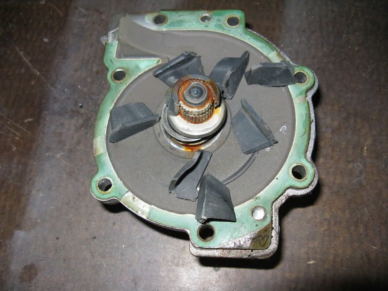

I'm So PISSED! But not nearly as pissed as I would have been if the water pump was fine. Now any ideas on how to get out all of the pieces? The second pic shows the one and only piece of impeller I have! So what now? Really dont want to do this again. Never ever allow someone to put a water pump in your car with a plastic impeller!

Well, that is a first for me too. I have never, ever seen a plastic impeller on a water pump. Thanks for the photos.
Good catch on the pump before it caused more damage.
I just went through a similar situation with my wife's car. The timing belt and water pump were replaced about 20K miles ago shortly before we purchased the car. A few weeks ago the car started pissing coolant so I had it towed to my shop. This is what I found.
Mine did not overheat but the bearing failed and the timing belt was halfway off the pulley when I pulled the cover.
Dodged a big bullet on that one. Never use an aftermarket water pump IMHO...
