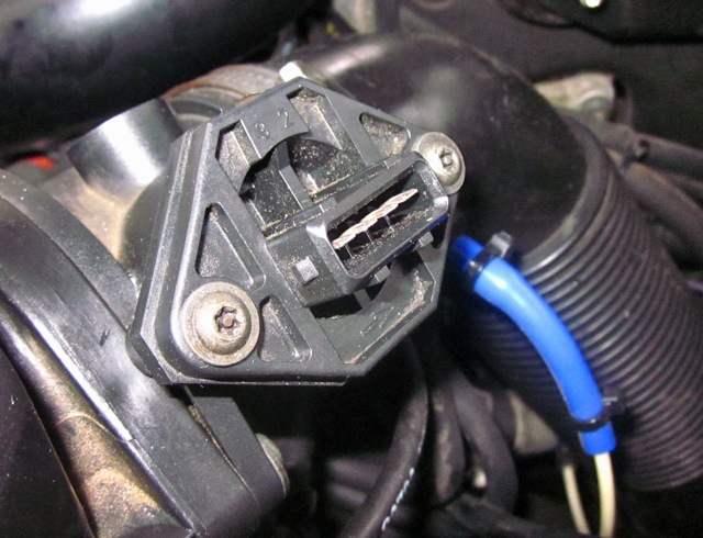

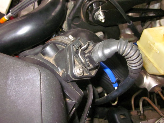

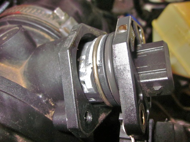

I cleaned the MAF sensor on my 1997 Volvo 855 GLT at 153k miles today, just for general preventative maintenance and curiosity. I couldn't quickly find a nice illustrated write up of how to do this job on the 855, so I thought I'd go ahead and take photos of what I did:

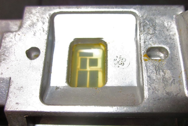

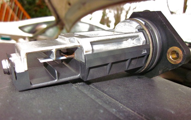

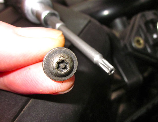

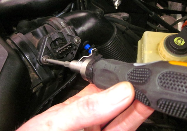

Location of the MAF sensor: First, I disconnected the electrical plug from the sensor. There was some corrosion visible on the connectors, so I wiped off most of it with a clean rag and applied a little bit of "Deoxit" contact cleaner (http://store.caig.com/s.nl/sc.2/category.188/.f) Then, I made good use of my new Christmas present this year: a ratcheting driver with a T-20 Security Torx bit (shown in a couple of the attached pictures below) to loosen the two fasteners holding the MAF sensor in place. I got the security bit at HF as part of a great set ( http://www.harborfreight.com/36-piece-3 ... 97807.html ). Once those screws were removed, I gently wiggled the sensor out. It took quite a bit of force to pry out with my fingernails. There are a couple of slots for putting a screwdriver tip into that would be helpful for prying the sensor loose. I took a photo of the sensing element, which looked clean even before cleaning. I used CRC Mass Air Flow Sensor Cleaner, which I bought at Advance Auto for $8 / 11oz. can. I sprayed the element with a few blasts. The element looked the same after cleaning. The MAF unit has another circuit or sensor that is underneath a yellow plastic film. I didn't touch it or clean it... does anyone know what the purpose of this item is? I then reinstalled the sensor, screws, and connector, and everything is working fine (just the same as it was before I cleaned it!). It's a pretty simple job obviously, but it satisfied my urge to tinker for a little while.
