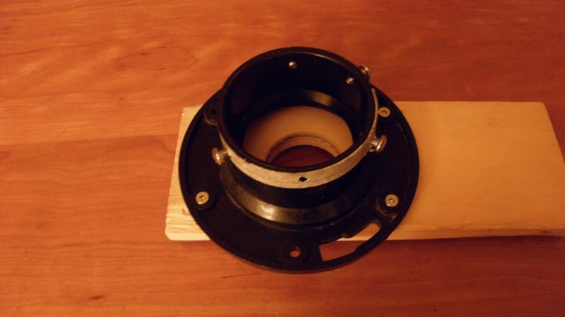

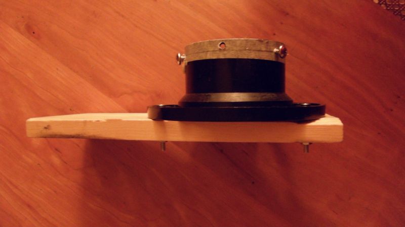

Thank you all but hammer lubricant etc did not help. So I made my own tool.
I took a piece of ABS piping (the part that we screw to the floor than we screw the toilet seat on it?) made six holes around the neck, put 4 mechanical screws (small tread) in there. Made a hole in a piece of wood (to let the wires through), assembled the two together. Adjusted the screws around the neck to get a tight grip. With the help of a mallet loosened and finally opened and removed the ring.

I love DIY solutions.
