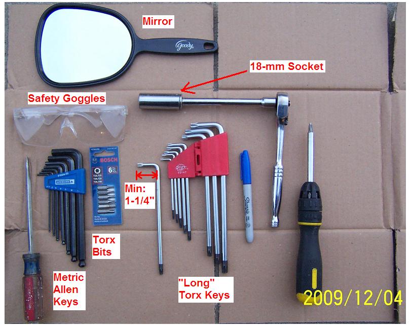

TOOLS:
- Long Torx Set (or Long Torx Drive)
- Metric Allen Key (optional)
- 18-mm Socket
- Plastic Container for tools and nuts/bolts to avoid losing them down below the seats!

My tip: the Long Torx Key must be at least 1-1/4” deep to reach the Torx #30 bolts. Once loosened, I used the 4mm Allen key to spin it out, although this step of using Allen key is optional.

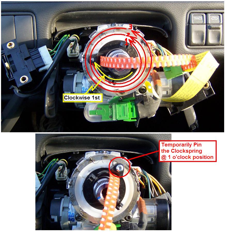

11. This step is important: The Airbag/Horn Contact Unit can turn about a total of 5.5 turns (each turn = 360 degrees). So the Black tab needs to be in the middle of the 5.5 range. Spin the reel CW (Clockwise) and CCW and you will see how it works. This is how it functions when you turn the SW Right and Left.
- Per Volvo procedure, remove the lock screw on the new Airbag/Horn Contact Unit, turn the black tab all the way CW first until it stops. See Yellow Circle.
- Now turn the black tab CCW approx. 2.75 turns as shown (Red Circles #1-2-3), then temporarily pin it in place with the lock screw so it does not move during SW installation.
12. Now install the SW making sure it lines up with the Sharpie marks. Then finger-tight the 18-mm bolt so the SW does not slip off.

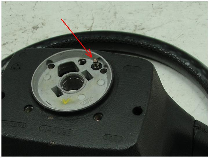

Does someone already have their steering wheel off and could take a more detailed closeup pic of the "ground brush"?
Or maybe you've tried taking apart the a steering wheel assembly before. Tried finding more info online but there doesn't seem to be anything.
I replaced the clockspring on my 98 S70 (SRS light on due to bad squib DTCs - clockspring was hanging on steering wheel spindle and all three tabs were broken) and found that the steering wheel ground brush is not complete on mine.
All I found was a small spring and rounded brass/copper button (see cn90's pic above). Inside the back of the steering wheel hole is a plastic post attached to a wire that continues to the front recess (it's attached to the lower right area) where airbag goes. I greased up the spring with vaseline and stuck it in for now.
But what connects the parts together?

I took this picture from an existing ebay listing (SW from a 1994-97 850, so it is NOT from my car), anyway, this pic shows you the ground brush.
If yours is worn out, then I guess you can make one ground brush yourself using some hardware store stuff.
