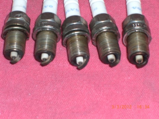

The plugs in the pic below are about 3K miles old. They are in order (one on left, 5 on right). They aren't perfectly clear, but even so it seems the plugs # 4 & 5 are running a little richer than the other 3. Gaps are right at .028.

The #4 & 5 plugs do show more darkness (black) than the other three. But not enough to suggest there is no spark or overfueling....much. I'll see what happens on our drive up the mountain.
