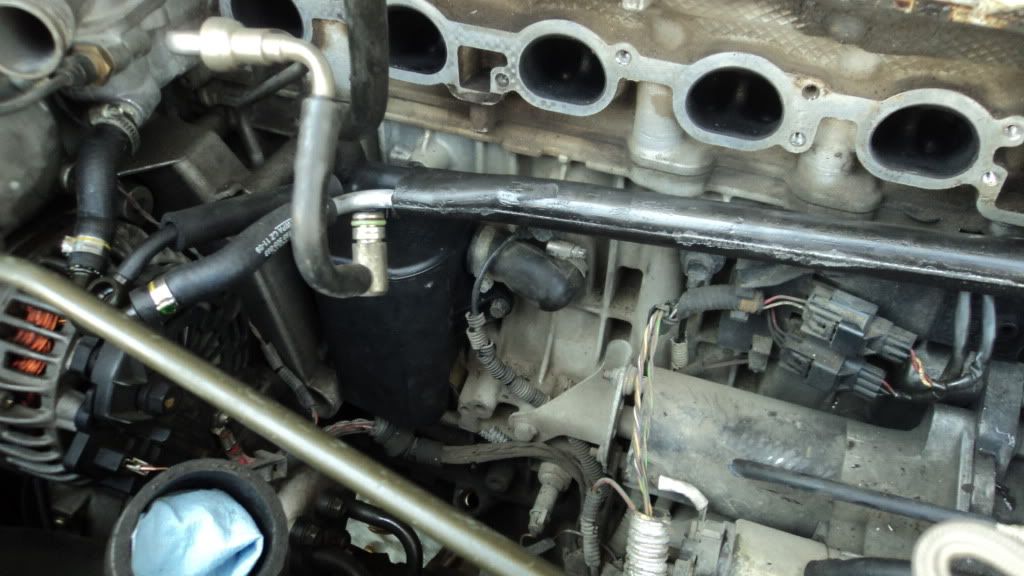

Guys, one question, do you have any pic of the PCV hoses position?(on the flametrap), im a bit confuse now, after i replace all the crankcase system, i having a oil leak aroung the pcv box, i re did everything and the same happens, i started to see that maybe i have the hoses inverted, but on Vadis and all the pictures on the websites are the same as i have. BUT!!!!! on my XC90 is different, saw a car at the dealer with the same setup as my xc90 2.5T
I have the valve cover hose on the left, and intake hose on the right(front). If you look on the pic, thats like i did.

here is a pic of VIDA:
BUT like i said...dont get why on my XC90 2.5T and some S60 02,03, etc at the dealer the position of the hoses are not like that. The valve cover hose is always at the center.

Found the problem, failed oil trap, from new...cant believe it.
