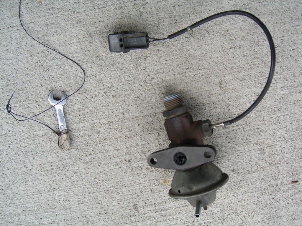

Great, glad it worked out for you!cambiecbc wrote:A second hand EGR value was replaced and all codes were reset. The check engine light
doesn't on even after driving over 20Km. The error code of A6 154 seems solved.
Further follow this post and previous post about error code of A2-154, A3-213 214, A6-154;
https://www.matthewsvolvosite.com/forums/viewtopic.php?f=1&t=47234&p=232862&hilit=check+engine+on#p232862
All problems and errors solved. The EGR removed showing carbon residues sucked the hole. I cut
the wrench to half for easier into the gap with string taped at the end.
ABS sensors removed and showing very dirty with rust all around. Clean with soap and water including hose flushing the inside
work well.
After reset A3, 1 1 1 comes out.
Thanks for all helps!
