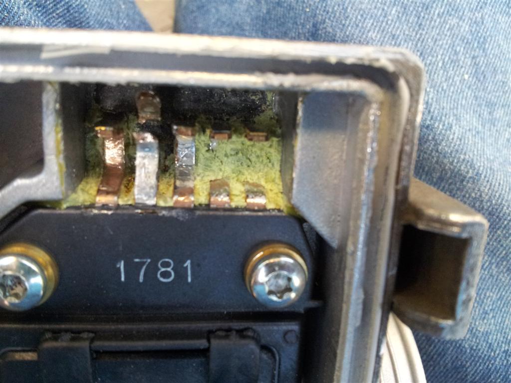

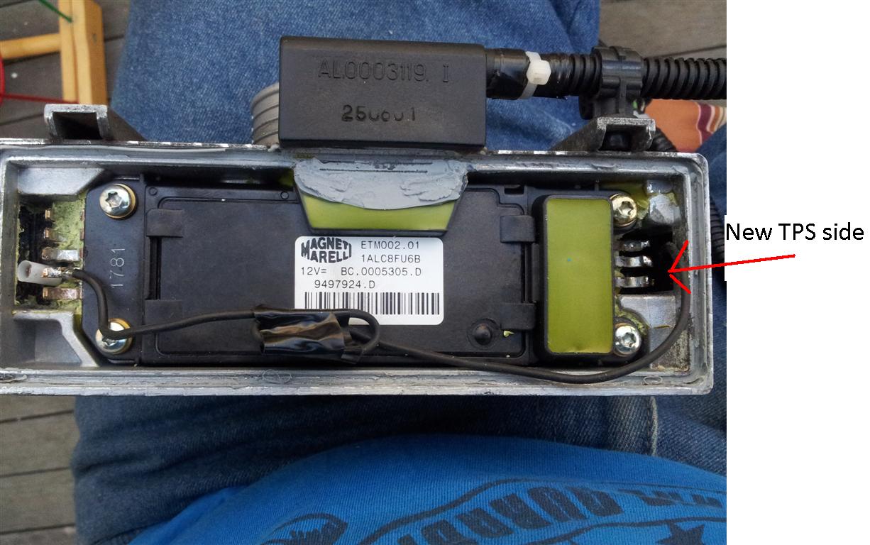

Finally, PART 2 of the NON-contact TPS installation.
you can see that when i soldered the 5 contacts, one of them left unsoldered and not touching with the tps, instead i soldered it to the wire that goes to the new TPS.
i used lead solder with flux for the contacts, and covered with epoxy.

i'm pretty sure that the TPS i have used, is the one being used by the xemodex. they reload the software with your car's VIN number, so makes it PNP. no need for the dealer. also they give a new gasket,screws, etc.
they claim that their solution doesn't require any modifications. but if it is indeed the same TPS i have used, it must be moded as you can see from the pics, the motor has to be shorten.

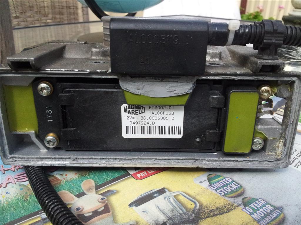

My 2000 V70s ETS light attacked me afew weeks ago and had various limp home periods as well as TPS codes on the OBDII reader. I have been using a '99 V70s ETM for a couple of weeks now as a stand-in and the idle is way too high and I have lost cruise control.
Thanks to Yehuda's immense help and encouragement I tackled the ETM Sacer fitment today and found it took around 2 hours.
If you are impatient or not used to working with small fiddly items I suggest you leave something like this to XeModex who have done probably thousands by now. Good soldering skills are essential as this is a safety related component.
The green putty takes forever to remove and it must be done very carefully with small drivers a little at a time.
After cutting the shaft down I used compressed air to remove any metal filings as this is a safety related component and you don't want iron filings on the throttle shaft.
I've also retaped and re-shrink tubed the entire loom as it was quite torn and holy.

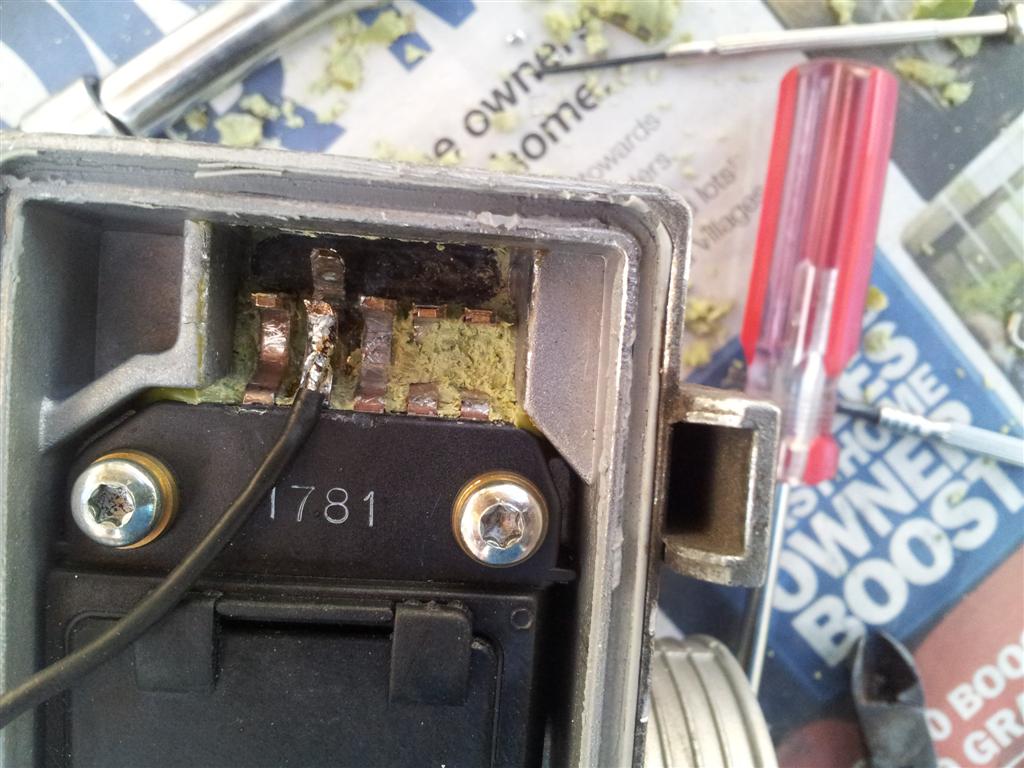

A little solder on this wire and presto!!
20120406_143854 (Large).jpg (165.48 KiB) Viewed 8526 times
You need to separate and isolate this pin (I drilled it apart with a 2.5mm drill as my 40W iron was having no effect)
20120406_142955 (Large).jpg (151.76 KiB) Viewed 8526 times
Finally after around 45 mins and very sore fingers!!
20120406_142122 (Large).jpg (140.52 KiB) Viewed 8526 times

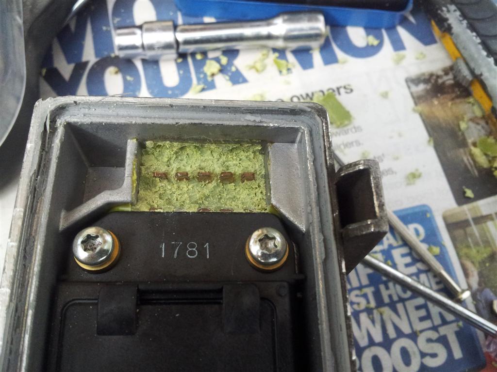

15 minutes into putty removal
20120406_133519 (Large).jpg (157.21 KiB) Viewed 8526 times

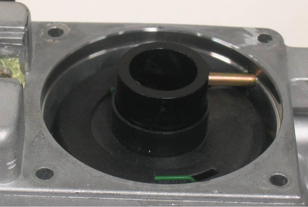

The magnetic sensor attached to the nut with Loctite used
Throttle Shaft cut down with Ozito tool (Dremmel)
20120406_124803 (Large).jpg (152.23 KiB) Viewed 8526 times

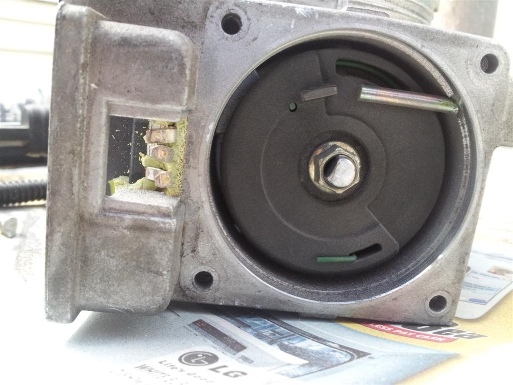

What you see after the 3 wire side is removed, but be gentle with the pins
20120406_124750 (Large).jpg (178.89 KiB) Viewed 8526 times

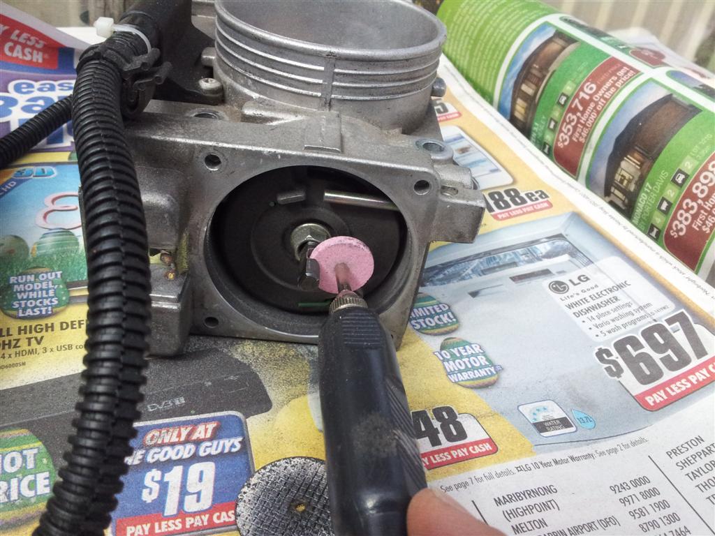

Cutting the shaft with a high speed stone cutting tool.
20120406_124136 (Large).jpg (194.7 KiB) Viewed 8526 times

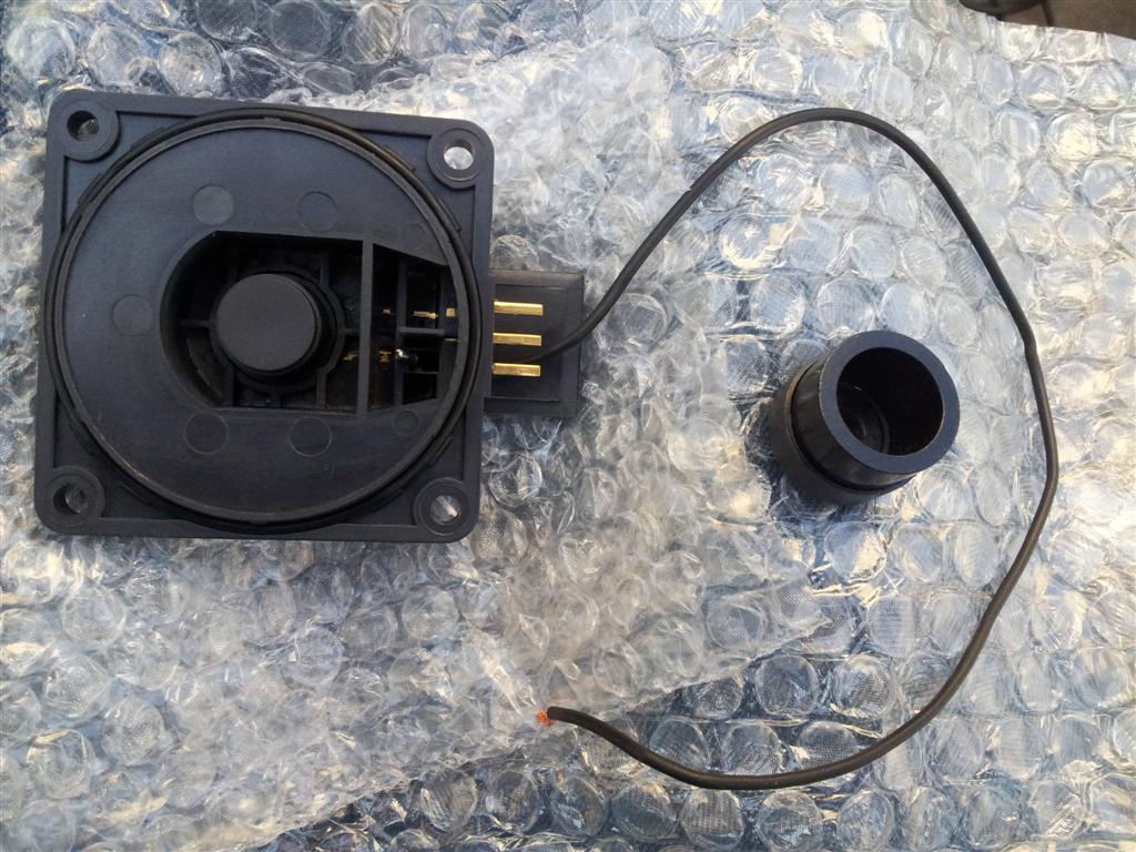

What came in the pack
20120406_150913 (Large).jpg (199.83 KiB) Viewed 8526 times
The finished product awaiting a reseal

This was so easy to do and the result was first class. The most cost-effective 2.5 hours I've spent on any of my vehicles to date. Just hope it stays that way!! In my case an ETM reload was not necessary.
After fitting it this afternoon the idle is back to normal (around 860rpm) and the throttle response is as it should be. The cruise control has returned and the car is back in business.
