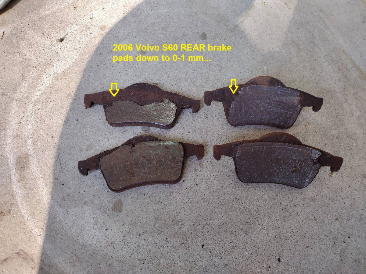

Posts: 8261
Joined: 31 March 2010
Year and Model: 2004 V70 2.5T
Location: Omaha NE
Been thanked: 472 times
Post by cn90 »
This is from a 2006 Volvo S60 that I inherited from an irresponsible P.O.
The brake still worked fine with good stopping power, but I knew I had to replace the rear pads.
This tells me that if you really want to push the pads to 1-2 mm, you can, but you need to inspect frequently...
PS: OTOH, throwing away pads with thickness of 6 mm is wasteful, imho...

cn90 wrote: 07 Oct 2024, 16:39 This is from a 2006 Volvo S60 that I inherited from an irresponsible P.O.
A few years ago my kid said his 02 S60 was “making noise” when braking…one rear pad was in fact at zero lol. Not a big deal as it needed rotors too anyway.
