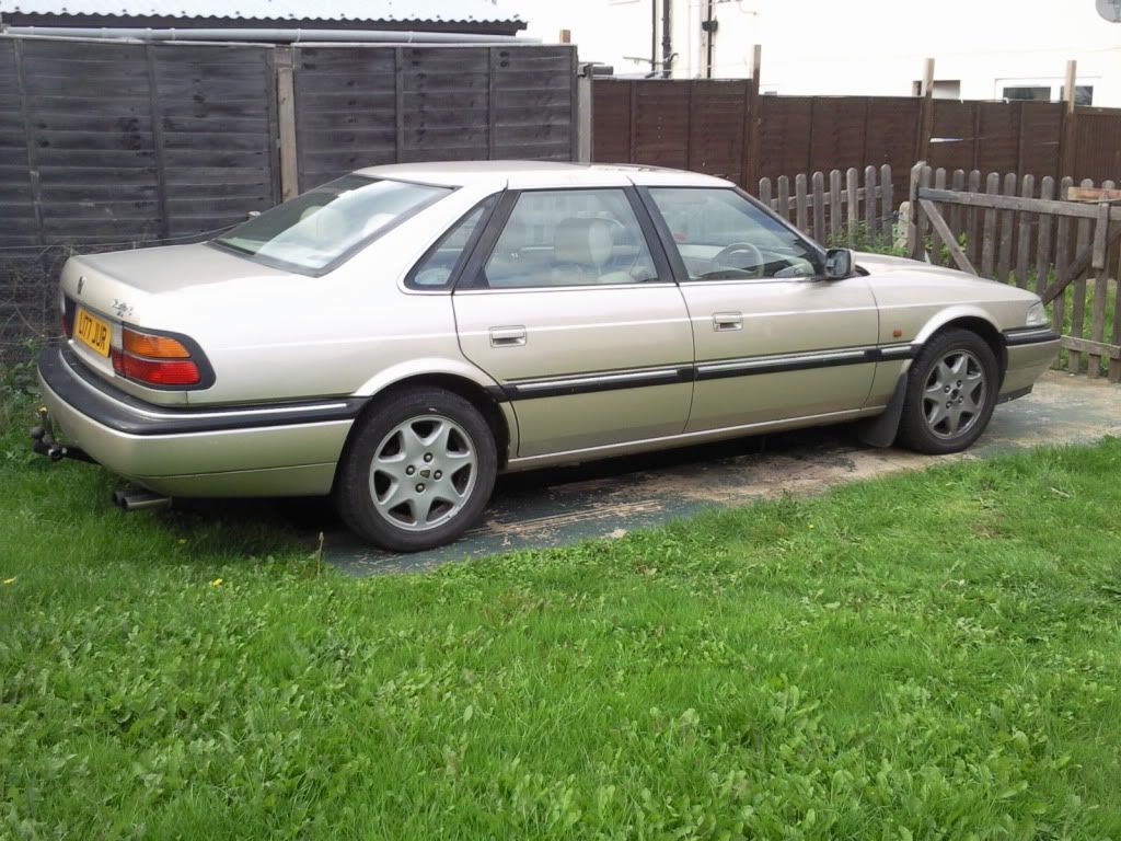

i have a Rover Sterling auto saloon, which is my main transport usually :
Coincidentally, it is my third 800 as well - there's a pattern emerging here!
