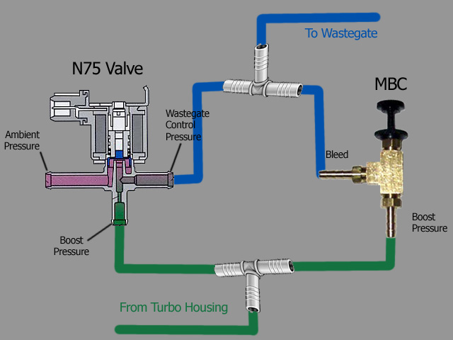

I'm trying to find a way to use a MBC in conjunction w/the IPD HD TCV so I don't over boost in the lower gears and so the ECU will continue to monitor activity. Current set-up works (link to diagram below-just assume the "NC-75" is the IPD TCV )but won't build more than 8-9 lbs of boost. I have a hunch it's because there is consistent bleed-off of pressure via the t-fitting to the compressor bypass valve. I'd love to do an ARD tune but it's not in the budget. Any suggestions aside from a proper tune or electronic boost controller?I appreciate any help you can offer.
https://www.matthewsvolvosite.com/forums ... &mode=view
BTW, Matthew - thank again for the images and language on the MBC set-up you are using. It worked well indeed but just allows too much boost in 1st for my non-R engine. Back to the drawing board.

As for MBC in parallel to a turbo control valve; If your intention is to use the MBC to control spikes then you have it setup correctly. If I'm understanding you correctly you're on a stock tune still so 8-9psi is about all you'll see with the MBC setup in that fashion.
