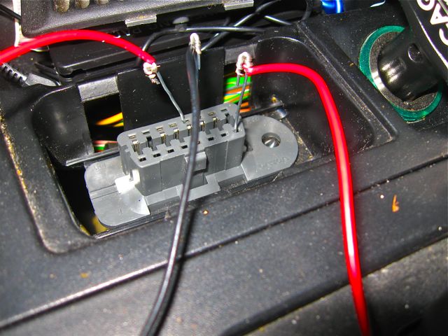

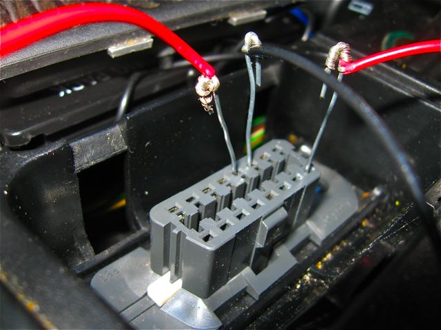

Based on what I read on VS, I cobbled together a switch, a resistor (5kOhms), a blue LED and some wire to make myself a little "code reader". I used some iron wire (which seemed like roughly the right diameter to fit snugly but not too tight in the 16 pin OBD-II connector under the coin tray.
The connections are 5 (GND), 6 (ECC) and 16 (+12V). In the diagram below the connection is shown being made to pin #3, which is for the Motronic system. Use 6 for communicating with the ECC system. With the ignition off, I made the connections here. Note that the LED lights up as soon as you plug in the connections, but once you turn the ignition on, the LED turns off. This gizmo worked like a charm. I closed the switch for about 1s and then when I opened it there was a pause and then the LED blinked out the first code "2 1 1" ("Driver's side damper motor position sensor open circuit or shorted to 12 V" according to my Haynes manual). I had the fan set to low speed and when the ECC was about to blink back the code it turned off the fan, which was interesting.
After each code I closed the switch again and got
2 3 1 "Ventilation damper motor position sensor open circuit or shorted to 12 V"
2 3 5 "Recirculation damper motor position sensor open circuit or shorted to 12 V"
3 2 5 "Recirculation damper motor active too long"
and then 2 1 1 again.
Amazing! I guess for those who have done this before it's old hat and no big deal. To me, the ability to be able to read out these codes for the first time is very exciting!
