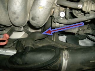

Hello, I was checking engine for vacum leaks due to cel codes P0101,P0172,P0130. Saw this hose was totally torn. It connects from top of radiator/intercooler to front of engine block below the idle control valve.I need confirmation of what part name so I can order correct hose. Its on a 2000 V40.

That is the hose that goes to the Idle Air Control Valve. See diagram for part no. 12. Should be an easy fix! You might want to explore using clamps that tighten with a screw driver vs. the suggested oetiker clamps.
