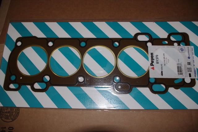

JDS60R has worked on a lot more engines than I have, so he's probably right. Last week I had the Volvo dealer parts counter pull a head gasket off the shelf. He specifically said it was not made by Reinz. It said "Goetberg, Germany", which I assumed was Goetze. Either way, I don't think you can go wrong with the Volvo gasket.

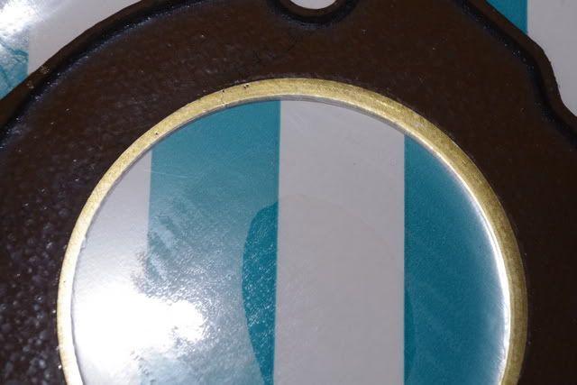

Someone else on here got a Goetze gasket with their Fel Pro kit. So I ordered a Fel Pro gasket, but got a Payen. It looks just like the Goetze, but has a blemish on one of the cylinder rings that you can feel through the plastic wrap. I'm returning it and buying one from the dealer so I can inspect it first. I'll get a 20% discount off the $107 list price. I know they're cheaper online.

Its been 6 months since I did one. With Volvo having the Geely influence things may have changed. You don't happen to have a picture of the gasket do you? Its easy to pick out the VR as it has that fine gray/black outer fine powder like coating. VR set also says made in Germany.

Yep, that looks just like the one they showed me at the dealer. The Payen looks the same also.
If you look closely below, you can see a jagged line running through the brass cylinder ring area, left center, towards the top. It's probably nothing, but you can feel it through the plastic wrap, so I was planning to return it.
