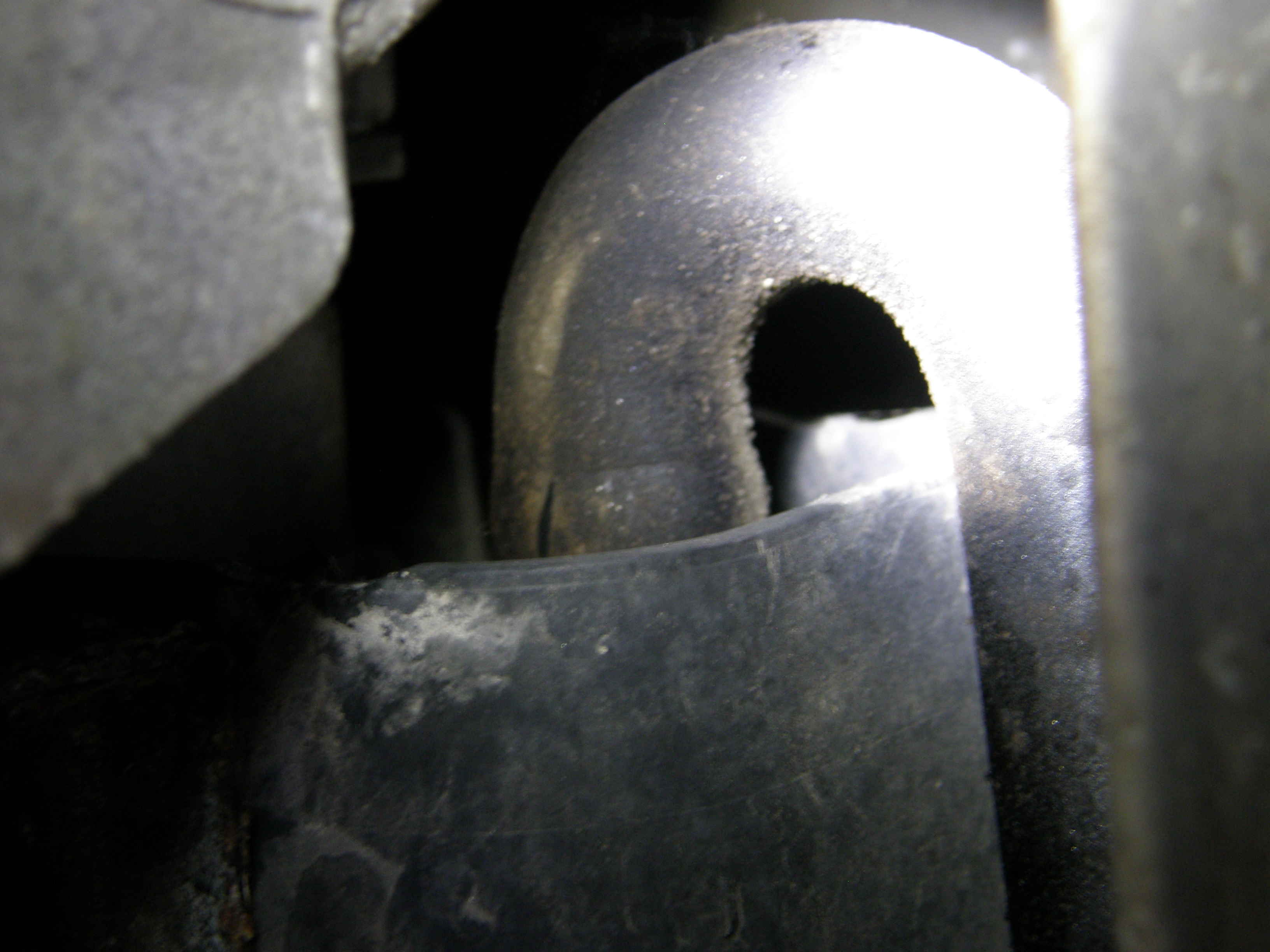

I purchased my VADIS CD on Ebay few years ago and it works fine so far. Few days ago an "engine check" light indicated an evaporator leaks (P0442). I found out that there were multiple cracks on the J-Tube (from charcoal canister) that initiated the "engine check" light. As of now I think that caused the engine check light. I did replace the gas cap and resetted the engine check light by removing the EMC fuse but after a few days of driving the engine check light came on again.
