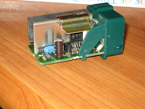

I just had two instances out of the blue with the stalling yesterday and not starting up right away. Drove it to work and back today and it ran fine. I found this post on the forum and the symptoms sound the same. I pulled the relay, it is the 89 8797 000 and I can answer your question; yes, the capacitors are the same values. Judging from your pictures they seem to be identical with the exception of the surface mount IC. Even the 034 LL etched on the board is the same, so I think would be safe to assume it's probably the same board. I just finished the capacitor replacement and it seems to be running fine so far.
Running fine today. Had one of the electronics guys at work take a look at the capacitors. The 100uF was pretty much completely dead, the 22uF was still functioning, but only at about 80% capacity. Right now I'm pretty confident this was the right fix in the situation. I used caps rated up to 105 celcius so they should last as long as the originals. My relay had a date of 1994 on it, so 15 odd years seems a reasonable amount of time. I'm going to hit up the wreckers this weekend and see how many relays I can round up and fix, maybe make them available to people on ebay or something.

Just as an update. I have been looking over my relay to determine if this is something within my solder abilities, and wanted to post some observations.
the 22µF capacitor 25V 105 degrees C. Your radioshack lists 35V 85c
The 100µF capacitor is 16V and the radioshack lists 35v 85c
The ones I found there were closer matches were as follows:
