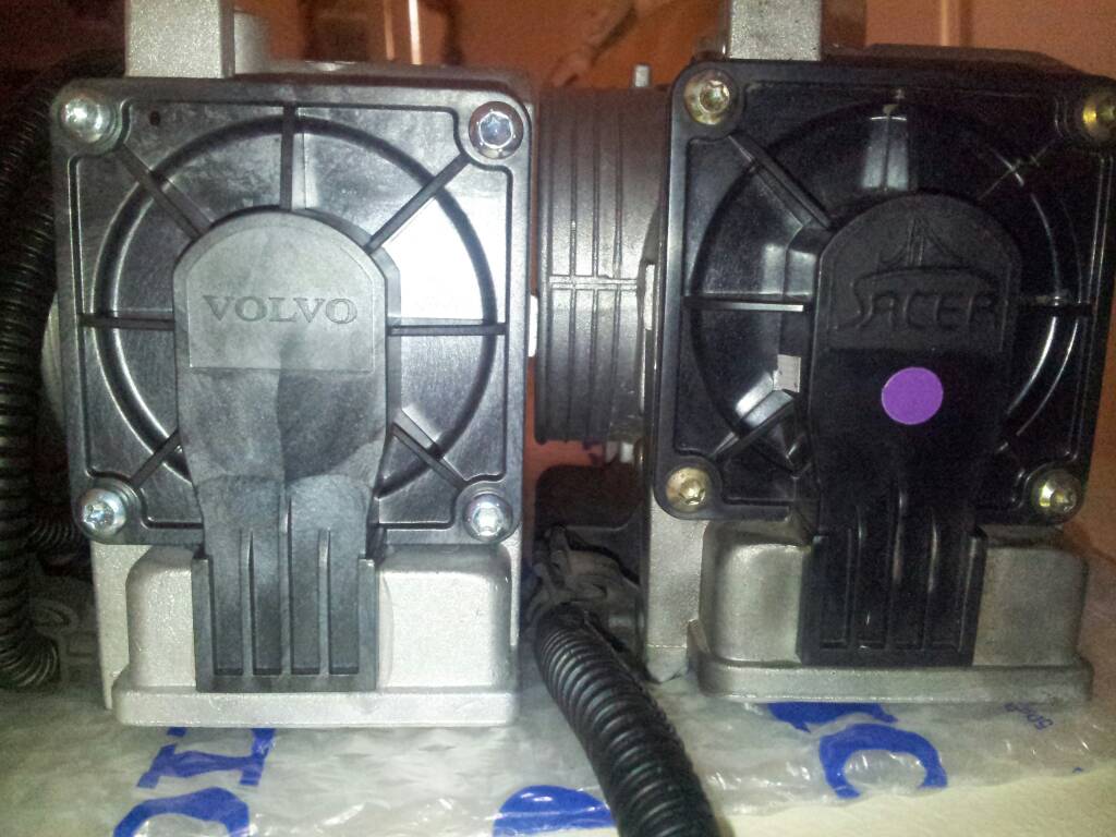

Forget XeModex for now. FCP Euro's rebuilt by Volvo ETMs now have contactless sensors built in and for cheaper. Only $459. The only snag is the core deposit of $150 & the dealer programming requirement. Just picked one up for a customer.
Look at the end cap and compare to the one on the right. That's a magnetic contactless sensor. That's a first for Volvo and a total concession on their part to the flawed film design.

I am not near a dealer and normally do all my own work. Do they all need to be programmed, or just those from FCP? Does it run good enough without the programming to get it to the dealer?

XeModex's run without programming. The dealer and FCPs require initialisation. However if you can GET to a dealer you would just bolt it on in the parking lot. Takes 5 minutes on an NA V70 unless the signal cable is routed behind the starter.

also the fcp euro rebuilts are using the saccr contactless part. which can be had on ebay for 140 and then install yourself and you have your original that does not need to be reprogrammed to the car
