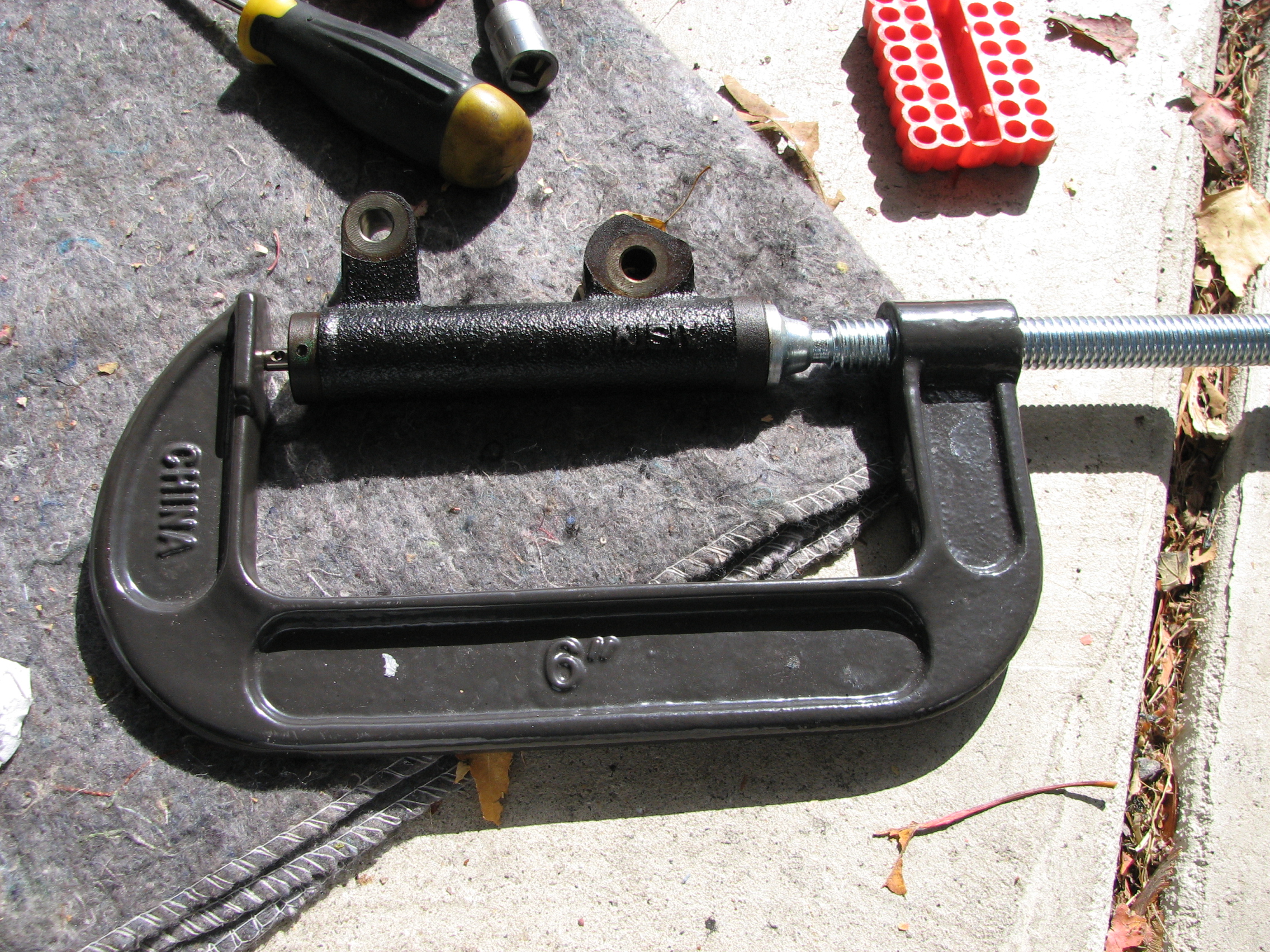

Sounds like it should work fine.
Compress it with a "C" clamp slowly. A quarter turn and let it sit, then again, and again and till it compresses enough to put a small nail in the hole to hold it in place. Don't forget to release nail after install.
Shane

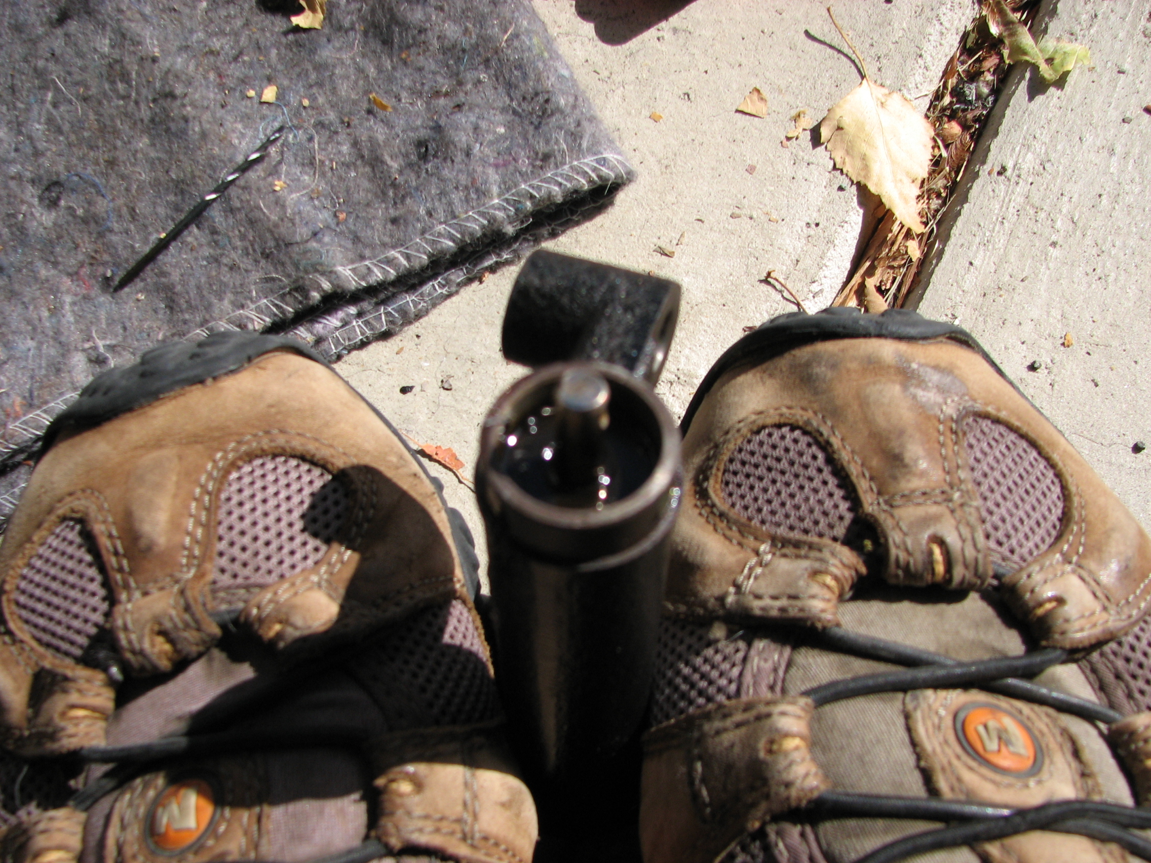

My previous post was deleted, I could not post the photos so it's no problem.
I was only going to show the tensioner I replaced. I found it was leaking fluid after I compressed it.
I'm fairly sure it may have been the original tensioner with about 167k miles. It was the source of an abstract knocking that was the tensioner pulley bouncing on it. The plastic slip ring likely saved the engine.
