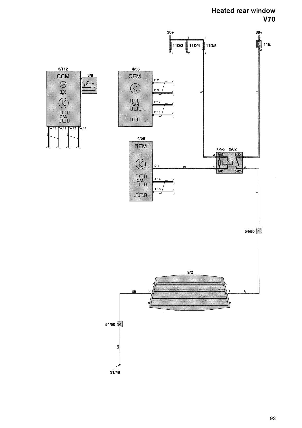

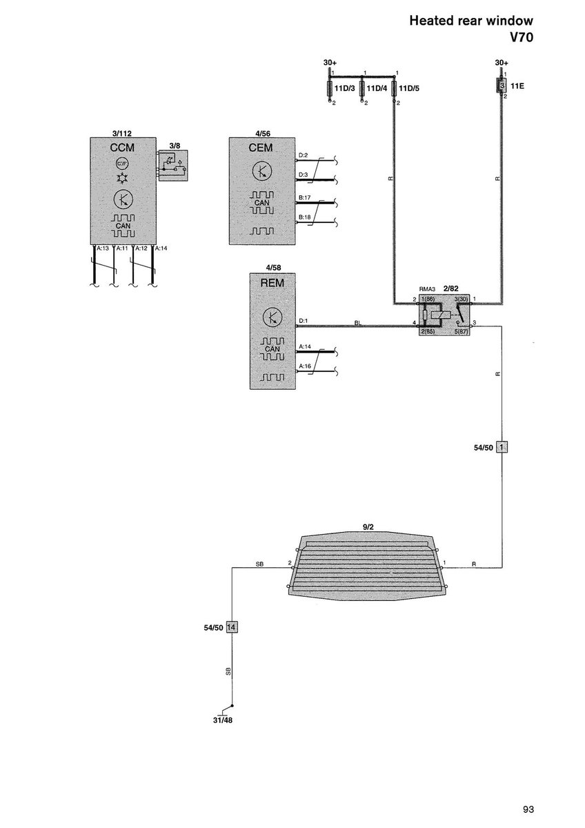

These files were recently shared with me on a post for my own climate control issues. Hope they help
- ECC wiring.jpg (50.27 KiB) Viewed 4917 times
- Data communication electrical distribution.jpg (27.64 KiB) Viewed 4917 times
- Rear heater window V70.jpg (16.8 KiB) Viewed 4917 times
- Heated door mirrors.jpg (23.26 KiB) Viewed 4917 times
