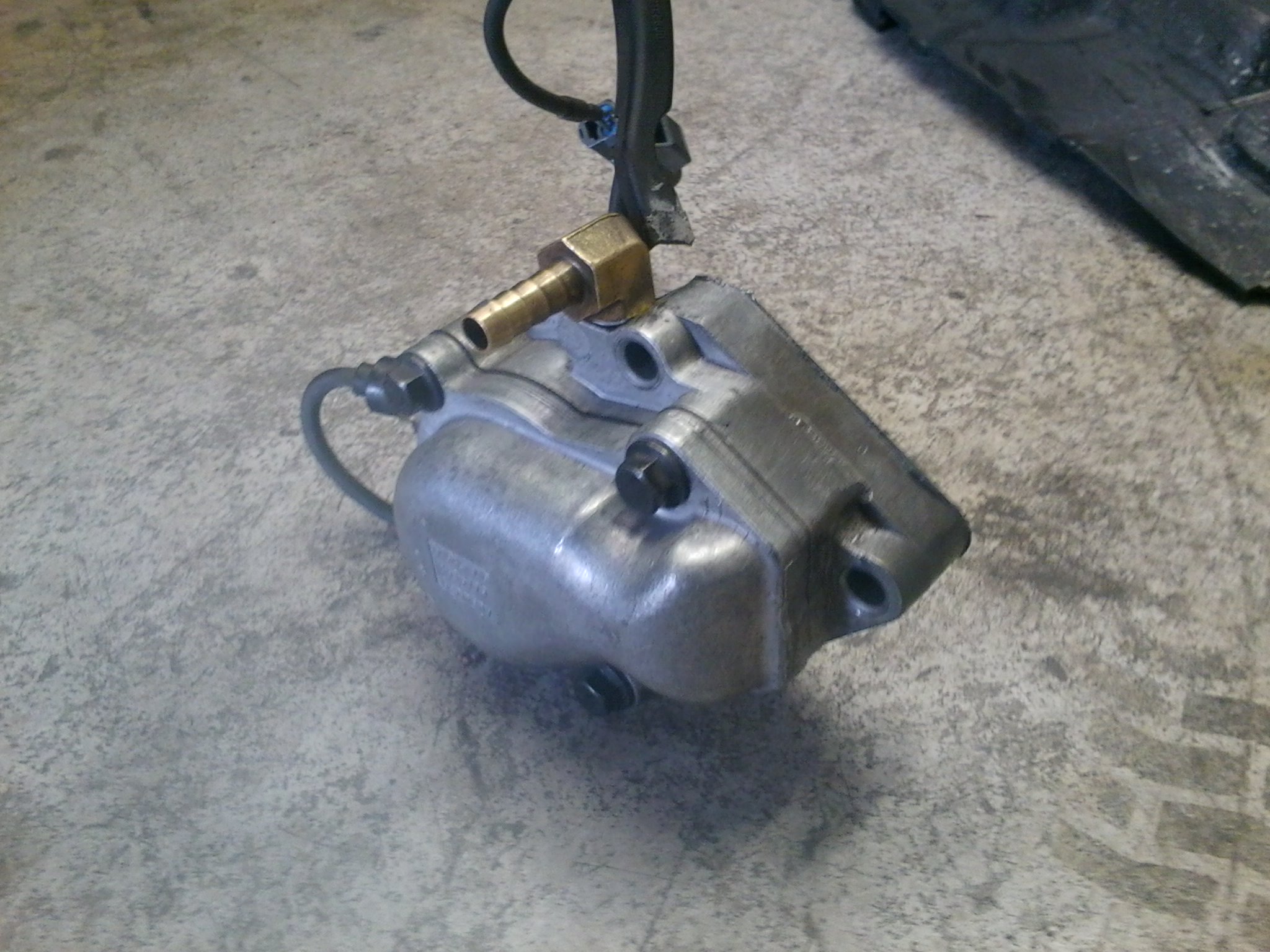

I just finished changing the timing belt on mine for the first time... I dont see how its possible not to break that plastic fitting off! I removed the tstat housing, drilled it out with a 21/64 bit I think, and then tapped it with a 1/8" pipe tap. Found a brass fitting from an old Ford fuel inj pump (I work at a fuel shop, but I imagine you could find something similair at a hardware store) and just screwed it into its place. The barbs are heavy enough that the line won't blow or pull off. Also, I removed some of the material on the timing cover around the fitting to make it easier to reinstall.

Does anyone know of a possible part number Texasdieselguy used for the new nipple on the housing? I have drilled and tapped the nipple hole with 1/8 pipe tap but am having some trouble locating anything that will work. The orange box store was not very helpful this evening and my parts store closed on me.

IF you go to HD or Lowe's or Ace they should have a 90 degree 1/8 NPT by 1/4 ID nipple in their brass bagged fittings wall. These are common. I purchased one at HD within the last few months. NAPA parts stores usually have a good selection of brass hardware also.
plan B is 1/8 NPT male by 1/8 NPT female 90 degree and a 1/8 NPT male with 1/4 ID barb .This second setup is about the same height installed so the room is there for it too.
