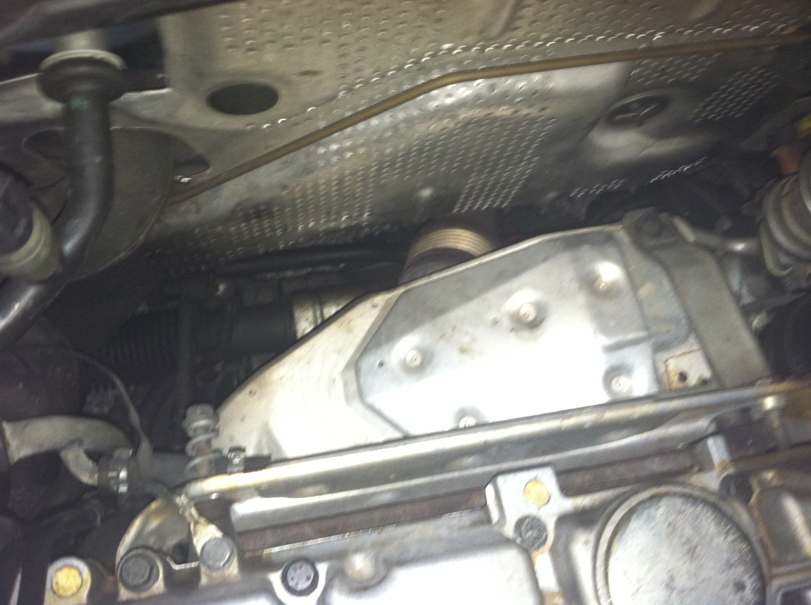

I am new to Volvo with my 98 V70XC. I am just finishing up the head gasket, and can't remember how the 2 heat shields go back on. If someone could post a pic or diagram that would be great! I found this, but it isn't enough detail for me to figure out.

I'm not real sure if this helps you or not, but here's a picture.
That "L" shaped piece has to be shoved up under the other at an angle. The bracket then sits on top of it.

YES! thank you so much! I should be able to get it back in now
