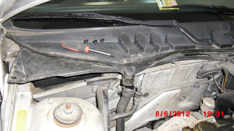

Removed 3 screws with a size T25 and loosened drain hose in order to lift the passenger side of the rain guard at the rear of the engine compartment.
CIMG1697 (800x448).jpg (258.39 KiB) Viewed 2764 times

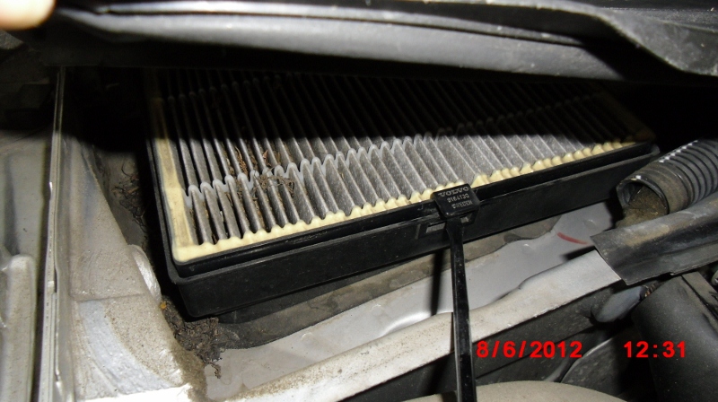

Mine already had a retainer and filter. Remove the old Volvo brand cabin air filter by pushing on the slot with a flat screwdriver and lifting up on the tab.
CIMG1698 (800x448).jpg (230.94 KiB) Viewed 2764 times

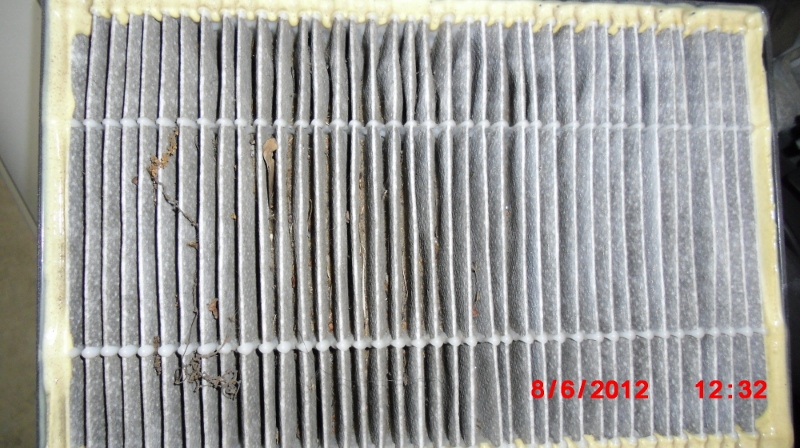

The dirty old Volvo brand cabin air filter with a solid frame. Notice the filter element is blackened by soot and intercepted plant debris.
CIMG1699 (800x448).jpg (284.89 KiB) Viewed 2764 times

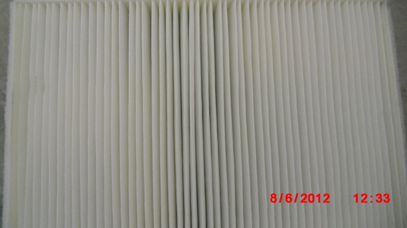

New and clean Purolator brand cabin air filter without a solid frame.
CIMG1700 (800x448).jpg (177.33 KiB) Viewed 2764 times

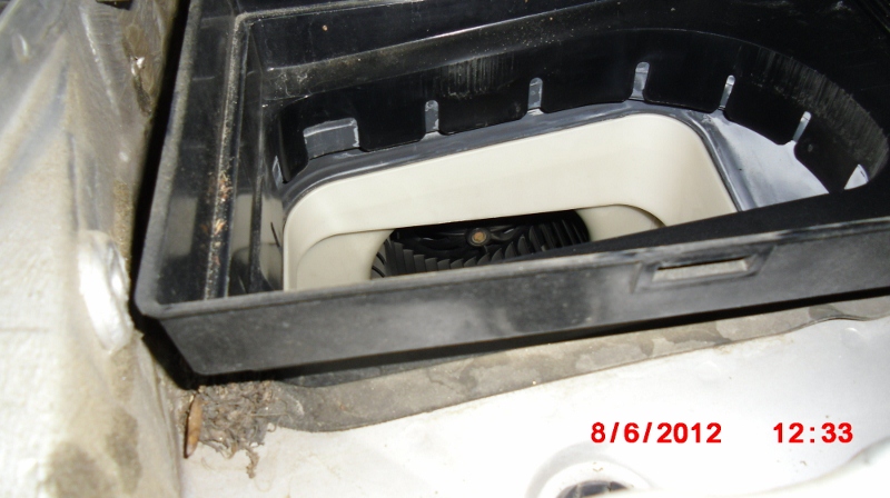

Vacuum in and around filter retainer area. No filter means most of the debris will end up in the blower motor underneath.
CIMG1701 (800x448).jpg (204.48 KiB) Viewed 2764 times

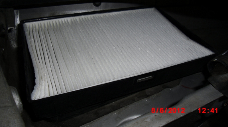

Pay attention to the airflow marks and install. Notice that two sides bend in. Next pollen season get a filter with a solid frame or order the Volvo brand.
CIMG1702 (800x448).jpg (187.6 KiB) Viewed 2764 times

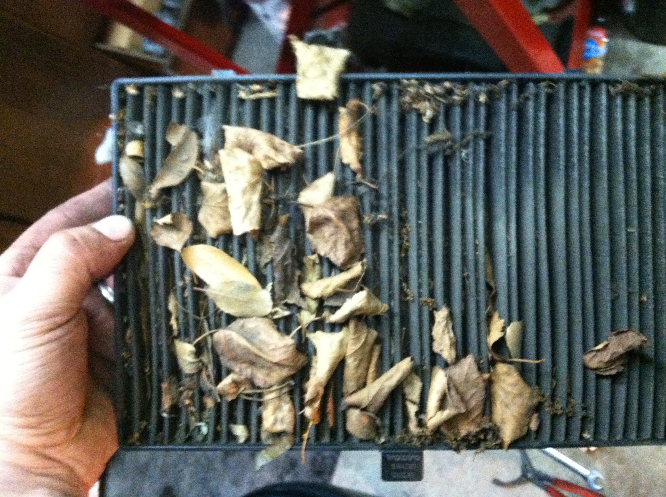

Here's the filter from my dads 98 v70 with 132k miles. Pretty sure it was original. It was so clogged the blower would squeal at higher speeds and the defrost was quite ineffective.

anmartin44 :shock: that is terrible. Good thing you checked it.
