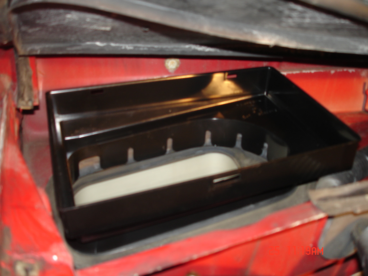

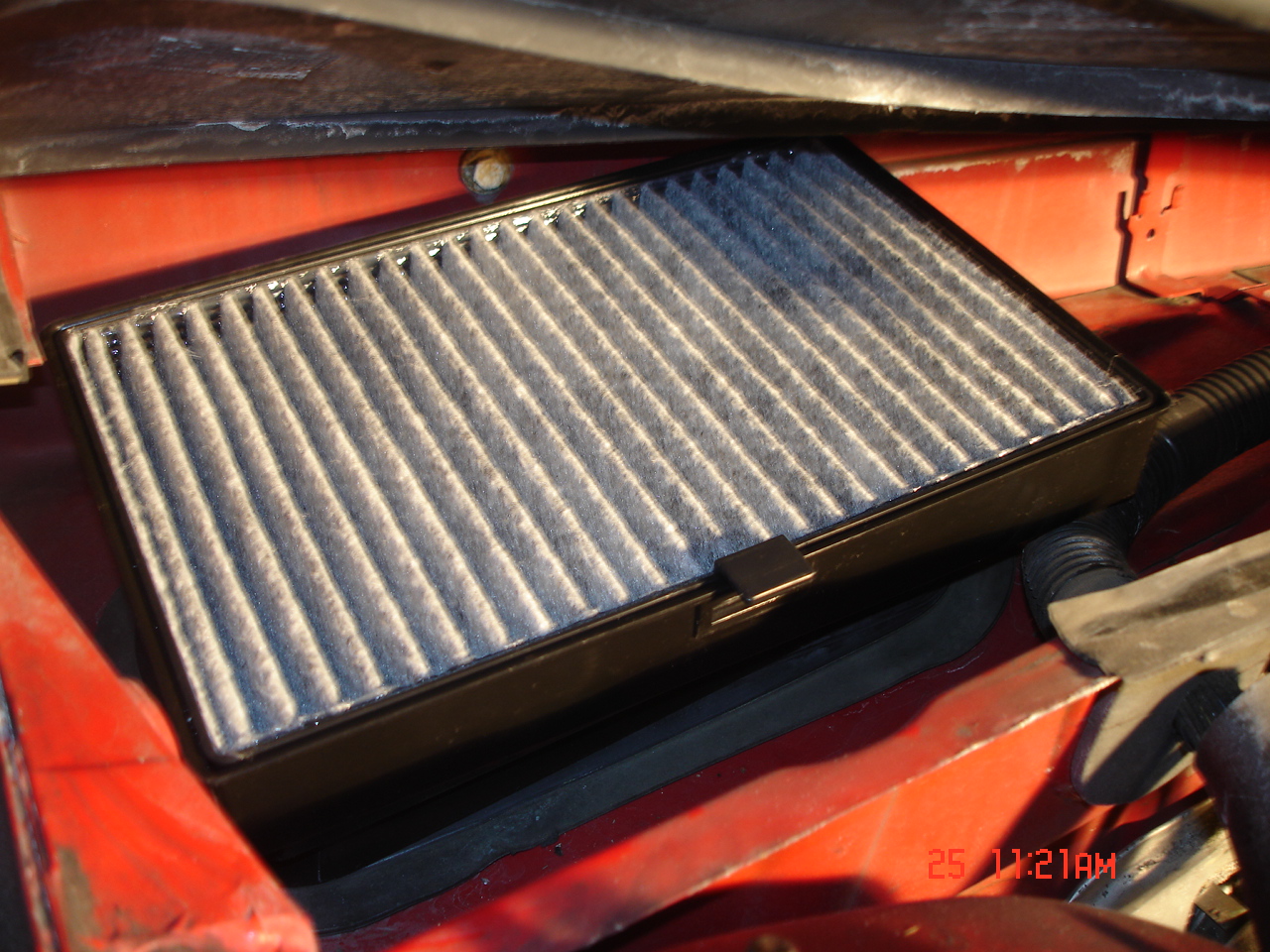

1997volvo850 Â» I received my cabin air filter retainer and carbon filter so I thought I’d finish out the thread. This follows the other photos I uploaded earlier. Ready…retainer and filter.Just lift the rain diverter… Remove the air flow piece that’s there.Insert retainer Insert retainer…Insert filter…snaps into place… All done…Replace two screws…I felt guilty and did some cleaning… Done. Takes only a few minutes.
All done...
