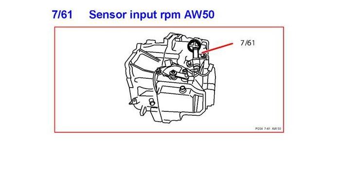

I found this on the Web. Even with the diagram it is not easy to read.
May be it can help.
May be it can help.

The document in the attached link shows it better. Diagram P, unit 709. It confirms that the Input sensor is the one located close to the Park Neutral switch. The Output sensor is 708.
