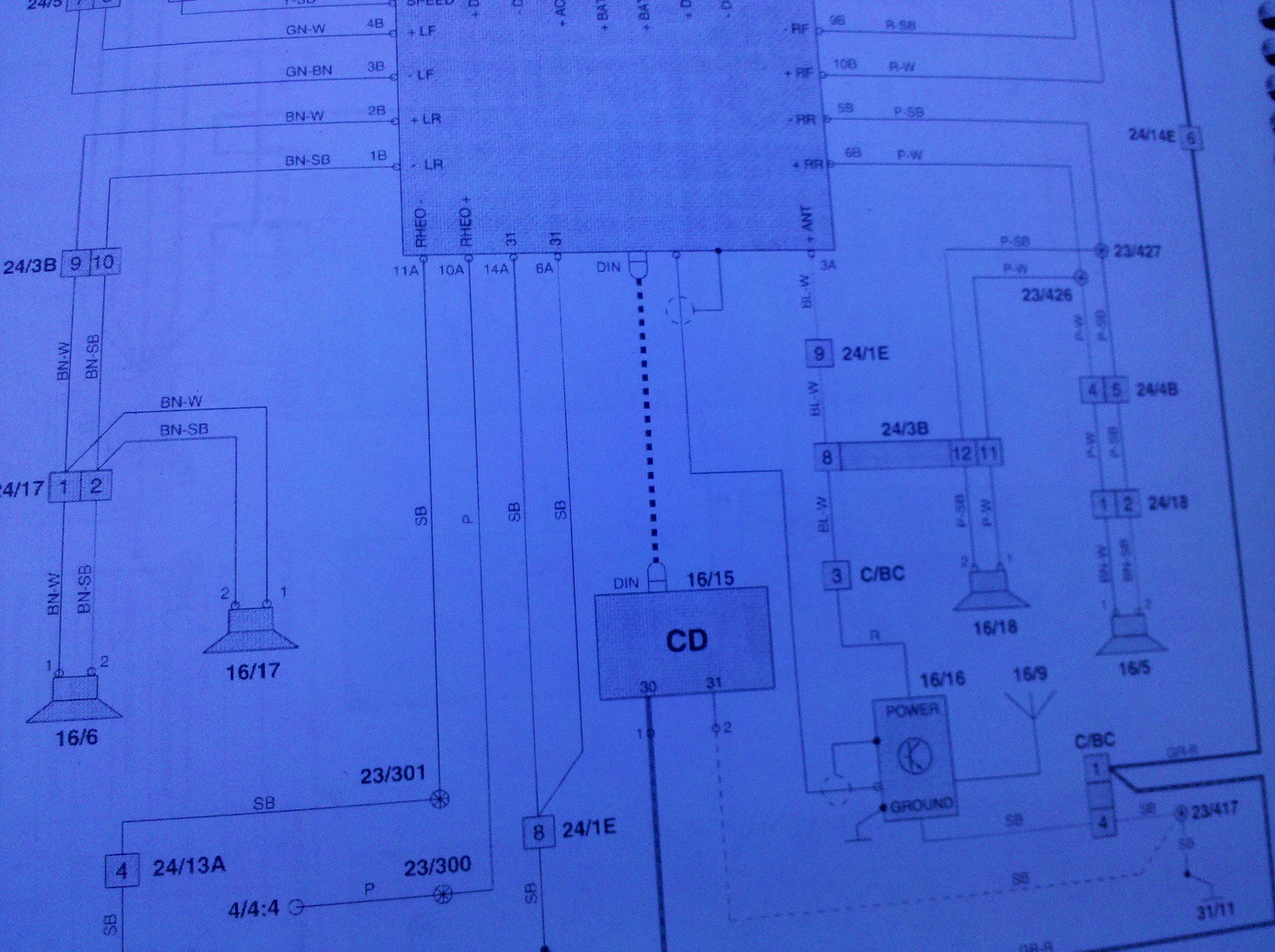

At this point, I got the wiring diagrams out. I checked the 960/S90 radio wiring and found out that it is more simple than you'd think to wire this thing in. The switch seems to be just a simple single throw type. It interrupts the signal sent to the antenna module telling it to keep the antenna up. It is also wired to the dimmer/rheostat so you can see it in the dark. Four wires, no problem.
Looking at the switch connector, we have a red wire in position 4, a red wire with a black stripe in position 3, a black wire in position 5 and a brown wire with a black stripe in position 2. Looking at the wiring diagram for the 960/S90 we can see that the red and red/black wire control the antenna signal. The brown/black wire is the positive rheostat splice and the black is a ground splice. All of this can be easily patched into the radio harness of an 850. If you notice any differences in wire colors or configurations, please reference the wiring diagram for the vehicle you removed the switch from. This tutorial's wire colors and positions only apply to the vehicle I removed my switch from and Volvo is known for switching things up randomly.

You can see the BL-W (Blue with white stripe) wire coming out of the radio at position 3A. This should be your signal wire to the antenna module. To test to make sure this is the correct wire for the antenna, plug in just that connector and turn the key to position 1. The radio will flash "CODE" and the antenna will start to extend. Cut that Blue wire with the White stripe where you intend to hook the switch inline. The antenna should be retracting back down once it looses it's signal. Disconnect the radio, remove the key and solder or butt connector the switch in line with the antenna signal wire. The Red wire from the switch should be connected to the Blue/white wire at the radio connector and the Red/Black should be connected to the Blue and White wire leading away from the radio back towards the antenna assembly.

The Dimmer switch controls a large number of lights inside the car and varies voltage by means of a rheostat slide in the switch. All of these lights connected to the dimmer appear to be in a parallel circuit for power and ground. Were going to access that system too, since it can only improve the "stock" nature of this add on. If you do not wish to, you don't have to do this step. It wont effect the switch. You just won't be able to see it in the dark. I feel comfortable enough in my electrical ability so I'll take the plunge. To be absolutely sure we are accessing the right circuit, take your Voltmeter (Key ON, lights on) and check for voltage at Pin 10A(Pink wire) and 11A (Black wire). These appear on the wiring schematic as (Rheo+) and (Rheo-) respectively. With your DVOM hooked up check the voltage with the dimmer lights all the way down and all the way up. You should see the voltage output go from low (3V) to high (11V) depending on your battery's current state of charge.

Now that we're sure we have the right circuit, connect the Brown wire with the Black stripe (Switch side) to the Pink wire(10A). This will form a parallel circuit on the positive side of the rheostat. I would recommend against using Scotch Blocks but if you cant get a butt connector or soldering iron in there, they will probably work fine. Remember to give the harness for the switch enough room to be plugged in. Do the same with the ground side. Connect the Black wire from the switch to the Black wire(11A) from the radio connector. I ended up cutting the wires and using butt connectors. However, I had to go through a few because the size wasn't exactly right and they kept coming loose.

I´m not sure I get it all. Mr. rspi writes that on his S70 the light controls wires are #2 pink and #5 black.
Where should these wires be connected to? Which cut cable or/and which radio connection position?
Mr. PCars writes: "Pin 10A(Pink wire) and 11A (Black wire). These appear on the wiring schematic as (Rheo+) and (Rheo-)"
I understand it that the light controls wires #2 pink and #5 black should connected to those wires, but on my C70 -98 i don´t have Rheo- on position 11A.
Hopefully someone understand my problem.

I simply spliced my light wires into the light wires in the adjacent switch.
