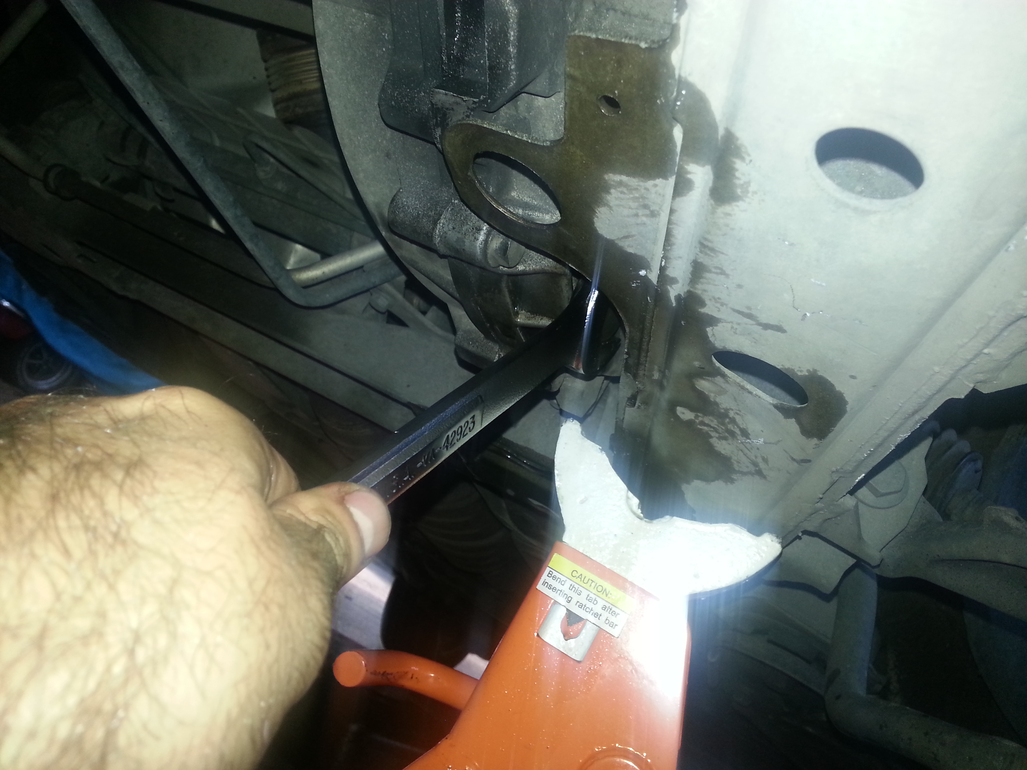

Next grab your 24mm wrench and loosen her up:
Once again I took this photo after the fact, hence the mess.
Next place your oil change container under the drain. If you are not interested in making a mess like I did I would advise placing a funnel under the hole because the fluid is going to hit the frame, spread across it and cascade off of it. So pull the plug out and let the fluid drain. While it is draining I took out the fill plug. Mount up your 24mm socket to your extension and go at it straight through the wheel well.

So now the fluid is drained.Now place the drain plug back in and tighten it but not too much! Remember, the tranny housing is aluminum and the bolt is steel-do not strip the drain or fill hole threads....With the new crush washer on, tighten it until you feel it give then crank just a bit more. Next grab your tranny fluid.
