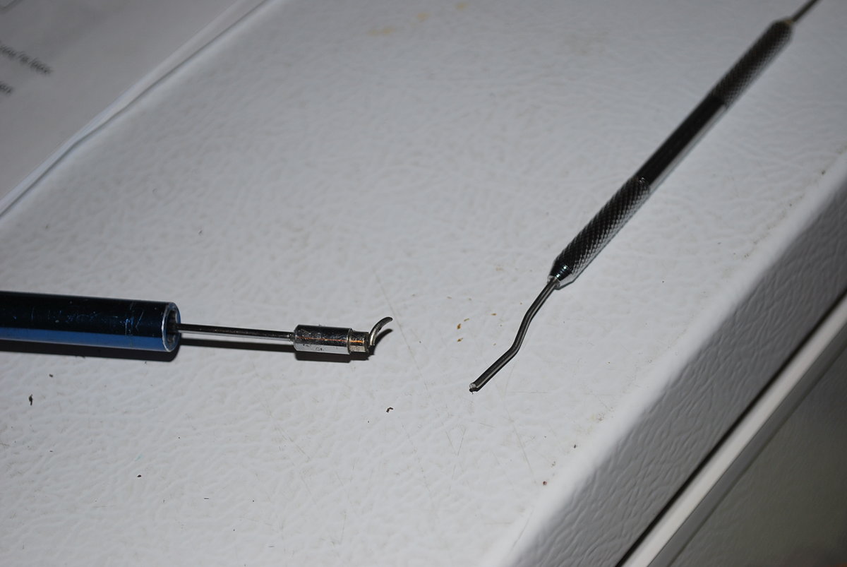

I already had a new belt, tensioner & seals. The old seals were very difficult to get out. I used a couple different dentist type metal picks. One kept bending straight so I would bend it back into a hook. I fatigued the metal & the tip broke off behind the seal! Fortunately I was able to retrieve it (intermediate shaft, not the crank seal or I would have been in trouble). The picture shows the tip on a screwdriver magnet.

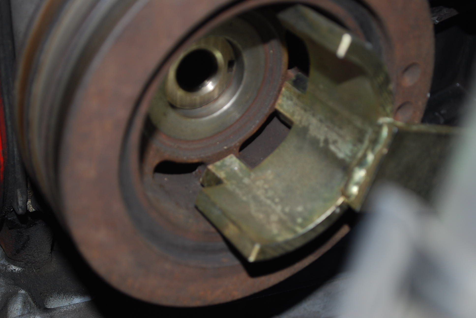

Why is my crank holder tool not aligned with the slots in the crank at TDC?
