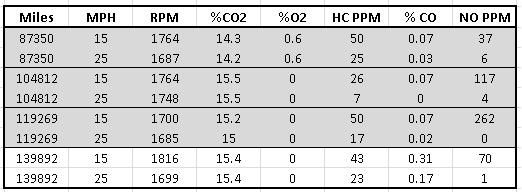

Just got my CA reigistration renewal and I have to get it smogged to renew. Looked back at the previous smog paperwork that I have from the previous owner. Last smog before I bought the car (120k miles, $6k) it was at the HC limit at 15 mph (50 ppm). So I will wait till I get through the smog test before pulling the trigger on the suspension parts buy.

Just passed smog - Yay! Still a little high on the HC PPM at 15 MPH. These are the smog data for my car based on the records I have.
I'd like to know what happened to the car between the 87K and 105K tests where the HC at 15 MPH dropped from 50 to 26 (and then back up to 50 for the next smog at 119K) but that's a different discussion / story.
Almost ready to pull the trigger on the suspension components (I get a bit hyper-analytical when it comes to spending money).
