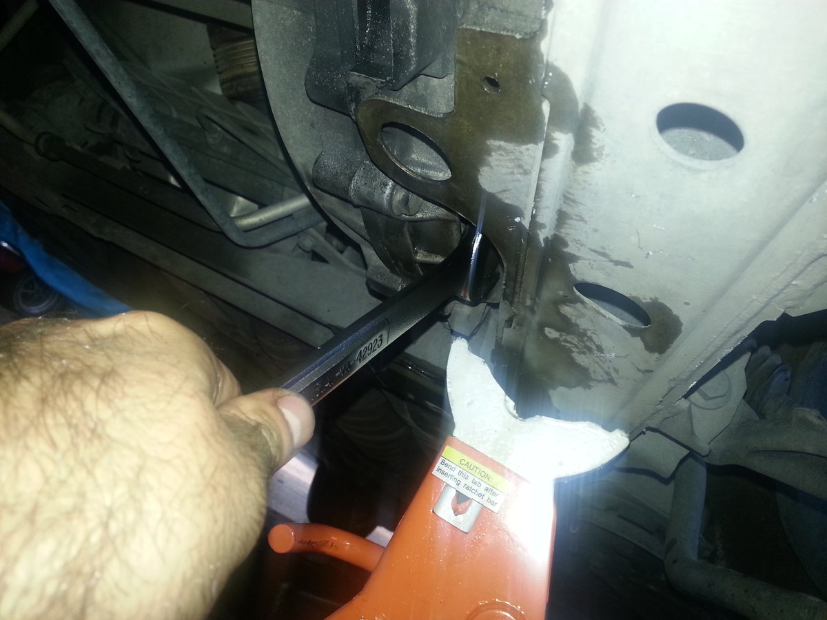

Next grab your 24mm wrench and loosen her up:
Once again I took this photo after the fact, hence the mess.

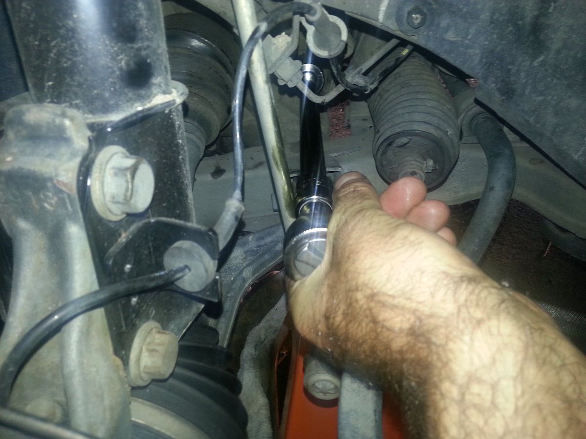

Next place your oil change container under the drain. If you are not interested in making a mess like I did I would advise placing a funnel under the hole because the fluid is going to hit the frame, spread across it and cascade off of it. So pull the plug out and let the fluid drain. While it is draining I took out the fill plug. Mount up your 24mm socket to your extension and go at it straight through the wheel well.
Yes, my arms are very hairy.

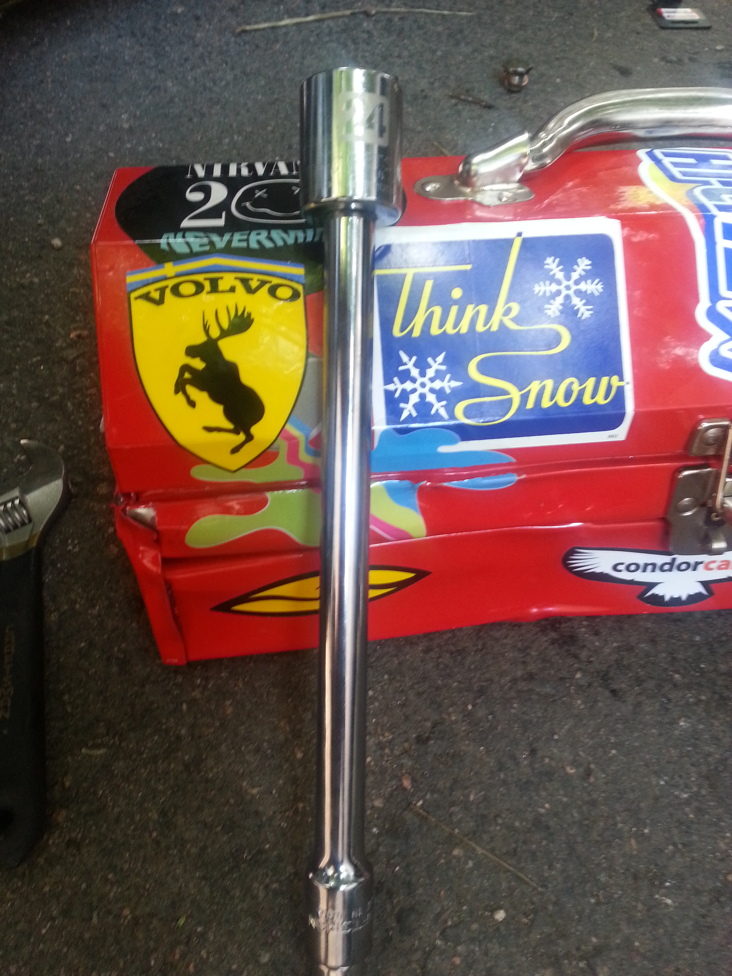

I found that a 10 inch extension and a smaller ratchet was about perfect. no rubbing against the wheel well and enough distance to get out of the way of the suspension and lines.

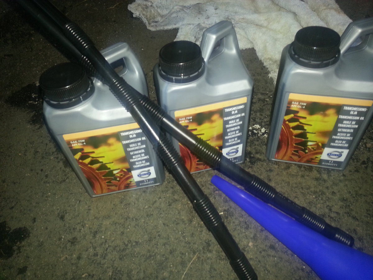

The capacity for this transmission is 2 liters.  I bought three and wound up using one and two thirds of another.  So two should be enough.
