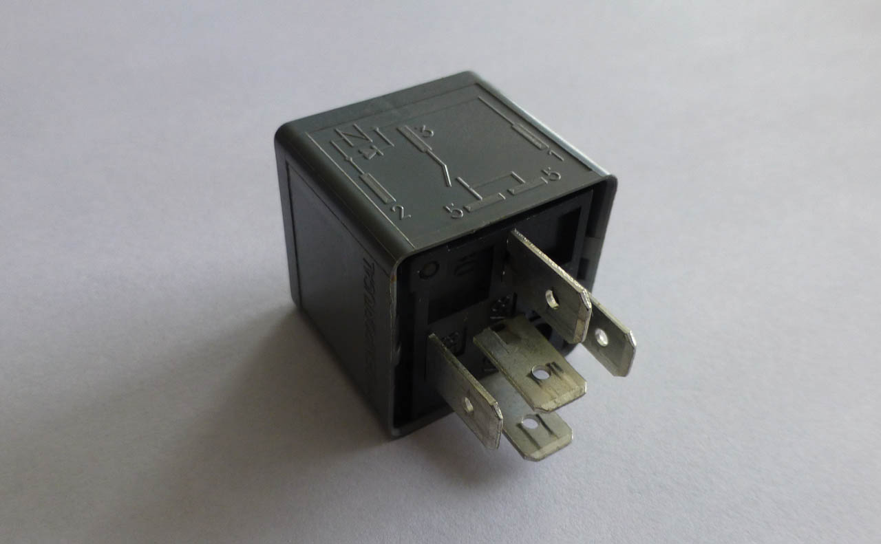

Thanks for this excellent explanation, my electrical problems were more or less identical, when starting, the horn, window motors, heating/airco fan, radio, wipers, all didn't work. Two times, after driving 2-5 minutes, everything worked, the 3rd time driving, problem persisted. So, it looked similar to issues, linked with ignition switch, but in this case it came down to a faulty relay, hidden somewhere below a fuse box, when that was done, all was fine again

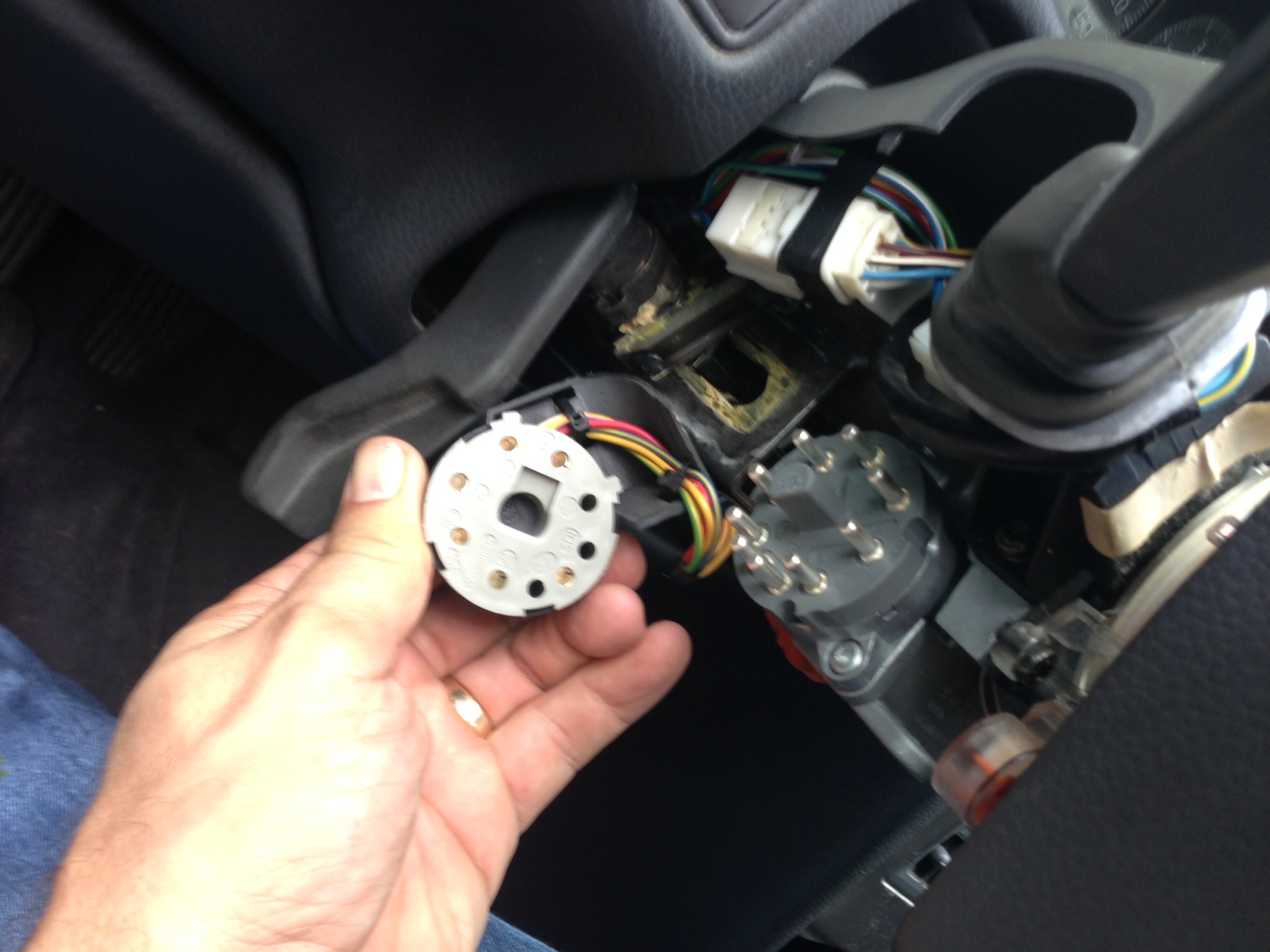

Not all pins on the electrical connector are populated - on my car, this is what they look like
YMMV
1999 V70 Ignition switch connector view

RayCis wrote:Thanks for this excellent explanation, my electrical problems were more or less identical, when starting, the horn, window motors, heating/airco fan, radio, wipers, all didn't work. Two times, after driving 2-5 minutes, everything worked, the 3rd time driving, problem persisted. So, it looked similar to issues, linked with ignition switch, but in this case it came down to a faulty relay, hidden somewhere below a fuse box, when that was done, all was fine again
Which relay is that?

Can you provide some detail on this? WHat/where was the relay. Did you lose your instrument panel, speedo and tachometer? My abs and brake light lit up as well...
