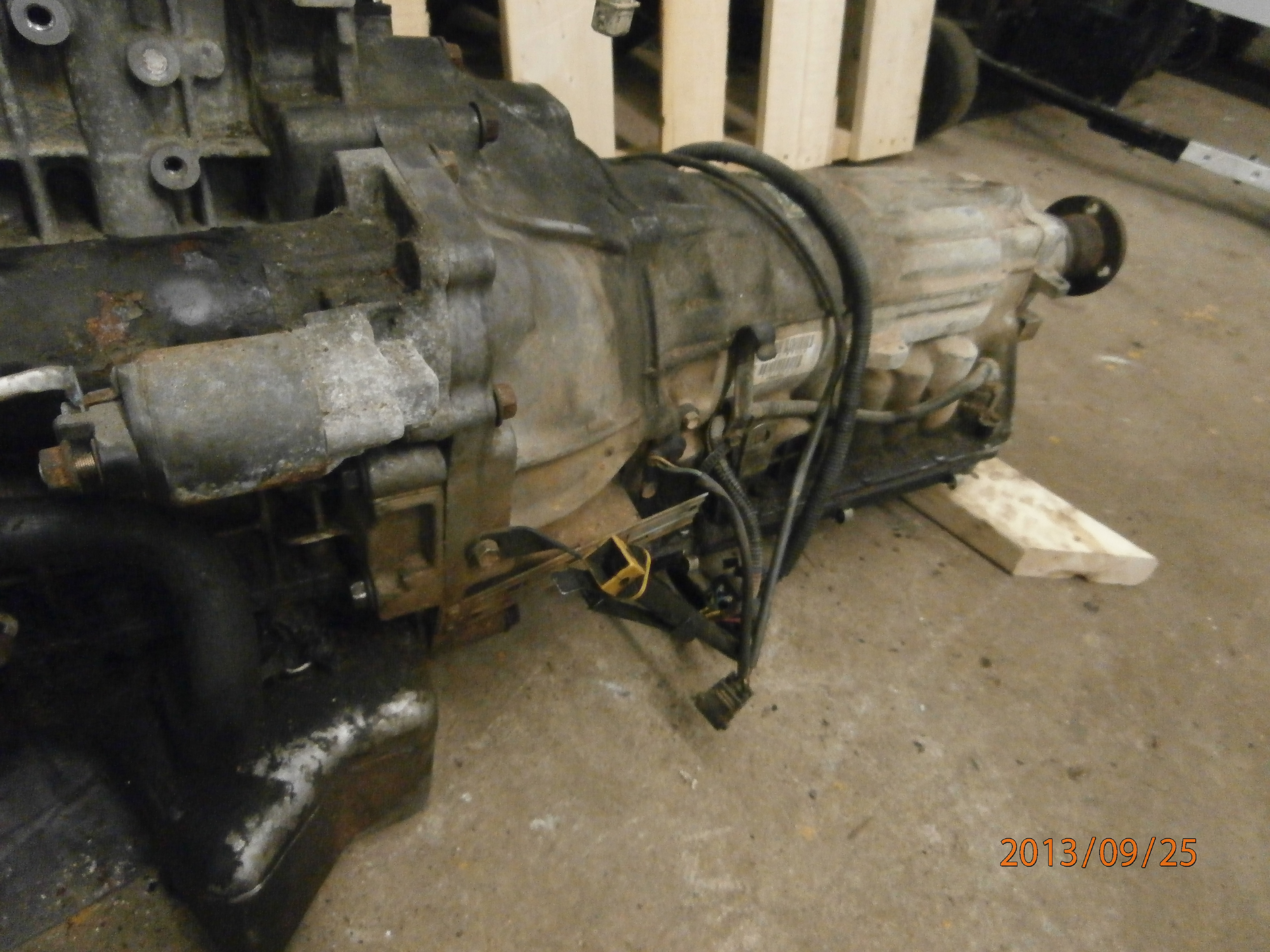

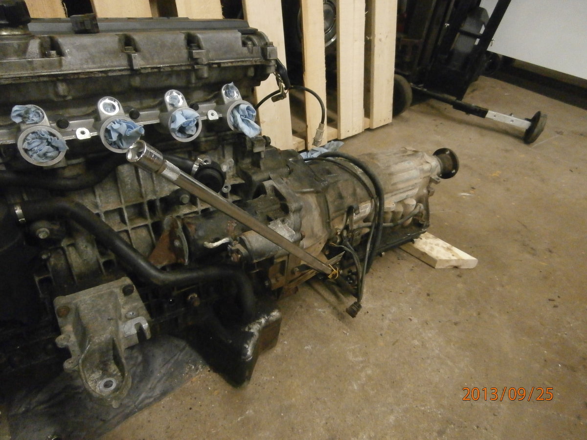

The dipstick for the transmission is on the driver's side, it is very short, you will need a 1/2" drive extension (18" to 24") to get to it, rotate the extension a quarter turn and the stick will be free of the clip. (see attached pictures)
I find that a transmission funnel with the tube works the best as far as topping off the transmission, but I do usually have to put the far end in the tranny tube from under the car. Hopefully this helps with the transmission questions.

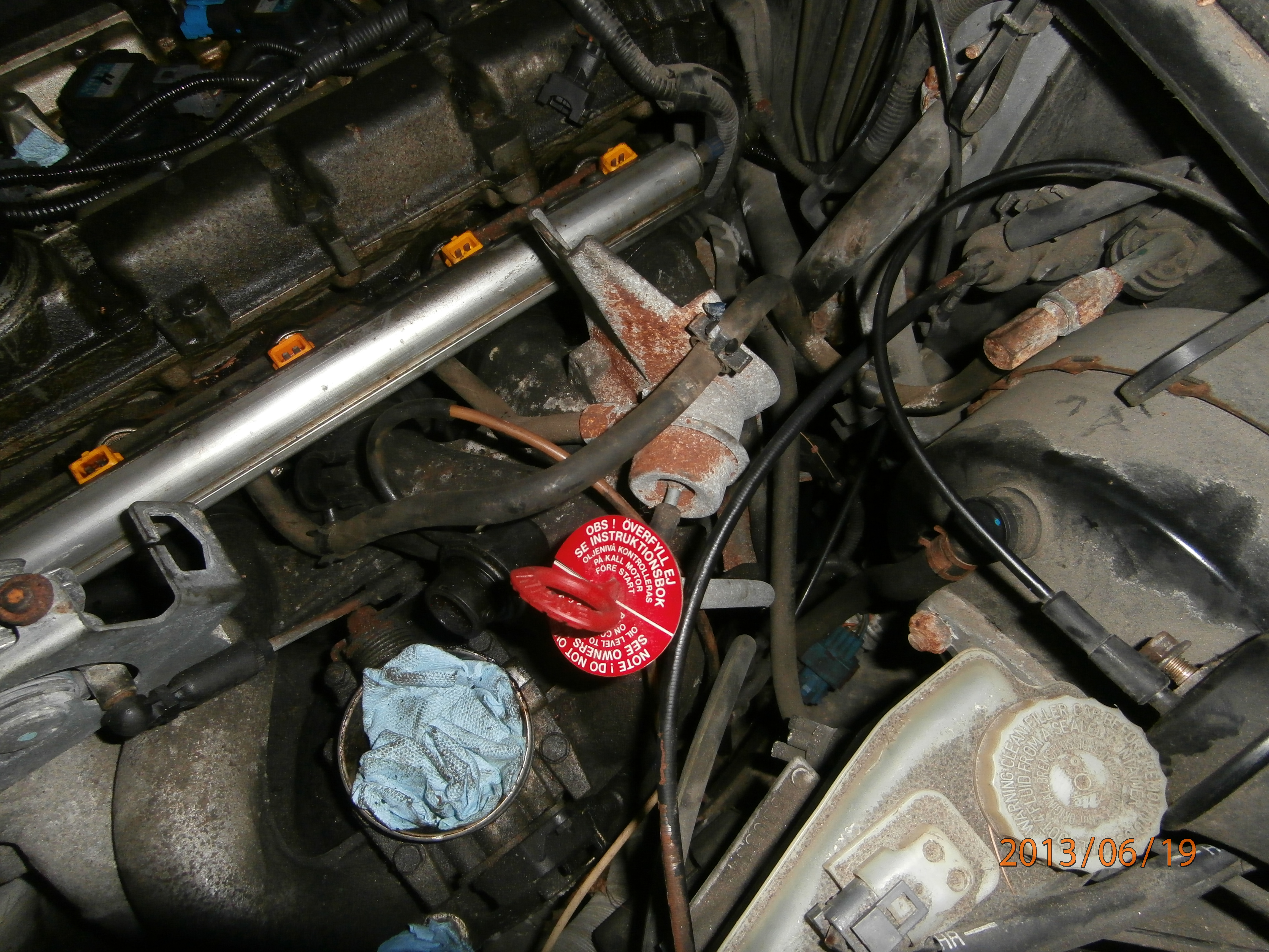

Right, check on the flame trap. There is a lot of discussion on the boards about throwing them out... that the later models don't need them. I would suggest reading through the forums to decide if that is something you want to do or if you just want to clean it. One way to tell if you are having a problem there is to pull the oil dip stick after you have driven home. Watch for gray smoke coming from the tube.

Oh, I don't plan on selling anytime soon but as a single parent these repairs are getting a little spendy, well a lot spendy. So I am guessing a mechanic will know where the flame trap is? I like working on my car when I can but I have seriously never heard of a flame trap. I will pull the dip stick after I get to work this a.m. to see if there is any gray smoke. Thanks for the advice!

The Flame trap is connected to the throttle body intake tube (in picture just to the left of the dip stick)
It is in the black round housing
