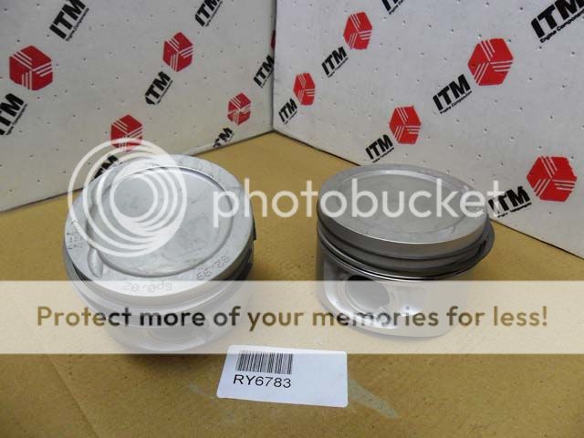

i was under the impression that the pistons have two valve-shaped cutouts by design. here's a picture (from an ebay auction) of a new pair of pistons:
(http://www.ebay.com/itm/150862786378)
i think it would be pretty unlikely for every cylinder's valves to hit the pistons, because interference occurs when camshaft motion stops and crankshaft motion does not. i would expect only the valves that stuck in the "out" position when the cams stopped to make a significant mark.

Yes, the notches are totally normal, they are machined into the pistons. I don't actually see any evidence in the photo of valve-piston contact, except maybe the shiny spots in #3, but that doesn't mean there wasn't any. At any rate, from what you can see right now the top of the pistons are totally fine. That is not a surprise, but still good news.
