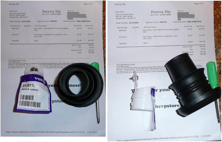

Parts needed:
Gasket PN 6842188: $12.50
One-way Valve PN 9135119: $12.50

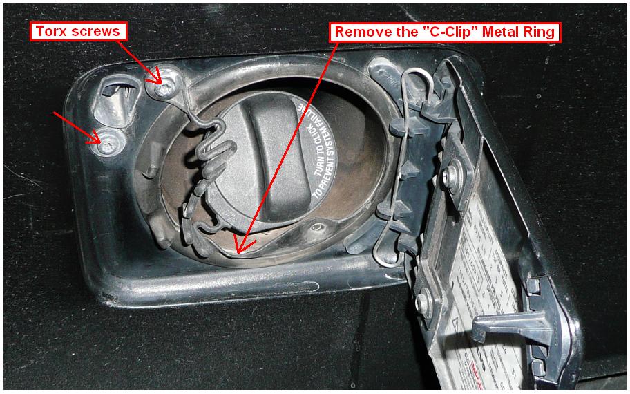

4. Open the gas door, remove the two (2) Torx screws. Look down and you will see the metal ring that keeps the rubber seal in place. This rubber seal is an integral part of the filler tube. Right behind it is another rubber seal that you can simply remove out of the groove.

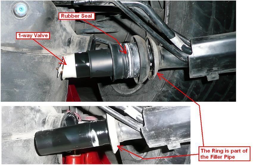

7. In order to d/c the filler pipe from the tank, you need to d/c all 3 fuel hoses as in the photo, there are 3 connections to undo. Note the hose #2 runs under the fuel pump hoses. You need to undo the plastic strap (press it down and slide it out of the slit) to free up the hoses so #2 can slide out.
NOTE: during install, make sure you put this strap back to hold down the fuel hoses.
8. Note the orientation of the 1-way valve. The trick for the rubber seal: apply some fresh oil to ease insertion. Insert the rubber seal into the gas tank first but stop at about 80% in, leaving about 1 inch gap, i.e., don’t fully insert it. Now oil the filler pipe and insert it in.
Note: Don’t install the clamps until the very end, this way you allow the filler pipe to move a bit during installation. In other words, you want to avoid damage to the gas tank neck!
