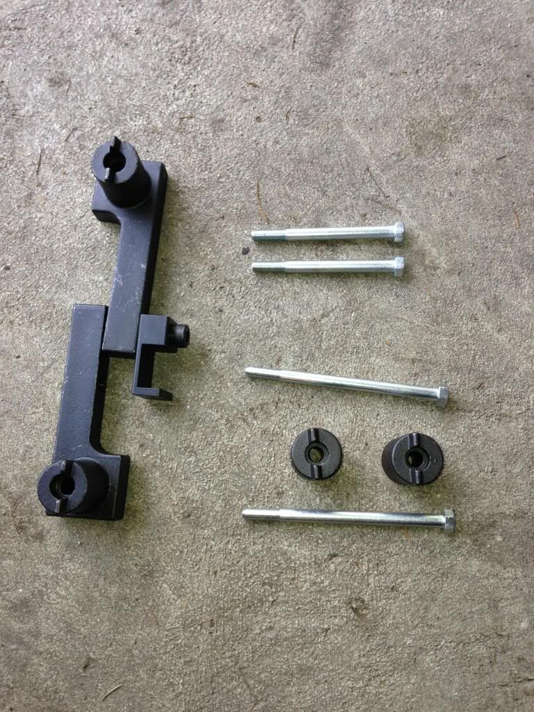

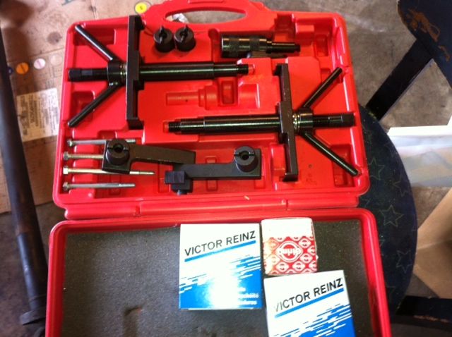

Tools: You will need a special cam stabilizing tool (see picture) to hold the camshafts from the rear in order to remove the timing belt and be sure to not loose position. Image
The Cam stabilizing tool is important when removing the cam sprocket/Pulleys, because they are on tight, and you don't want to jar or jimmy rig them as you remove them. Image

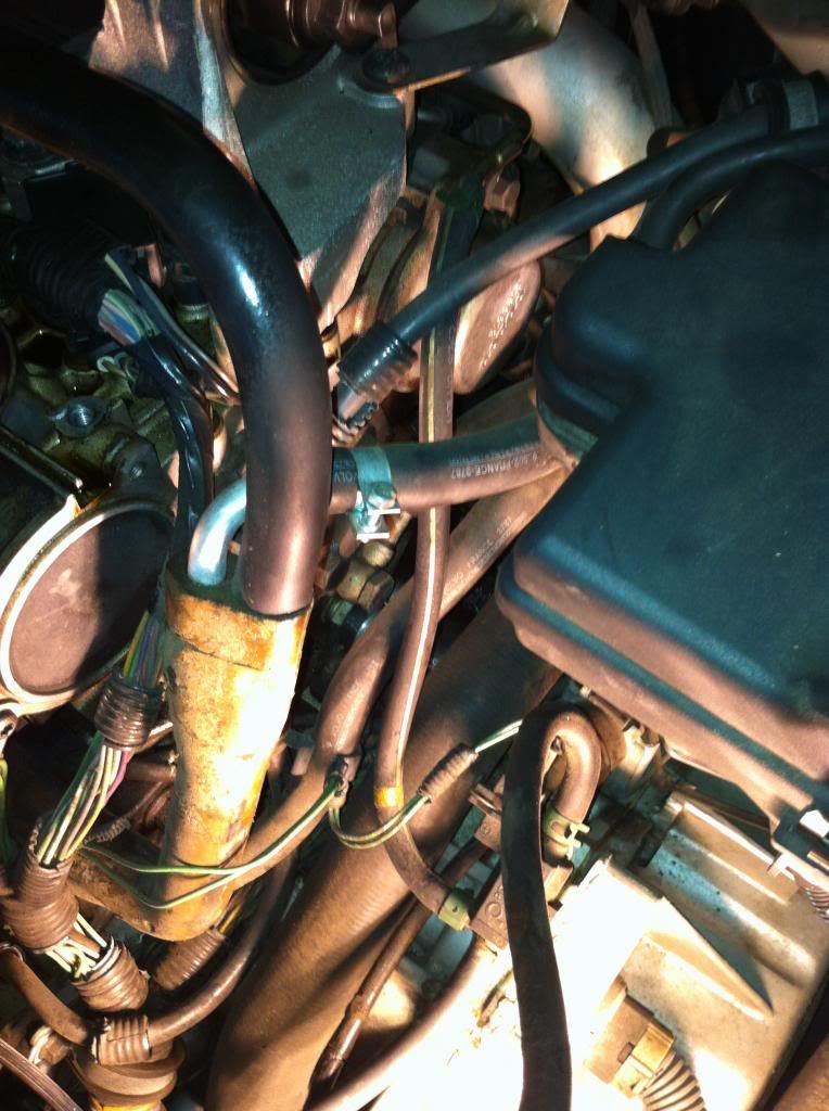

Take pictures of the air lines and electrical lines going around this side of the engine (driver’s side) and disconnect the air line going by the rear cam cover closest to the cabin. There are a few bolts that hold up the electrical routes going around the engine. Be sure to note these and remove these bolts in order to free up the electrical and all the PCV air lines that you will need to move out of the way, and/or inspect or replace.

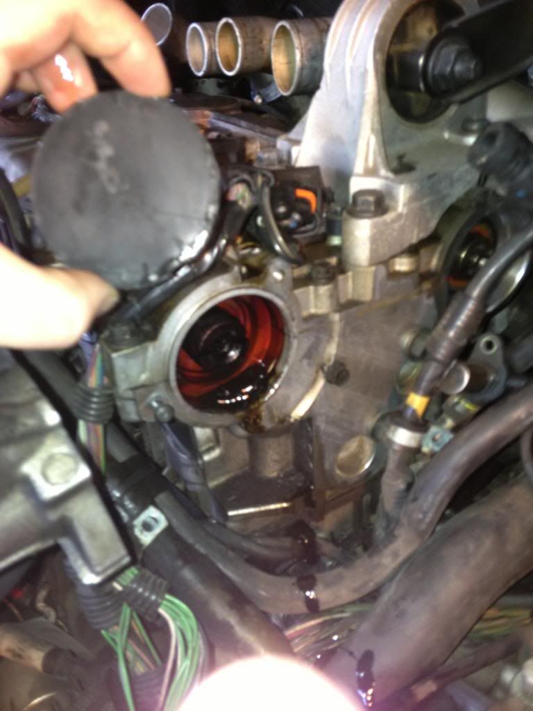

Front Cam Cover Removal/Cam Bore (toward front of vehicle, engine rear: driver’s side):

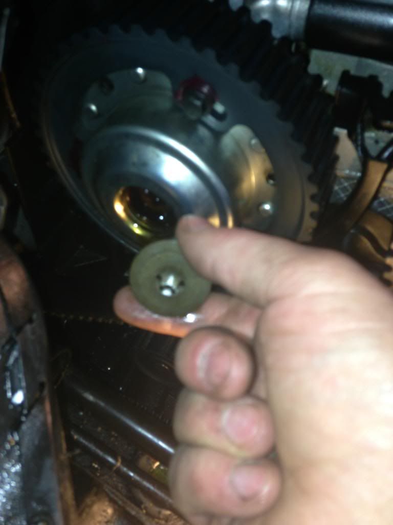

This second forward cam seal just looks like a plastic plug, but its actually a rubberized plastic with a metal structure. Its mostly metal, and mine wasn’t easy to get out. It wasn’t hard, but I had to really pry it, and I scarred the surrounding metal a bit, ruined the plug/bore, and had to buy a replacement. I doubt many people will be able to pry this out without some damage to it. So be prepared to buy a new one. I bought mine at the dealer for $14.10 after tax, which was about the same as eBay. This bore plug is all that’s in front of the cam on this side, so once this one is out, you’ll almost be ready to attach the cam stabilizing tool. (see photo) Image

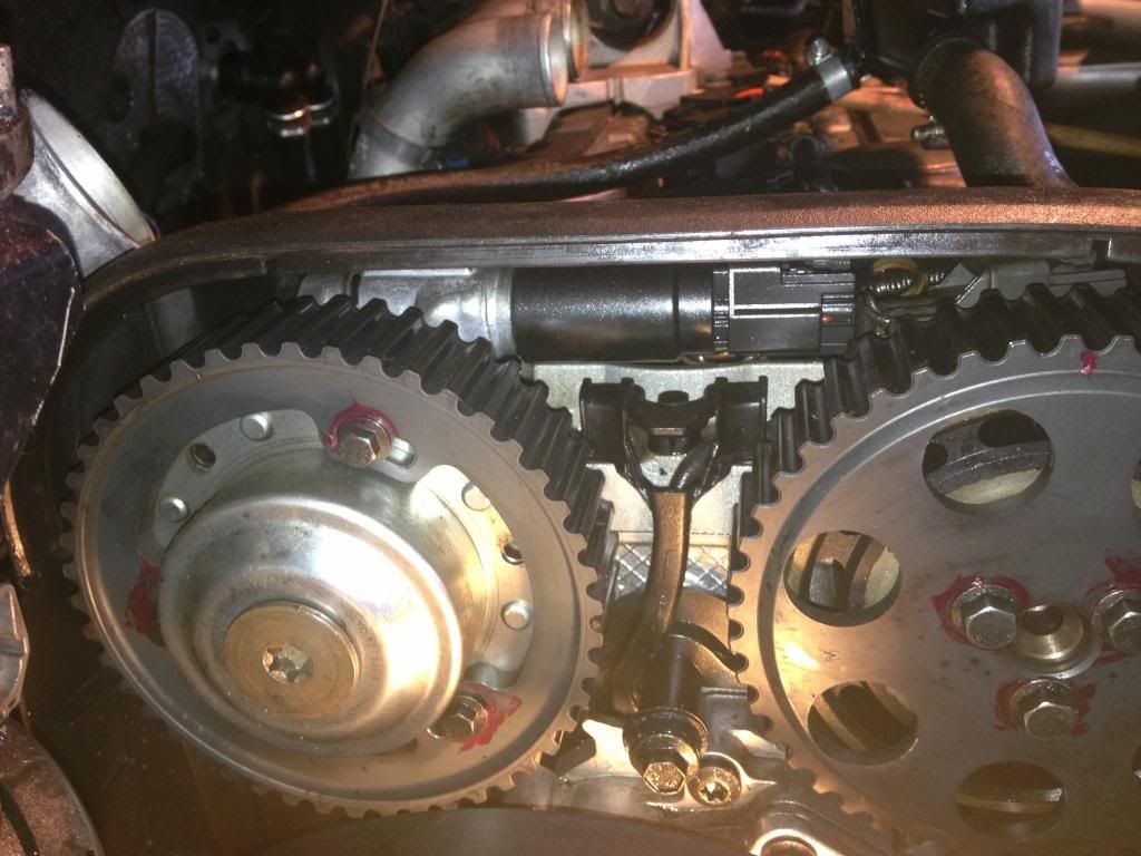

You’ll need to get your engine cranked over to line up with the timing marks on your cam sprokets and timing cover so that your cams notches (on the back side) are aligned parallel.
Before attaching your cam tool, go to front side of engine, and with the timing cover off, look at the cam sprockets and notice the little marked lines on each sproket/pulley. Crank the engine until the cam marks are pointing upwards together(note: crank CLOCKWISE and ONLY CLOCKWISE with this engine! A little back is okay, but generally since this is an interference engine the official warning is DO NOT crank this engine backwards or counter clockwise at all.) Place the top timing cover back on (if you removed it) because the top timing cover has marks on it also, and you’ll want to align the cam marks to the timing cover marks (see photo). Image

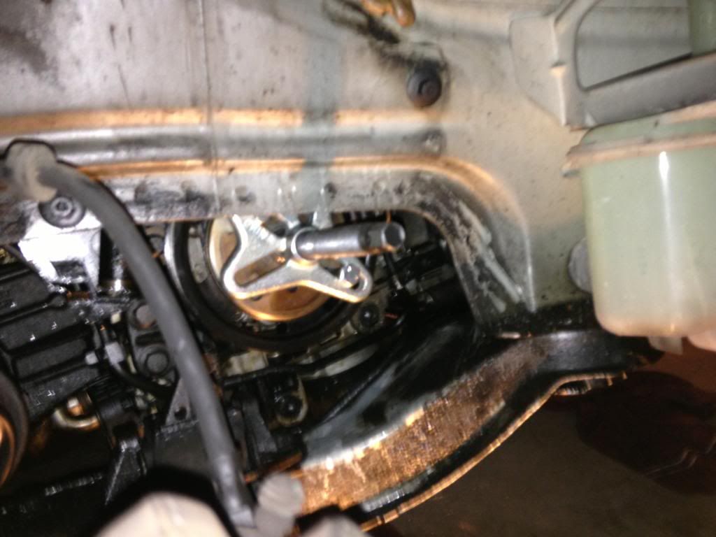

The Crank Pulley also has an alignment guide but its not on the pully itself; this guiding part is just above the crank pully. The crank pulley itself has a “line” that alignes to this crank guide line, but its not terribly obvious (see photo). I marked the actual pully to the mark just to be sure, and then I marked the timing belt underneath the pulley with red paint and on both side of the pulley lips, so that when I put in the new belt with the same marks I could be sure it was in the exact same place. Make sure this crank position is aligned as well as the cam marks. Because the crank and cams spin a 1 to 2 ratio to each other. Once these are aligned and the timing belt is painted up, continue to attach the cam stabilizing tool. Image
Attatch cam stabilizing tool. I had to add a couple washers to each side because the bolts that came with my kit were a bit too long. The alan key bolt in the center of the tool is useful because it allows the tools to bow slightly, as your cams can be tuned in a certain way so that they are not absolutely evenly aligned. Do not worry if your cams notches aren’t exactly straight across. Mine weren’t. That’s what the middle bolt in this tool is good for. Loosen the tool’s middle bolt so that the two sides of this tool is a bit floppy; slide the tool notches into the cam notches, and let the tool bow. Tighten the bolts with the tool into the cams; then tighten the tool’s center bolt to completely stabilize the tool and cams as they sit. Image

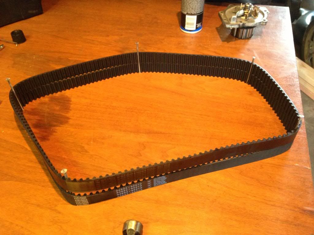

After all this, you are free to remove the old timing belt. However, this engine’s set up isn’t the most straight forward at all, and I suggest you mark the timing belt and sprocket/pulleys with paint. When I bought a new belt for this 99’ S80 T6 it DID NOT COME PRE-MARKED as some vehicles do. I was sure to mark the old belt, keep it in tact (so no cutting) and then match up the new belt and mark the new belt the exact same. (see photo) Image
Marking the new belt made installation easier. I’m not sure how you’d do it otherwise honestly.

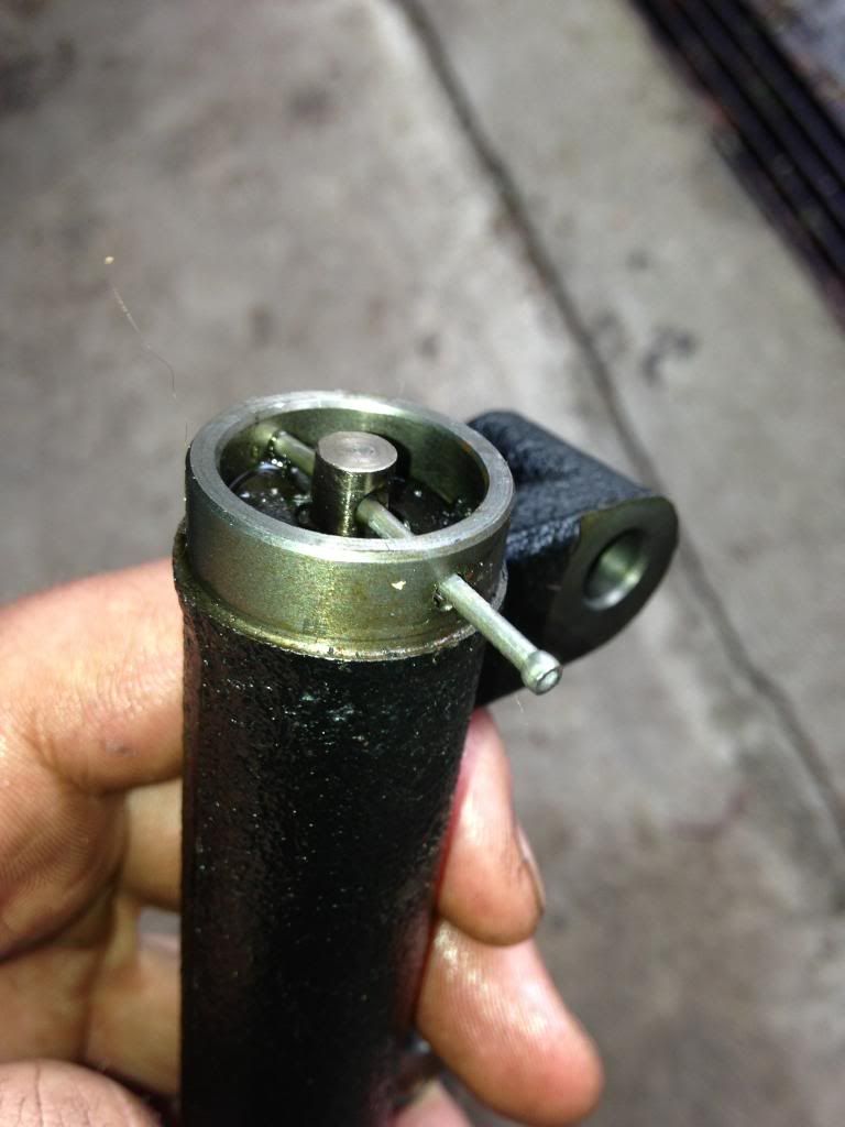

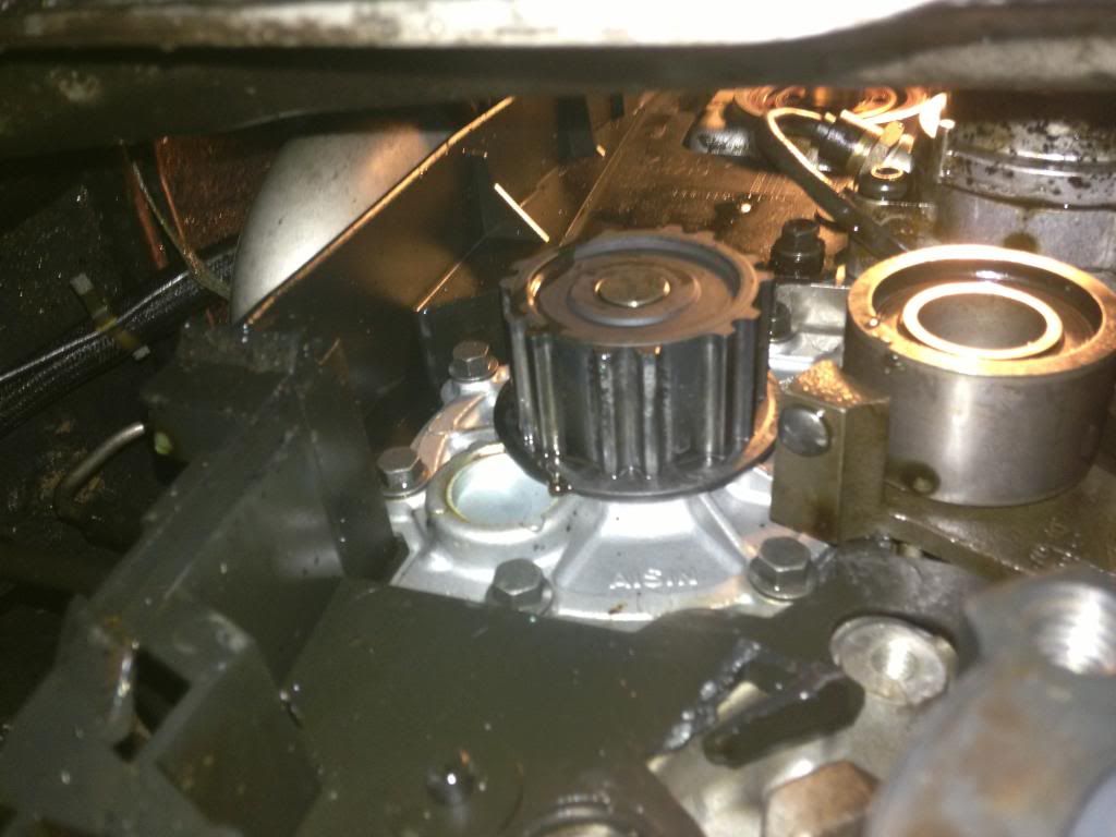

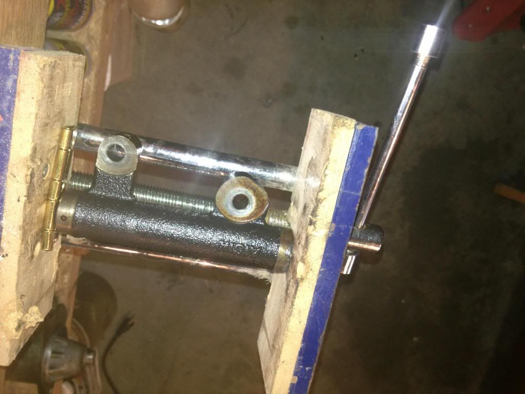

I loosened the bolts on the tensioner to start the removal of the timing belt. Since it’s a hydralic tensioner removal was easy and slow. Tension would just slowly release, and by the time I got both bolts loose and out, the tension was fully erect and the item just came right down and out. By the way, I added a couple pictures here about how to re-use the tensioner so you don’t have to waste your money on a costly Timing Kit, or a single tensioner for $60+ if you can even find one solo. Image
All I did to re-use the tensioner was to set the tensioner into a bench press with a piece of metal on the tensioner-ram side, so that as you tightened the bench press (slowly, giving time between cranks for the tensioner-ram to go back into its turtle shell)… eventually you will be able to recompress the ram and have the ability to slide a pin back into the holes (as you can see in my photo I used a finish nail.) Image
Once you have the tensioner removed, you will be able to easily remove the timing belt. Be sure not to move the crank pulley (which isn’t hard, is pretty solid without wrenching it).

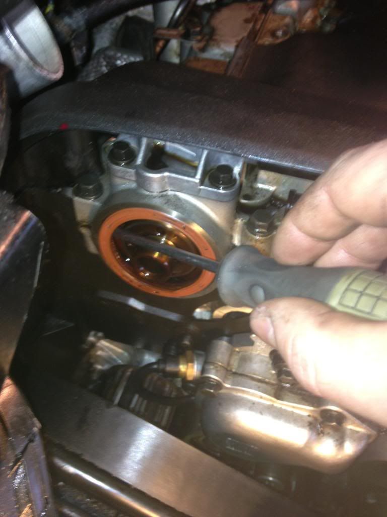

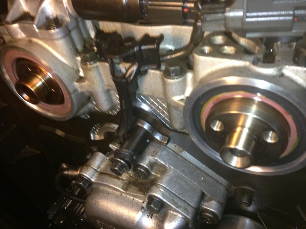

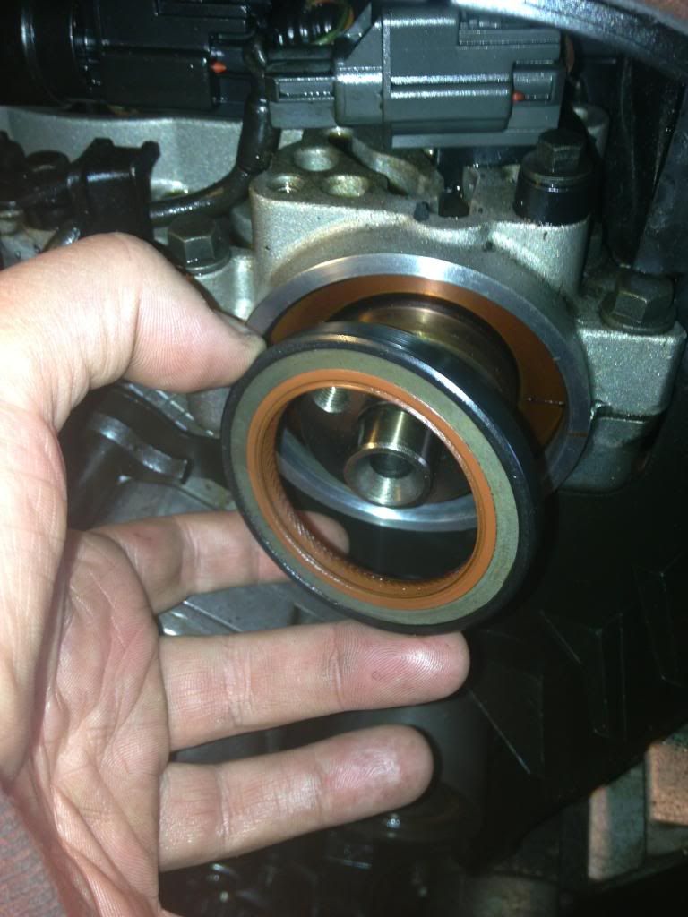

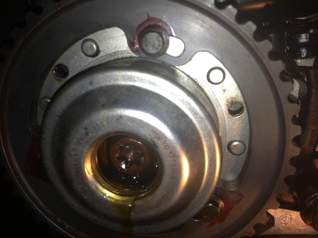

Once you have these two Cam Sprocket/Pulleys off, you can easily see the Cam Seals, and if you had this oil leak problem as mentioned by the symptoms, you should see both Cam Seals already popping out of their positions. Mine were almost falling out. Image
It was therefore very easy to pry them out with a screwdriver, but I didn’t pry at all. It was more like a simple jostle and they slid right off. Image

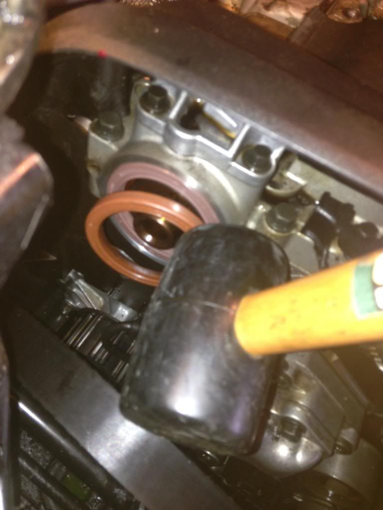

Installing new cam seals: Tap in seals gently and evenly. (See Photos)
Instead of finding something to match the cam seal size (as suggested on most repair instructions), I used the old seals right on top of the new seals, and tapped them in this way. This process can be slow going in order to tap them in evenly, but well worth it. You want your new seals to sit comfortably for a long life! At this point you can inspect your old seals. If for some reason you know that your problem is strictly a PCV issue and your seals are still good, one way to tell is that the seals should have a substantial ribbing around the edge, like a belt, and when the seals get old, those ribbed lines will wear down and flatten. Seals are only like $10 each online so I recommend if you’ve come this far, replace them. Lightly coated gear oil around the edges is a good prep to sliding them in. In a normally ventilated engine with a good PCV system, the normal pressure and function of your camshafts will never blow out a seal. In the worst a seal with only slowly leak a dribble of oil if its old. Image
Once your cam seals are installed, now is a good time to change the water pump, or even re-seal and inspect a water pump that’s at half life. (see photo) the water pump has a pulley in the timing belt system, and is directly under the cabin side camshaft. A few bolts removed and some fresh gasket seal goop is worthy of the extra time to invest. Image
Now is also a good time to inspect the crankshaft seal. I removed my crankshaft pulley with a bolt/balancer puller kit. Once the pulley front is off you can peer behind the sprocket to see the seal. Mine was good so I left it as it was. Image

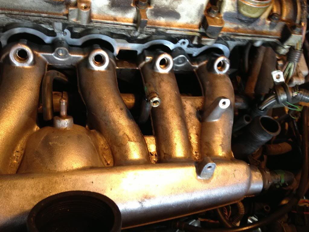

Turned out that whomever took apart the engine parts near the front (namely, the intake manifold and all the PCV hoses) they didn’t put it back together right. Two of the main PCV lines coming from the breather box, to the manifold and around to the crankcase on the driver’s side, had been switched. One was where the other was supposed to be.
I’m writing about the details of the PCV and oil trap/breather box because according to many posts and forums, these oil traps get clogged, and other parts of this system need replacing. So I think it sworth covering in detail here, because the disassembly and installation is not obvious and straightforward, from fragile lines, expensive replacement parts, and upside down bolts in weird configurations; you deserve a review here before you jump in there.

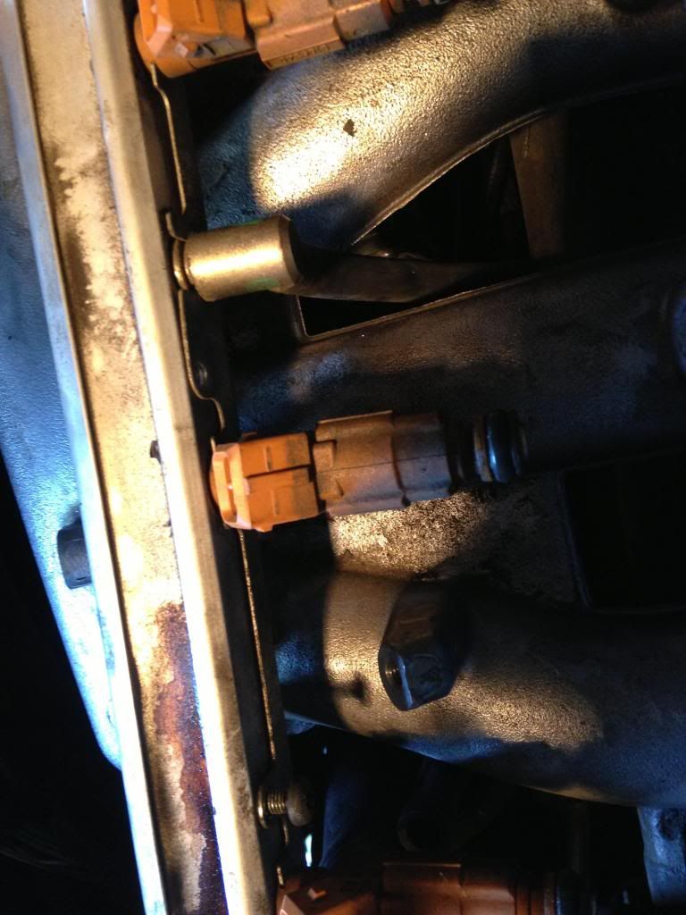

Remove fuel rail cover plate (2x 10mm bolts). Detach electronic plugs connected to fuel injectors and bag the metal clips for safe keeping. Unscrew little fuel rail pressure cap and use screwdriver and small cup to release fuel pressure (if any, as there wasn’t much on mine so don’t be alarmed.) Remove fuel rail to manifold screws (2) and pull injectors with rail up and out of injector holes in manifold. Image
Next you will have to unscrew the screws holding the injectors stable, but also to get the fuel line out of the rail. Once you have this secondary rail brace slid down and unscrewed you can pop out the main fuel line from the rail, and set the rail aside. Image

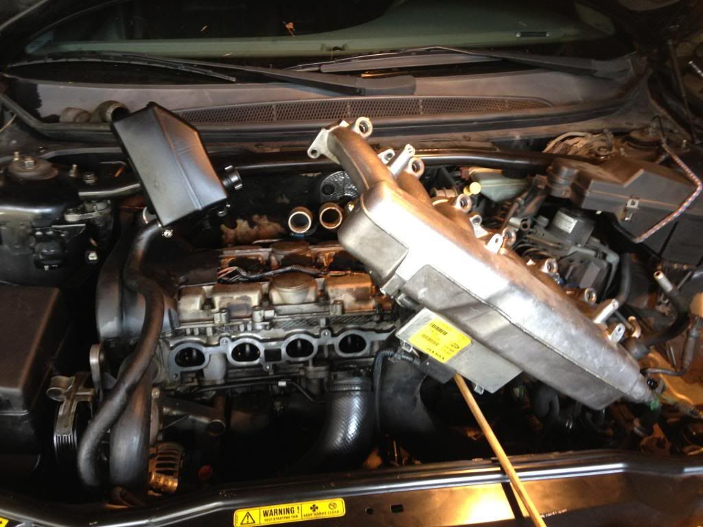

With the fuel rail set aside you can start to inspect removal of the intake manifold. Image
Removing the Intake Manifold:
Accessing and locating the Intake Manifold Bolts is faily straightforward, as these are 10mm bolts, easily seen. The two on the bottom in the middle are “guide bolts” and can be loosened only half way, as the manifold just sits on them; They aren’t in full holes. The manifold bolt on the left side of the intake manifold is the trickiest, because it’s a very tight space, and at a slight angle from your access. You may want a toggle end and an extension, as small as possible.
But before you remove the Intake Manifold you need to unscrew multiple connecting hoses and the oil dipstick. The oil dipstick is attach to the Intake Manifold on the forward left. Its an upside down bolt. You can find it easily. It’s a 12mm. Image
The breather box/oil trap upper hose is connected to the PCV line which is bolted to the underbelly of the Intake Manifold. WARNING, if you don’t remove this breather box clamp you can easily break the PCV hose which alone costs $200+… so remove the breather box hose clamp with care first! Note: this is the hardest part to get to. You’ll most likely have to remove and install this clamp with a ¼” socket and swivel head on an extension. But depending upon who installed it last, and how its positioned, it can be tricky. I broke my PCV hose getting this out, and I don’t want this to happen to you. Be sure you remove the oil trap/breather box top hose clamp first, then lift the manifold up.
Once the manifold is lifted up (see photo) you can remove the PCV hose assembly. I propped by Manifold up with a piece of bamboo. You can let it sit propped up like this for the rest of the inspection/repair. Image

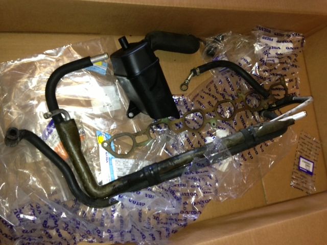

I installed a whole new PCV system, so I’ll take you through that process here.
The bolt that holds the PCV hose assembly to the Manifold underbelly is 17mm, and is a hollowed bolt with a passageway. The passageway hole should line up with the air line pathway on re-installation, so pay attention to how this bolt is when you start to remove it. This may be where a problem exists. I found a bunch of oil backed up at this section, because the previous mechanic installed it wrong. Be sure there is a washer on each side of the bolt and not two on one side. Image
Once you remove the one side of the PCV assembly hoses, follow the lines around to the other side of the engine. One of the three lines went to the turbo assembly up top and will already be floating free. But the other two are connected. One is connected to the driver’s side of engine below and between the rear cam covers. My lines were switched (I don’t know what fool did that last assembly) but if you buy a new kit, you’ll see that one line has a rounded head, where another hollowed bolt and washers is to go. The other hose attaches to a metal welded line that pops off another line that goes around the back of the engine and up to feed the turbo system I believe. That line just attached like a regular air hose with a metal ring clamp.
After removing all lines on the PCV Hose assembly, you can pull that out from under the Intake Manifold and out of the way.

This completes the PCV system inspection. I recommend installing a new PCV system if you’re unsure about any portion of this system. My system was good, but I had to replace the whole kit because I broke pieces taking it out. My problem was that it had been installed wrong. So take note of that if you bring your car home from a shop and all of a sudden you have a major oil leak! Hmmm. The important things to note are condition of breather box buildup/air flow, the hollow bolts and proper washer placement, and correct installation of each hose to its proper location.
