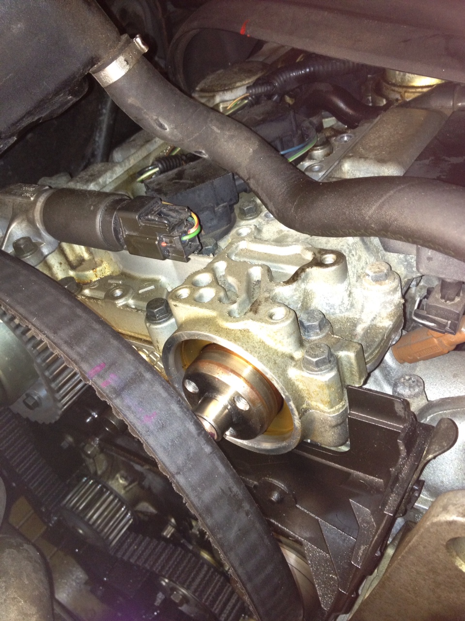

I took the last couple hours to try and clean up pretty thoroughly. When finished I put a couple quarts of oil in and started the car up. It took awhile for anything to happen, but I found the leak. It appears to be coming from the camshaft closest to the front of the car. I can't see the leak, but that is definitely where the river of oil is starting. No real sign of oil on the belt or sprockets, but it's leaking from there straight down the block behind the plastic cover, so this is why I couldn't tell it was coming from above. There is oil around here, but I couldn't rule out it getting slung up there because the drive shaft was slinging oil everywhere.
This is how it looked when before cleaning and before I added oil and ran it again.
And this is after I ran it. You can see a trail of oil, which must have disappeared while it sat for so long.
I will now research how to replace the seal here and hope it isn't too complicated. I'm a little intimidated by the timing aspect.
Thank you for the comments.
Not sure why I can not edit this post again, but I did find a resolution to the oil leak. I pulled the seal that Volvo had given me and it turns out it was the wrong one. It did not look significantly different in size, but it was the one for the VVT side, not the other side. I replaced the seal, but I now have another issue with the CEL.

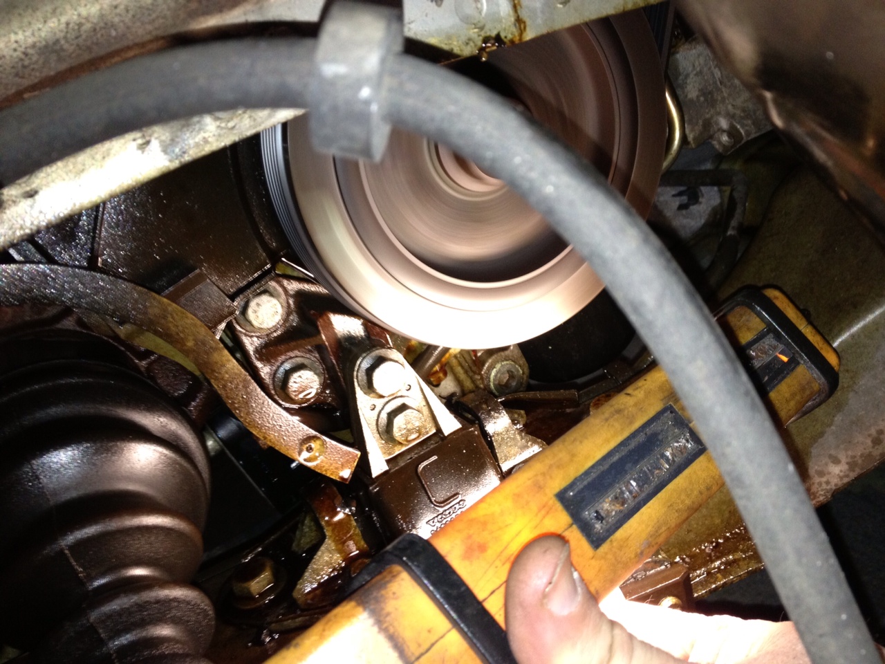

Towed it home (AAA) and I was 100% sure it was the from crank seal since there was no oil on the timing belt and it was pouring like pancake syrup at IHOP right under the serpentine pulley and I had oil even out in the wheel coating the inside of the rim. This morning I went to my local Volvo dealer and he was suspicious since he had worked there for 20 years and never seen a crankshaft seal blow. He advised that i might have a crank case pressure issue so I picked up a new trap and some of the hoses with the crank seal. Anyway, when I started to take the covers off I thought I would double check it after I saw more oil on the side of the engine and then I found that the front camshaft seal had completely worked it self out but the oil magically followed the casting to make it in behind the cover and appear again at the lower part of the engine.
You can see the stream right in front of the engine mount. The car is lifted a little bit in the front, about 1-2 inch of air under the wheels.
I thought I post it to help other people avoid the same miss diagnosis.

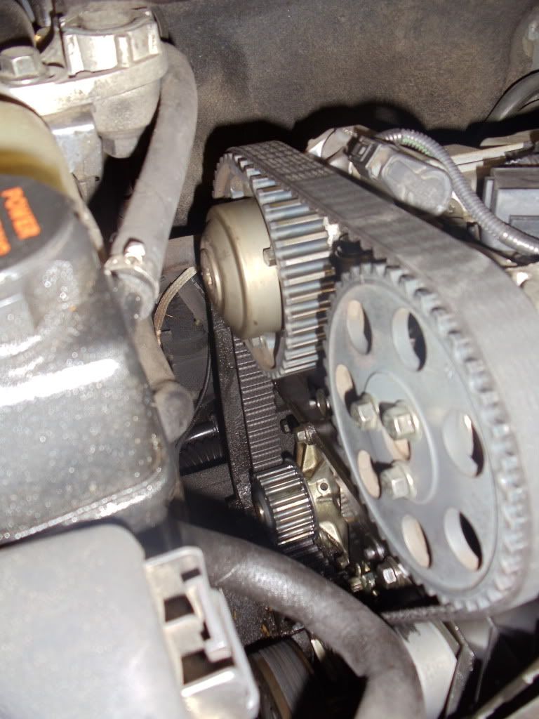

Talk about reinventing... I went to Volvo, the guy asked if I had variable valve timing on is so I said yes (there is VVT on the exhaust side) and like Joe, I got the wrong seal.. Luckily for me I noted it before I installed it and thanks to the great guys at Gengras Volvo here in East Hartford, CT I was able to change it that same evening (The service manager answered the phone after they closed and found me the right seal so I could swap it). There are apparently models with VVT on intake also. If your car looks like the ones pictured here you need the 9440651 model seal.
