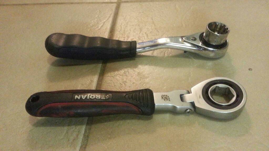

There are plenty of low profile spanners out there that allow access to the 2 17mm control arm bolts near the engine/transmission. Here's a photo of 2 different types I have.
I use a large pipe over them to loosen and tighten the control arm bolts.
- uploadfromtaptalk1389089654367.jpg (63.84 KiB) Viewed 1198 times
