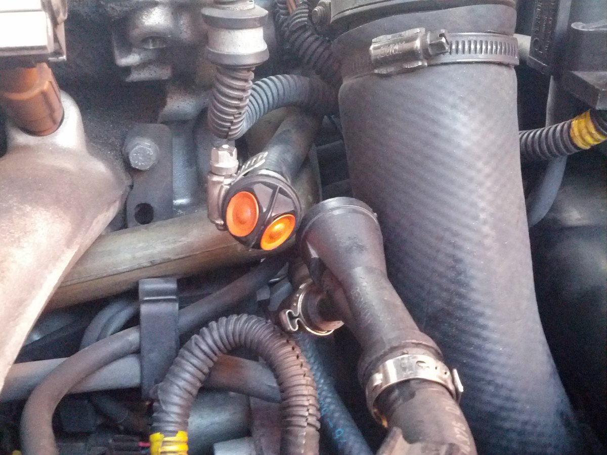

While attempting to suck the seafoam through the brake booster line instead of successfully removing the vacuum line, I believe I broke the plastic "y" adapter pictured here:
I am able to push the two halves together though and everything works fine, even still, I would like to replace the component. If someone could point me in the right direction that would be great, I have had no success finding the part listed anywhere.

The part you broke is called an injector. I broke one on a 2000 S70 GLT SE. For that car it was
part# 8677893, $50.00 at the dealer. I tried a quick search of online parts suppliers and got a hit at
turnervolvoparts
http://www.turnervolvoparts.com/parts/i ... eid=215507
I think it's a sort of venturi that increases vacuum; my 2002 BMW 525 uses the same part and calls it a "sucking jet pump". You'll likely have a vacuum leak unless you replace it or can solvent weld it back together.
