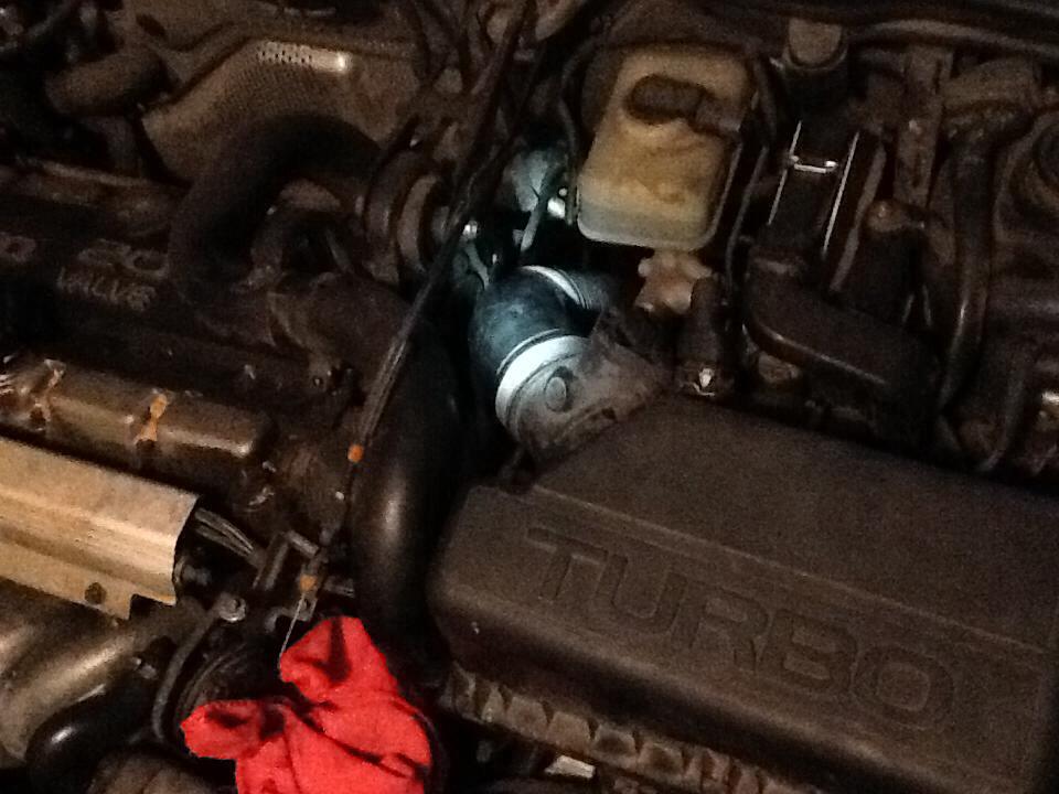

I have a difficulty in taking fresh air hose, I believe is what it is called (Attached picture here), off of top of air cleaner. I have loosed the clamp and I can twist it around freely but I can not take it off. How do I go about taking it off? I need to take it off to get access to gear position sensor underneath.
Thanks
Jesse
1994 850 Turbo Air Cleaner
- Hose at back of cleaner
- 1911830_10152180471708796_1175797178_n.jpg (79.06 KiB) Viewed 1064 times

It pulls off but it can be stubborn. If it is cold where you are working it can help to use a hair drier to heat the joint up and make the plastic a bit more pliable. Try to keep the heat away from the MAF sensor.

I'd second Lee's answer about heating the hoses - I had one I just could not get off at all and yet after a longish drive it came off without the slightest problem!

Thank you every one. Lee, hair dryer trick worked. Yay!
