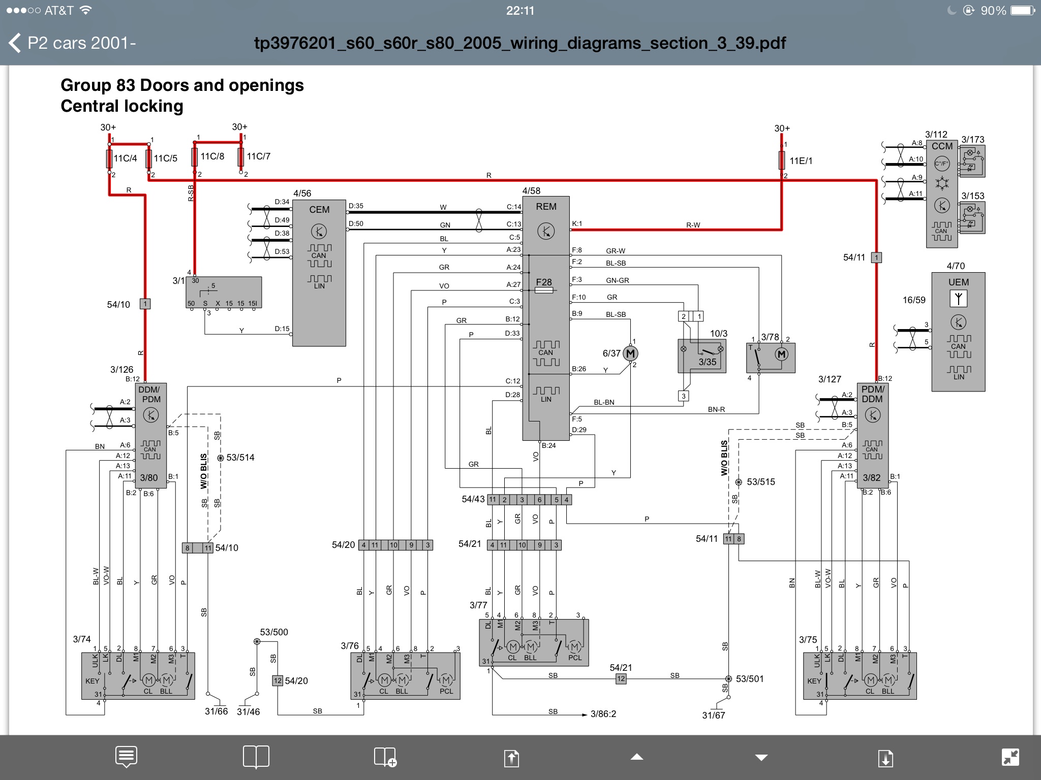

Hello all. I am puzzled. The trunk latch above the license plate does not work. I hit the trunk release button on the FOB twice and the trunk releases...so that works. Now the puzzling part. When I open my driver's door, the trunk releases. I would then have to close the trunk. Also, occassionally the trunk will release will driving. Seems like an wiring issue. Any advice on where to start? Thanks.

You're probably not going to like this, but I'm suspecting an internal fault in the REM. Inspect wiring harnesses in the vicinity of the REM for broken insulation, but if you don't find any, and manually shorting pins F:3 and F:5 doesn't release the trunk, the REM is probably the culprit. I've attached the central locking wiring diagram.
