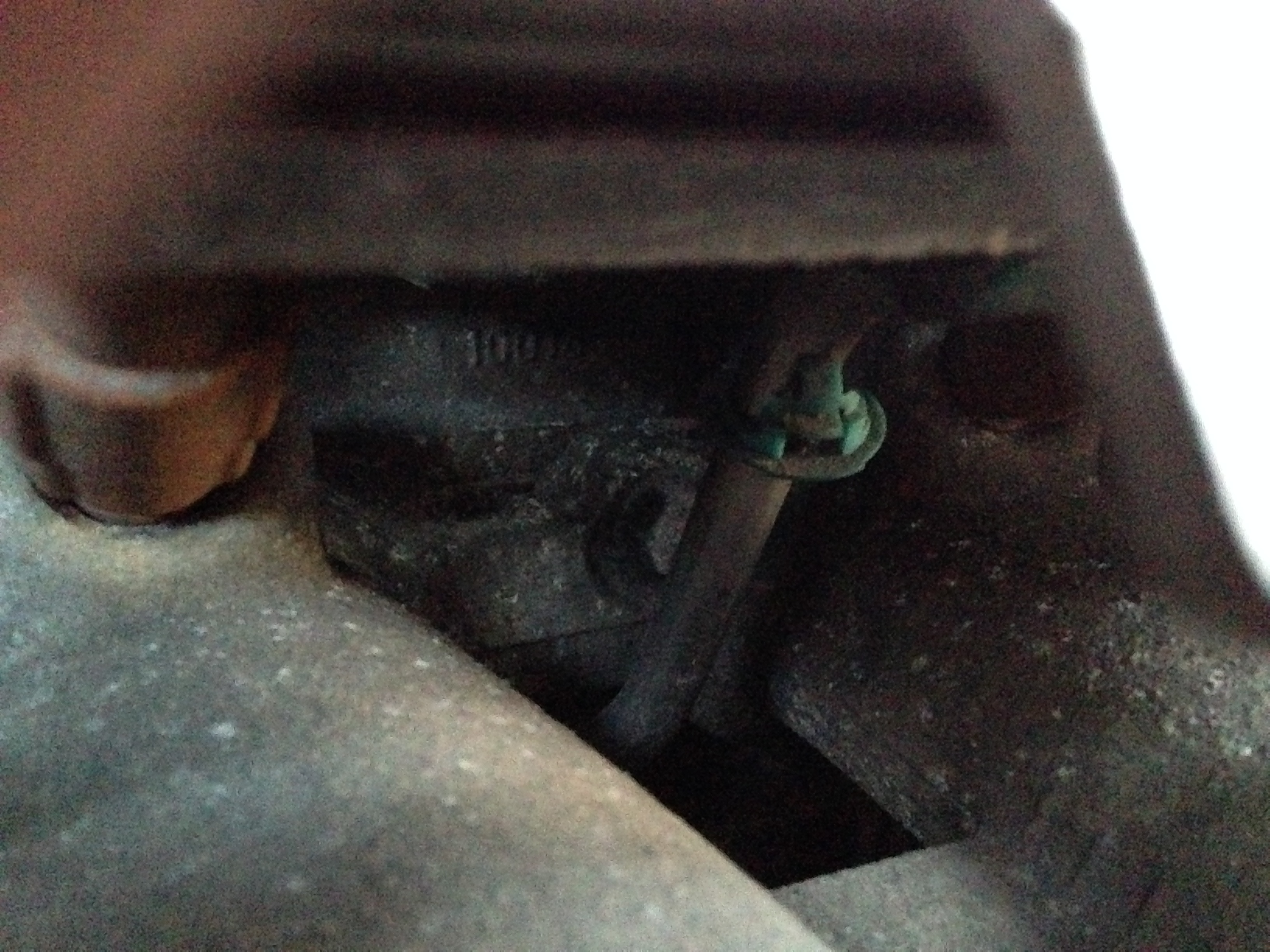

I would look at the fuel rail, pay particular attention to the connection on the fuel rail. It can be that the pipe connecting to the fuel rail has a loose clamp or the pipe itself has become worn and brittle and no longer keeps a good seal. If you are standing in front of the car, facing it, the pipe will be on your left hand side.
Here is picture where you can look and compare. The 1st picture is of the shradder valve, i have never seen it leak …but there is always a first time.
and there is this post as well:
http://volvoforums.com/forum/volvo-xc90 ... c90-37674/
